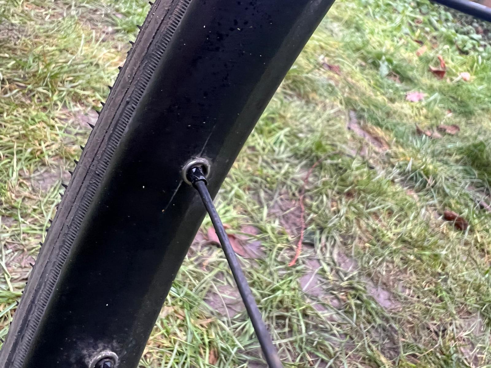

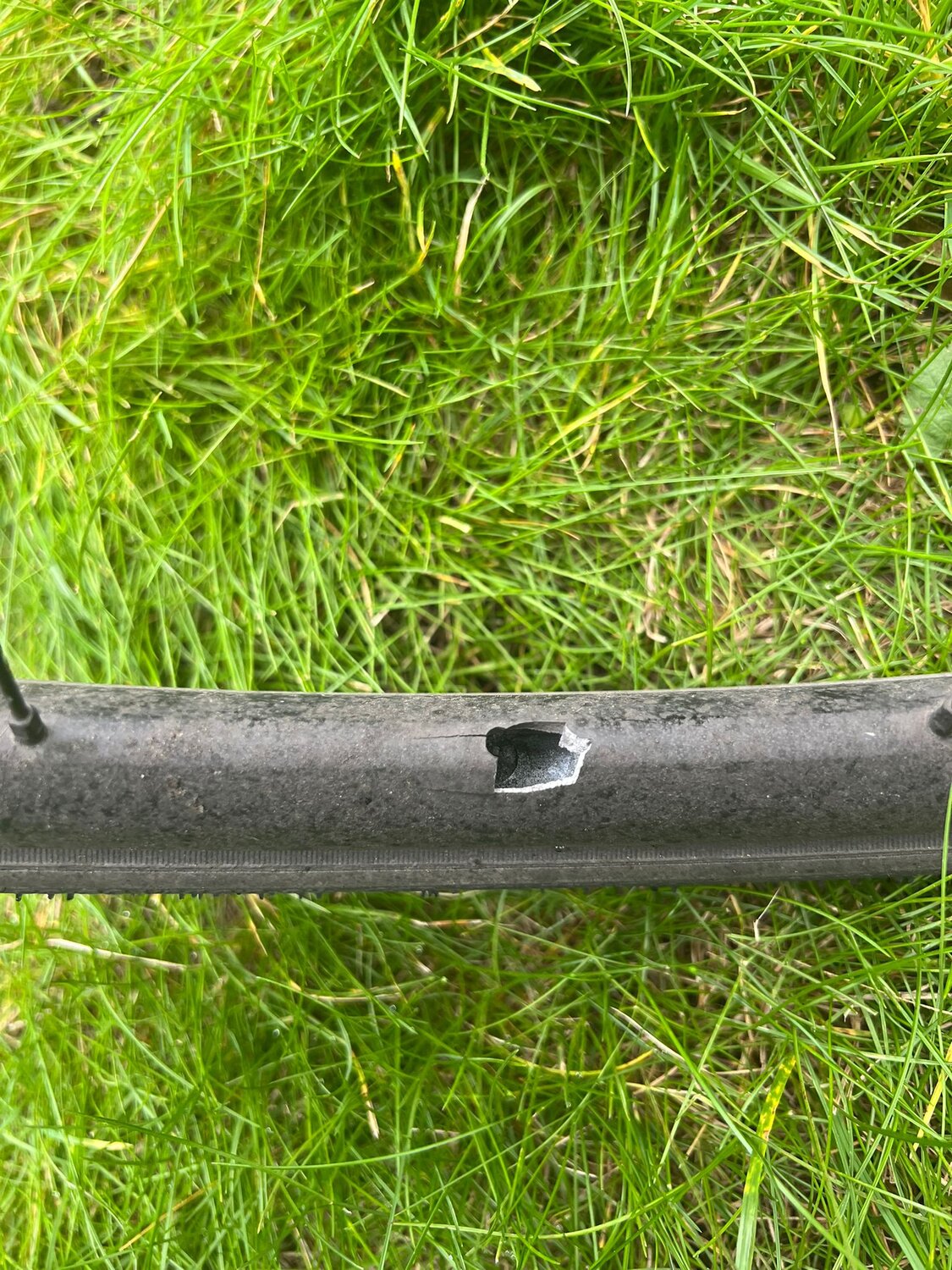

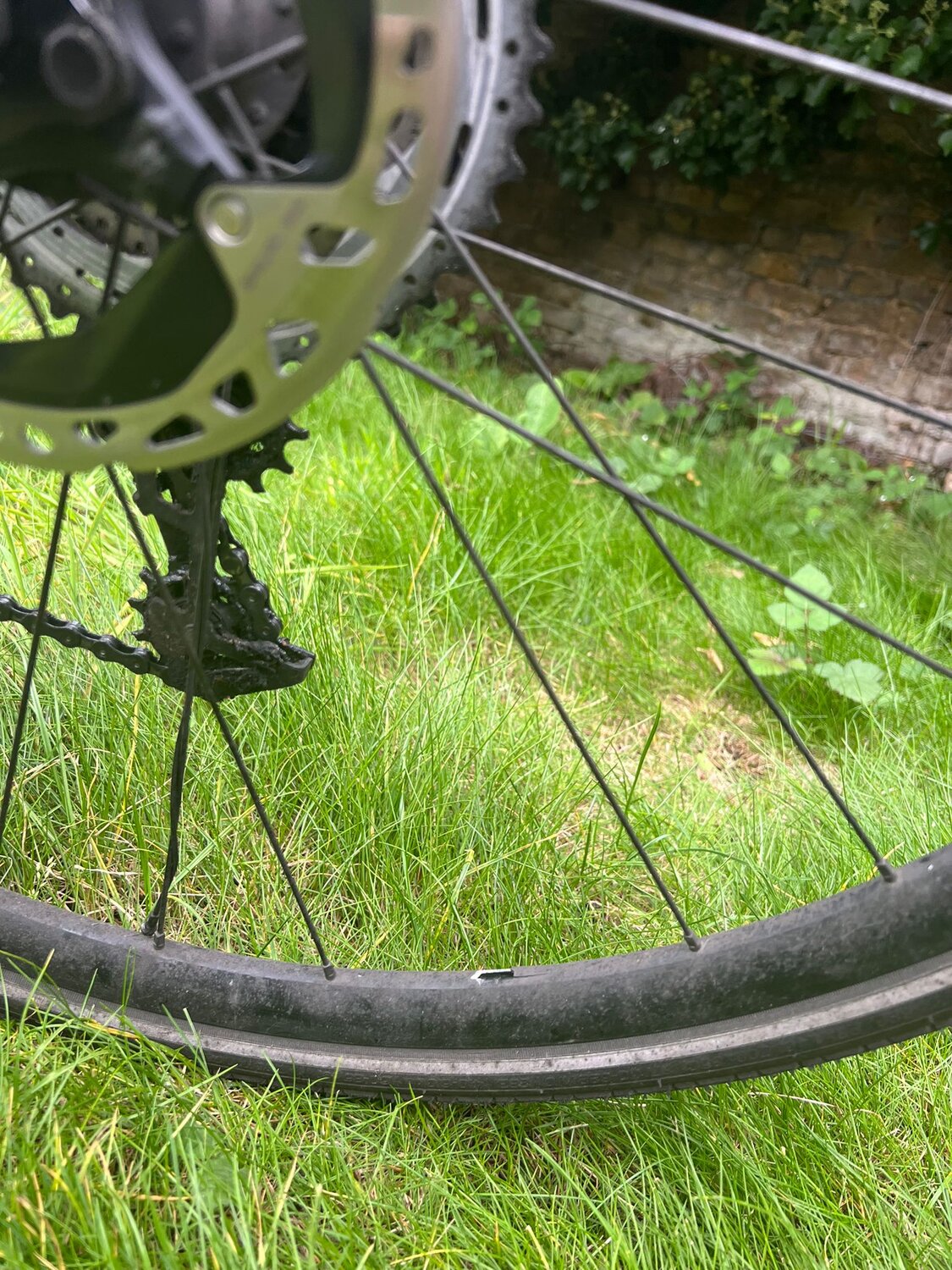

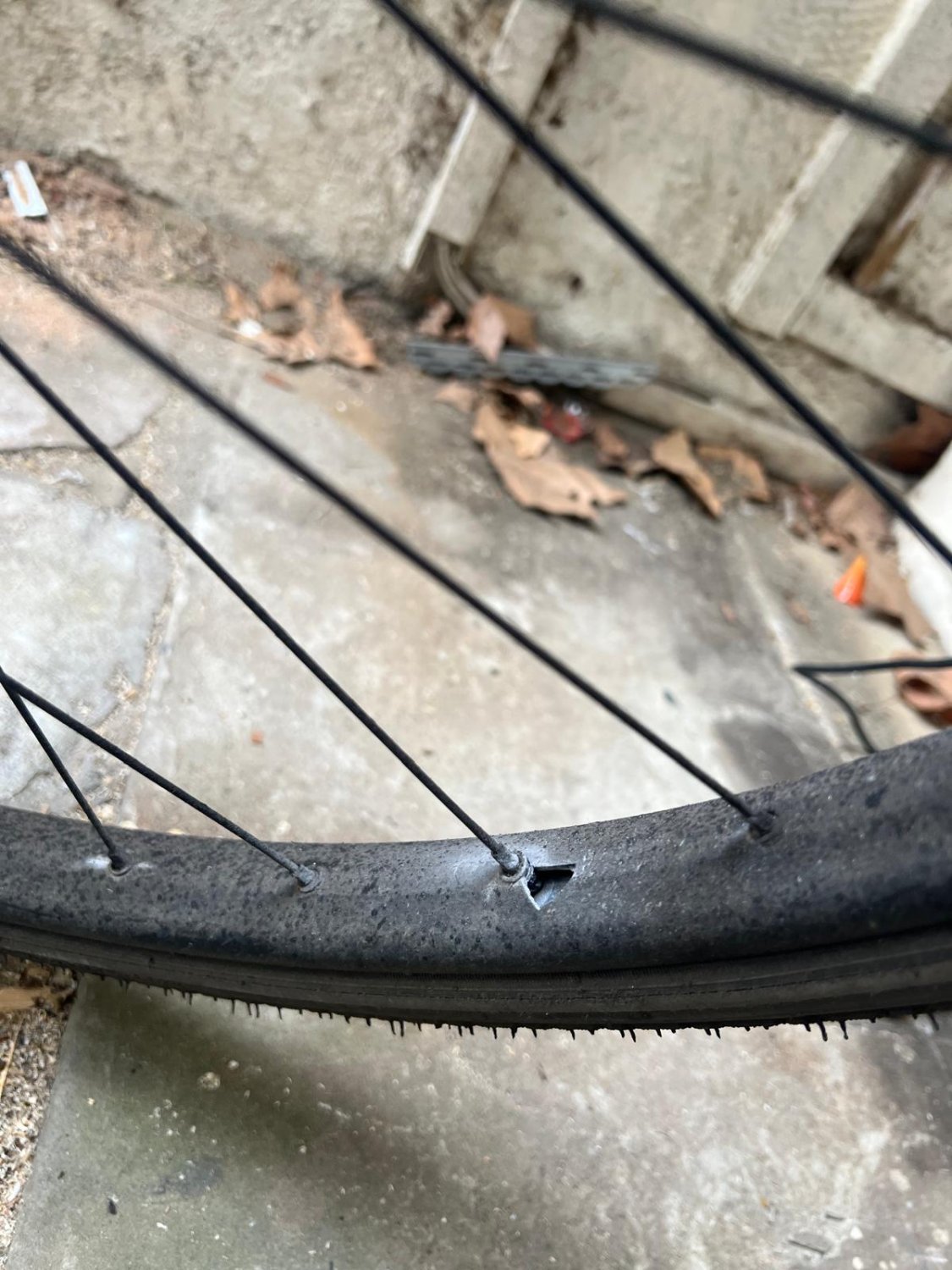

Today, returning home, I was startled by a noise coming from behind. When I checked, I saw that a spoke had broken off the rear wheel and there was a finger-sized hole in the rim. I don't know what to do now. Does anyone have any ideas?
Should I try my warranty chances if it is a manufacturing defect, or what should I order to replace it?
The warranty expires in November. I've done 1500 kilometres so far.
(Vado SL)

should be covered by warranty unless you’re over the load limit etc. take it to your specialized LBS and they’ll get it sorted. they’ll likely just replace the whole wheel.
if you don’t want to bother, the wheel is probably a DT swiss r500, but the 12x148 through axle version is not that easy to find.

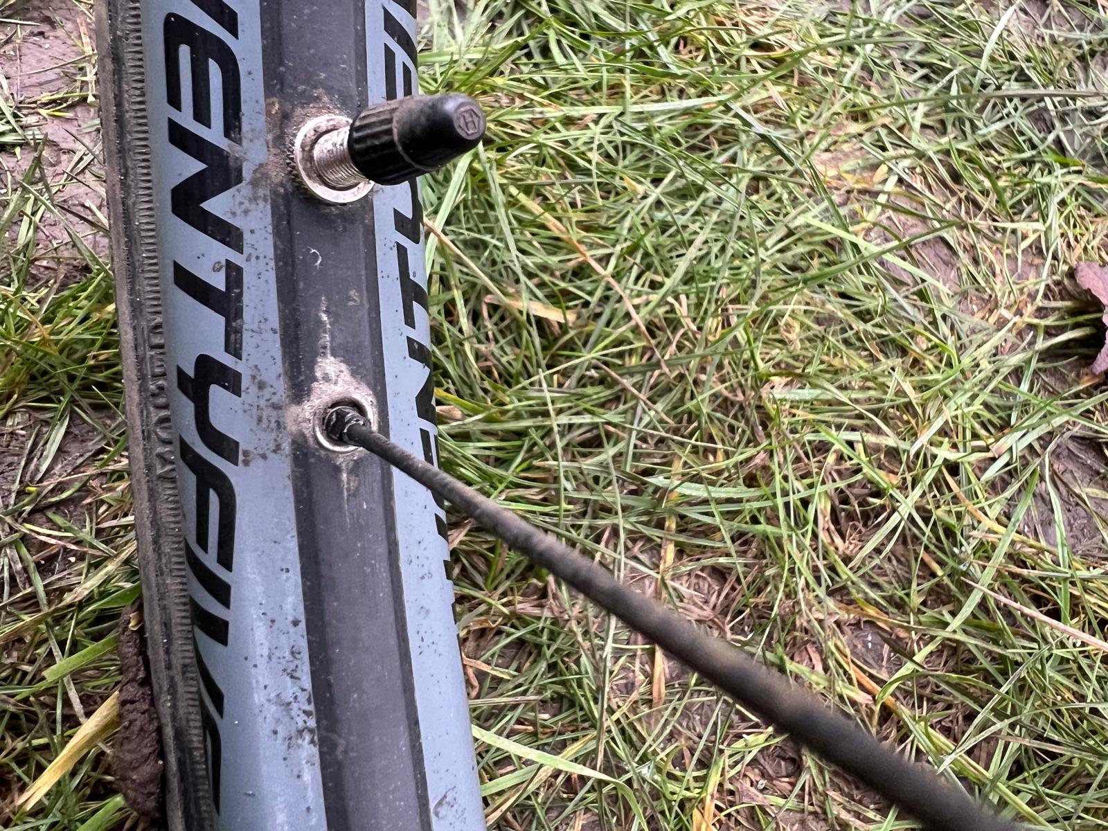

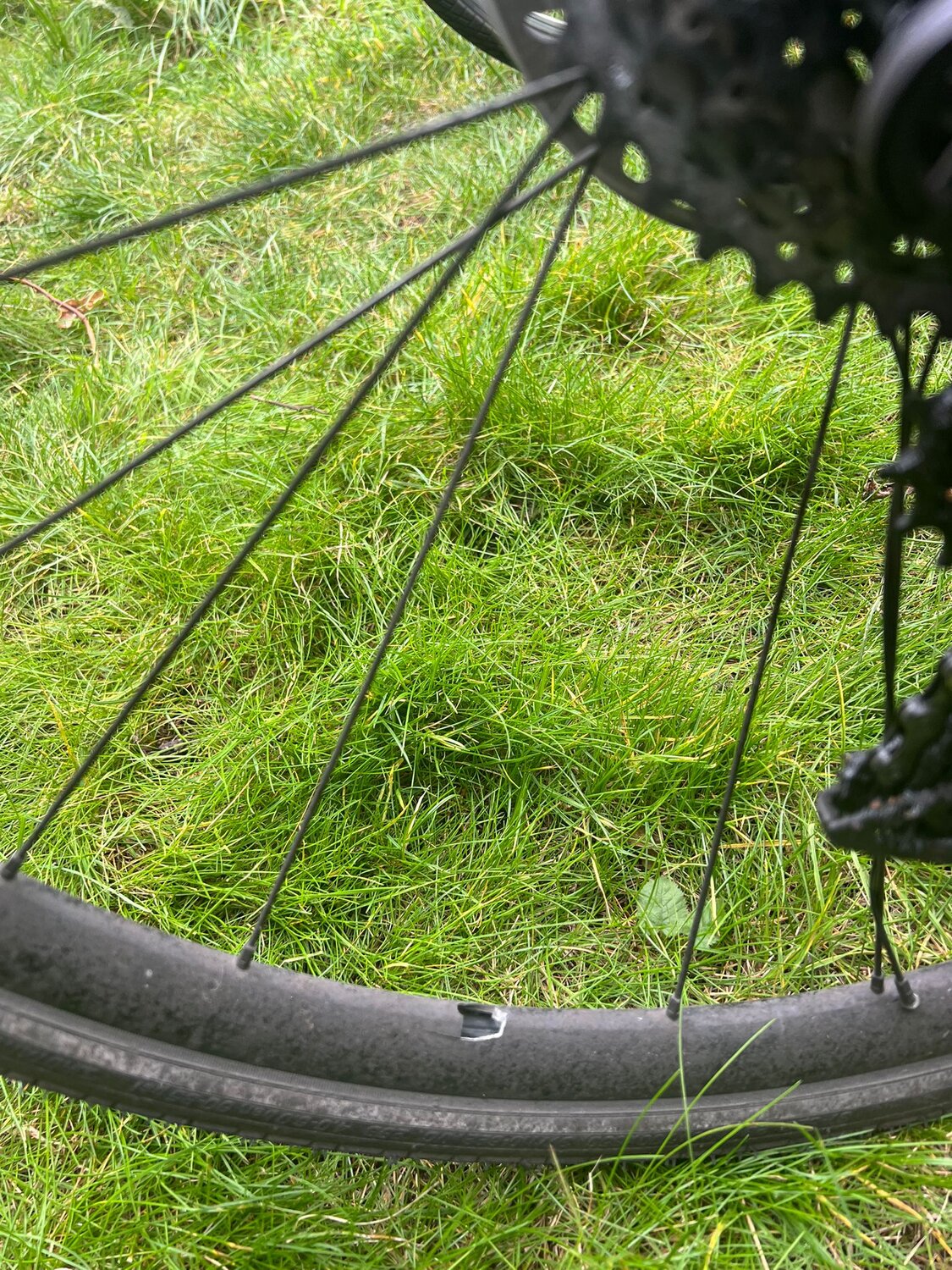

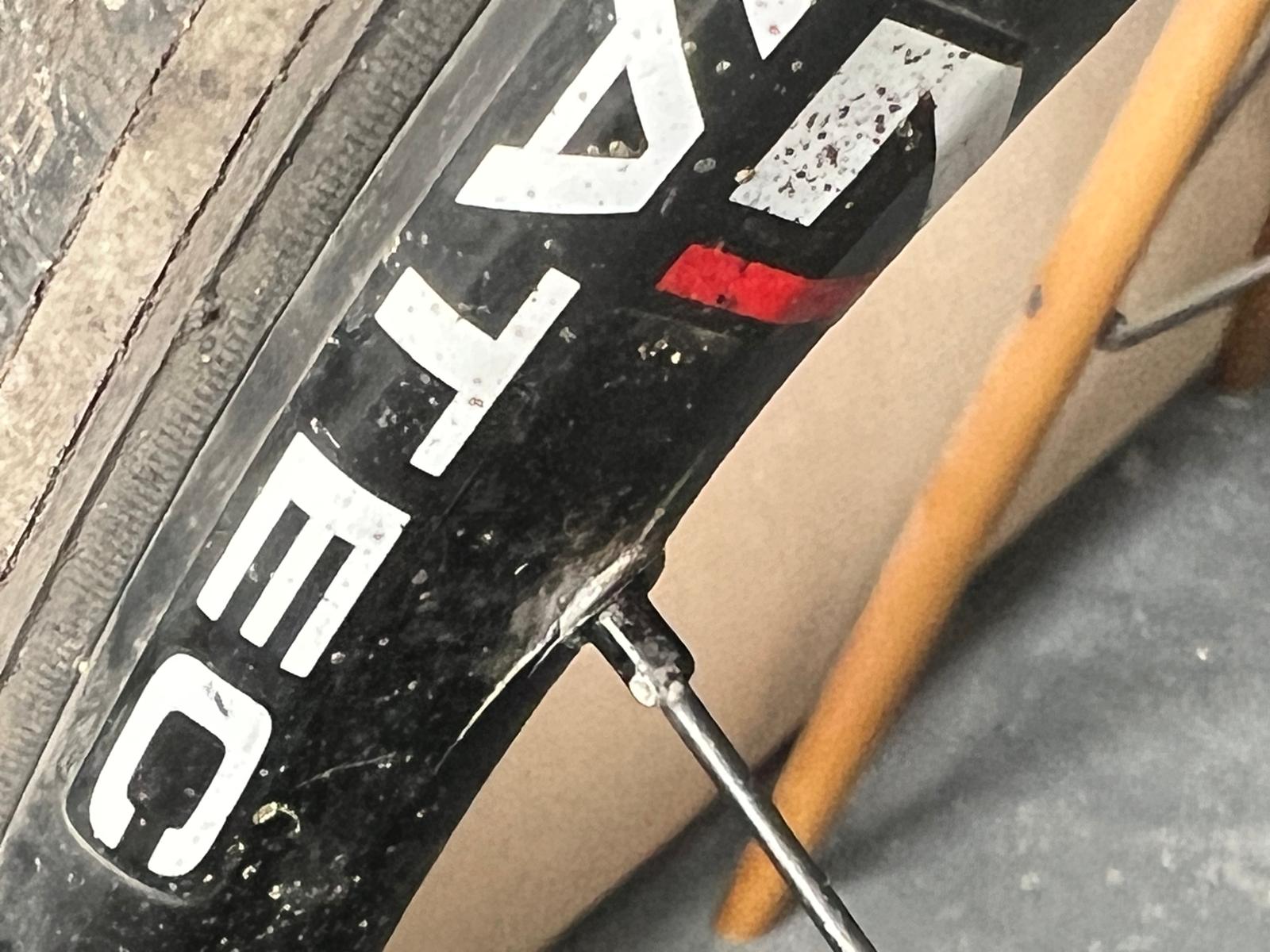

OK now!
The rear wheel of my bike was replaced on November 15 (covered by warranty).
However, after using the bike from November 2024 to March 2025, I have encountered the same problem again with the recently installed rear wheel.
This issue is becoming increasingly inconvenient.
From my experience, the latest rear wheel does not seem to match the original DT Swiss quality, which may be a factor in the recurring issue.

I cannot understand it. Despite I am a rather heavy person, the 28-spoke rims are the standard Specialized issue, and I often ride hard terrain, no issues with my wheels since June 2021!
What's wrong in your situation?
I think the last wheel installed was not good enough.
Brand: NOVATEC
Model: Twentyfive
I travel 50 km every day and have logged over 20,000 km since 2022. I have not encountered any issues with the original DT Swiss equipment since reaching 15,000 km.
You see, I have ridden my Vado SL for 17,100 km since 23rd of June 2021, and even didn't need to ever true the wheels! Not DT Swiss. Probably Novatec.
OEM (R)oval wheels used to be on formula hubs and with white label rims. out the top of my head the ones in the Vado SL's are Formula hubs in DT R series rims.
What I think I see with those rims on the pictures is that either the tension on the spokes has been decreasing and thus has a bigger chance to come loose and janked back in place with each rotation, that would explain this issue. Or the tension has been to high (not very likely) and you hit a pothole at fullspeed with a lot of weight.
at the service counter I would advice a proper wheelset set with good rims and advice to have the tension checked after 500Km riding.
Yeah Vado SL owner 4+ years and never a bother. Not exactly gentle with them on rough roads and gravel. I do have tyres with a lot of squish however. But as it's only an SL 4.0 I have marvelled at how tough these wheels are.
To happen once is just one of those things, twice is pretty unusual. Bad luck.
Hmm, TA's on the SL2 are at a higher torque value 15 front 16 rear. SL 1 goes 15 Nm for both
