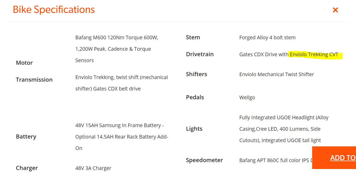

My big concern is the fact the Evelo is combining an M600 motor (with 120Nm of torque) with an Eviolo CVT that is only rated at 85 Nm. I do about 6K miles/year on my bike and I am very concerned about the CVT holding up past the warranty (which is only 3 years given the amount I ride).
Where did you determine that that Evelo is using the shorter speced CVT rather than the one that matches their motor choice spec? I confirmed that, on the Omega, they are use the Sportive model which handles up to 120 Nm continuous torque. My assumption would be that they are using the same on the Atlas.
Table 1: Types of Enviolo hub
Enviolo Hub ModelGear Ratio RangeContinuous Torque From MotorBrake Options
City310%50 Nm / 250wDisc/rim/roller
Commercial310%50 Nm / 250wDisc/rim/roller
Trekking380%75 Nm / 250wDisc/rim/roller
Cargo (Heavy Duty)380%100 Nm / 500wDisc/rim
Sportive (Heavy Duty)380%120 Nm / 500wDisc/rim
Source: Enviolo (2018), Enviolo Technical Manual 2020.
Their website shows it is the less-capable Trekking version: https://evelo.com/products/atlas/#components
