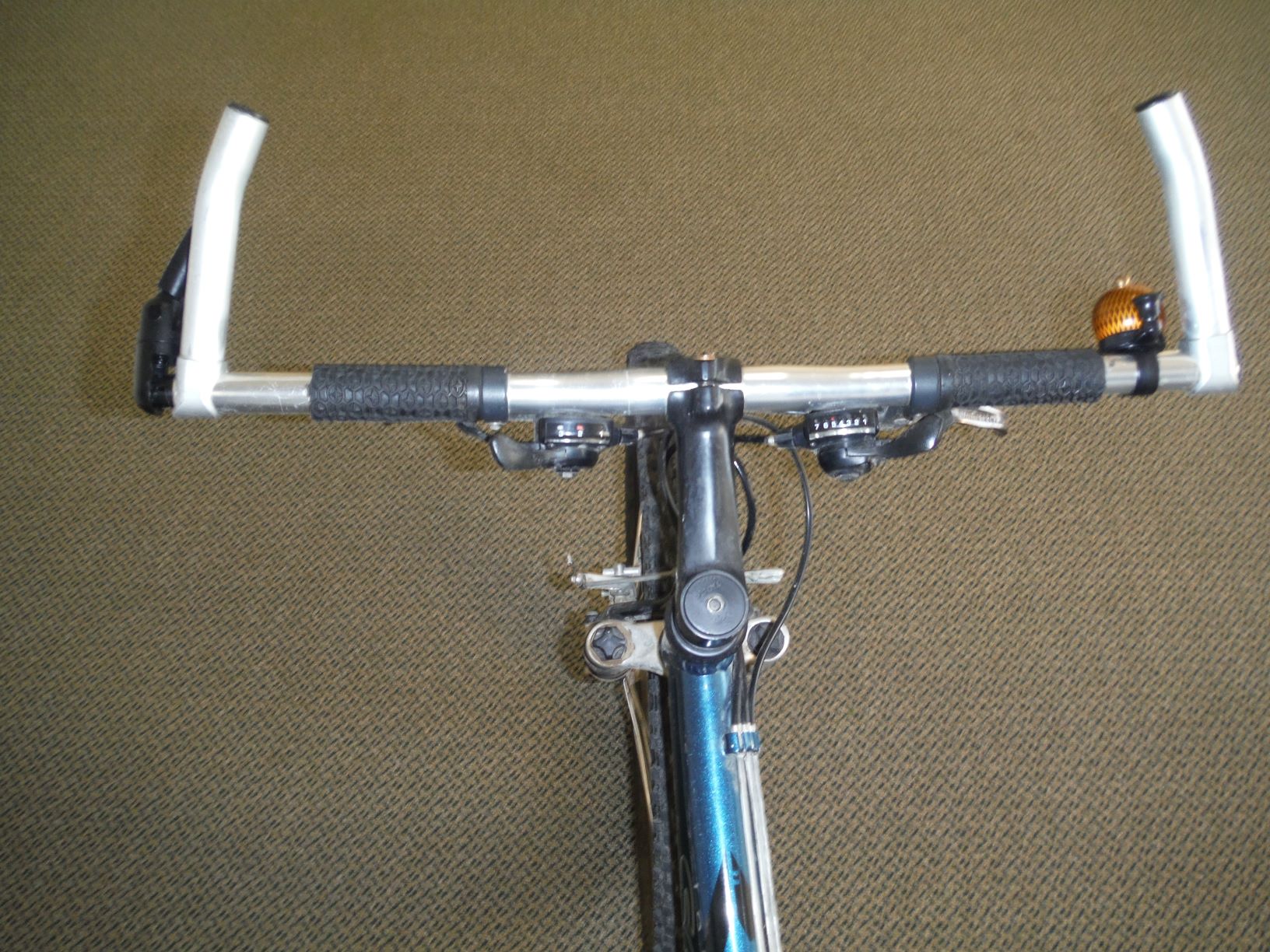

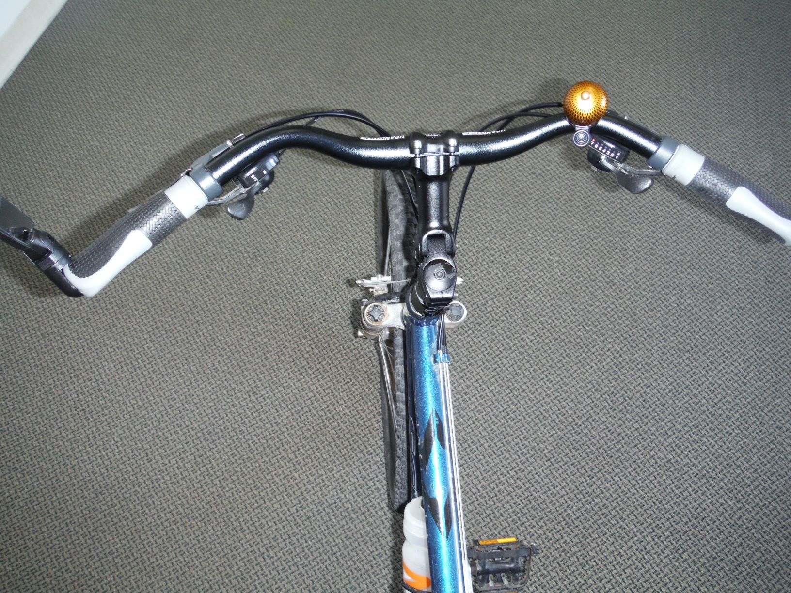

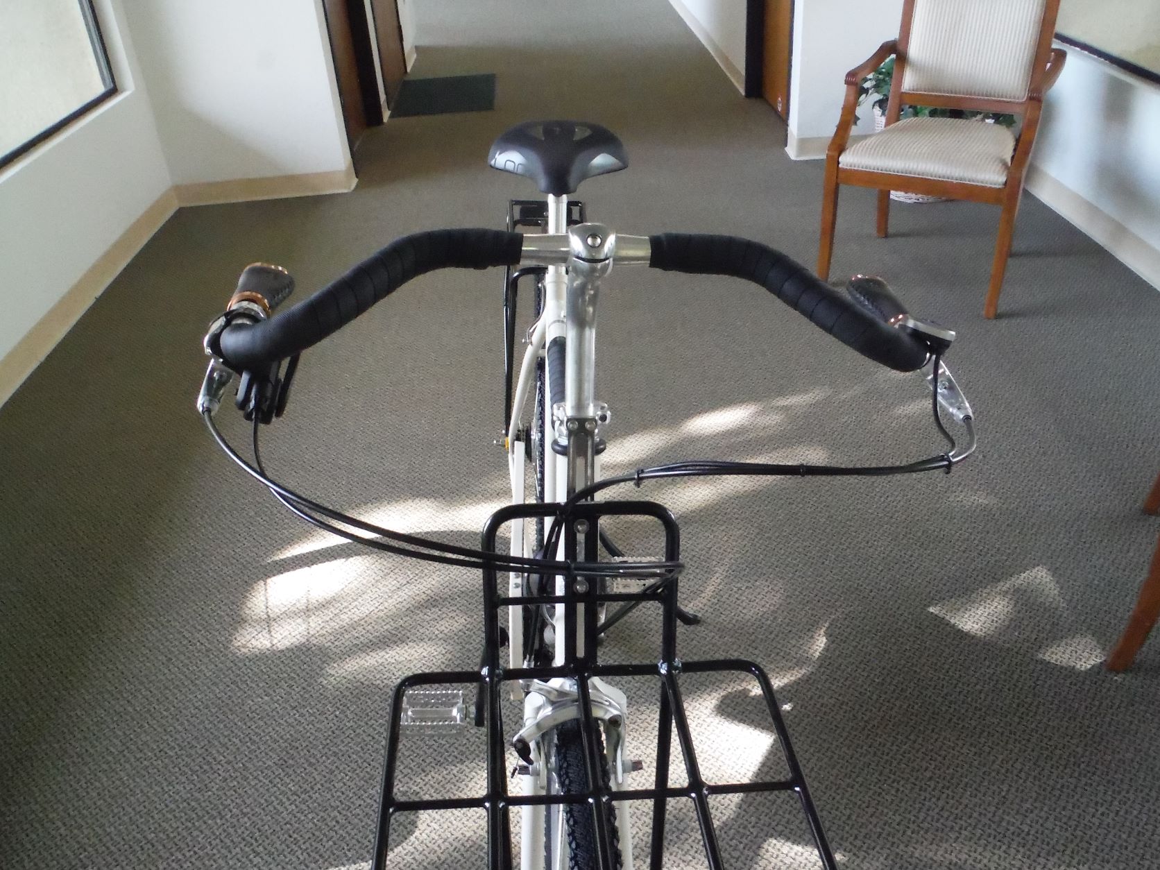

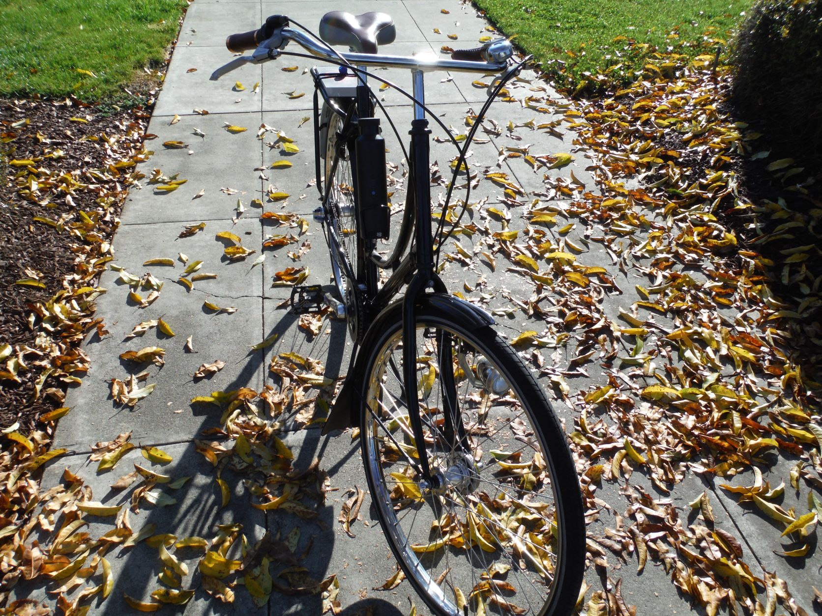

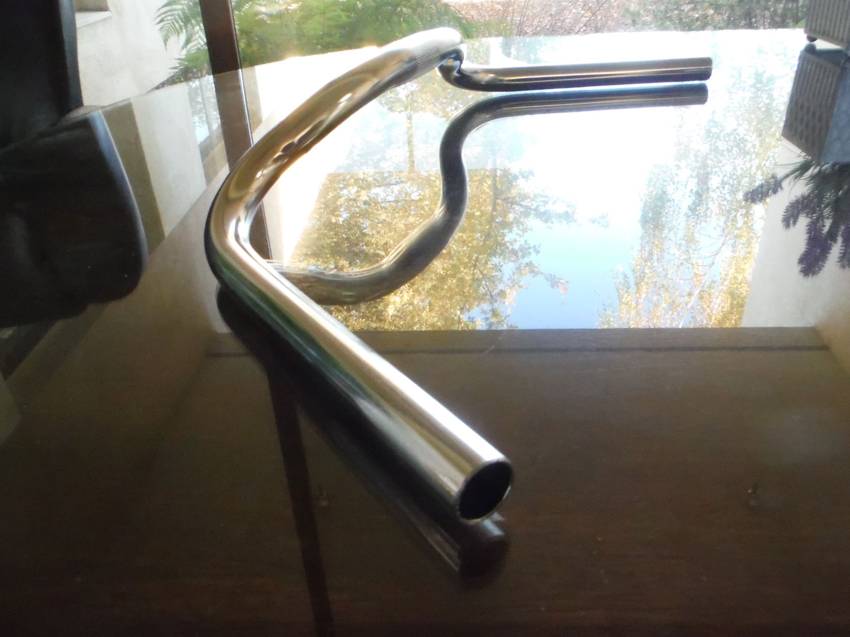

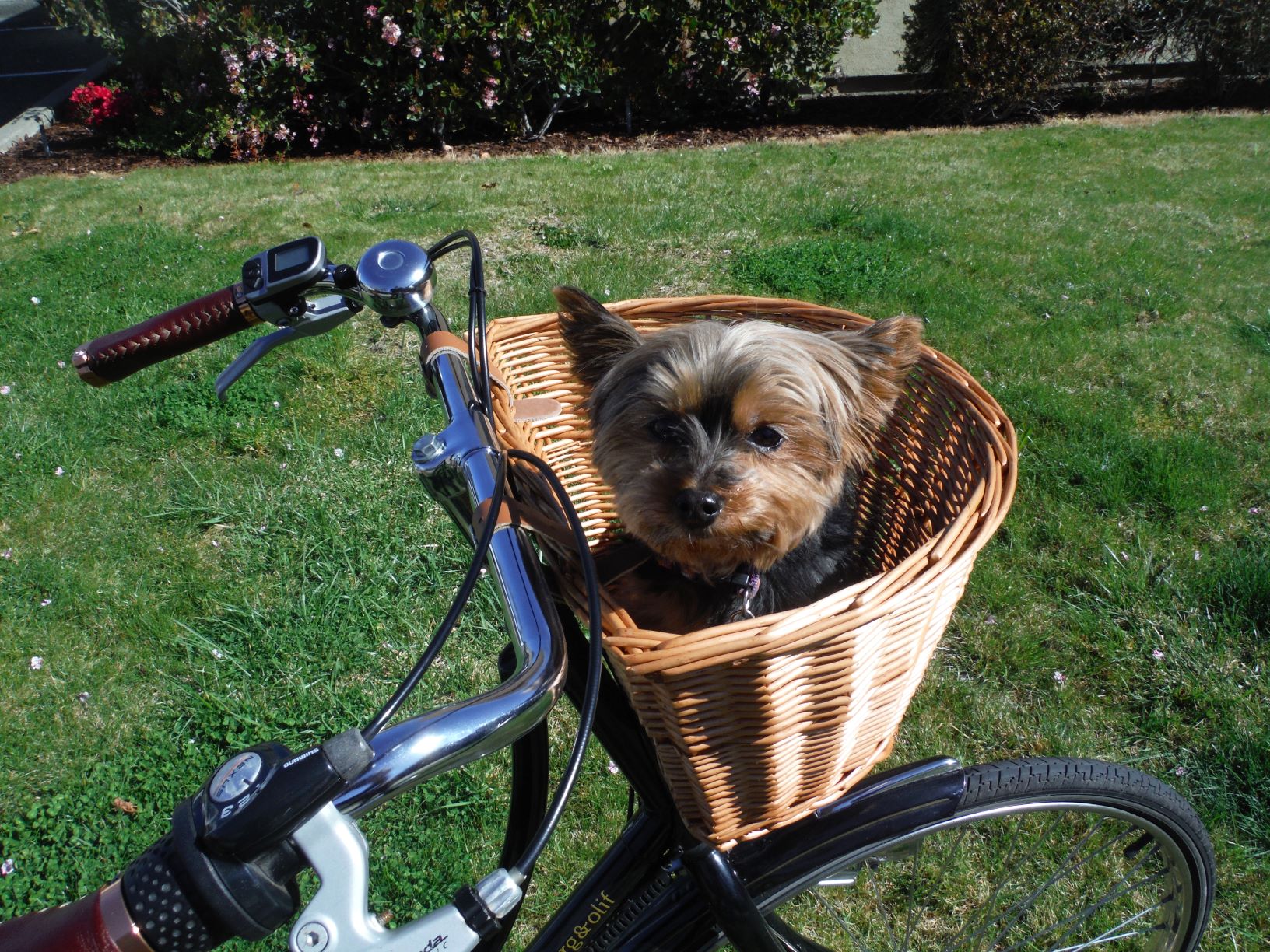

Some ideas. The first is before and after. Being able to change up positions prevent fatigue.
