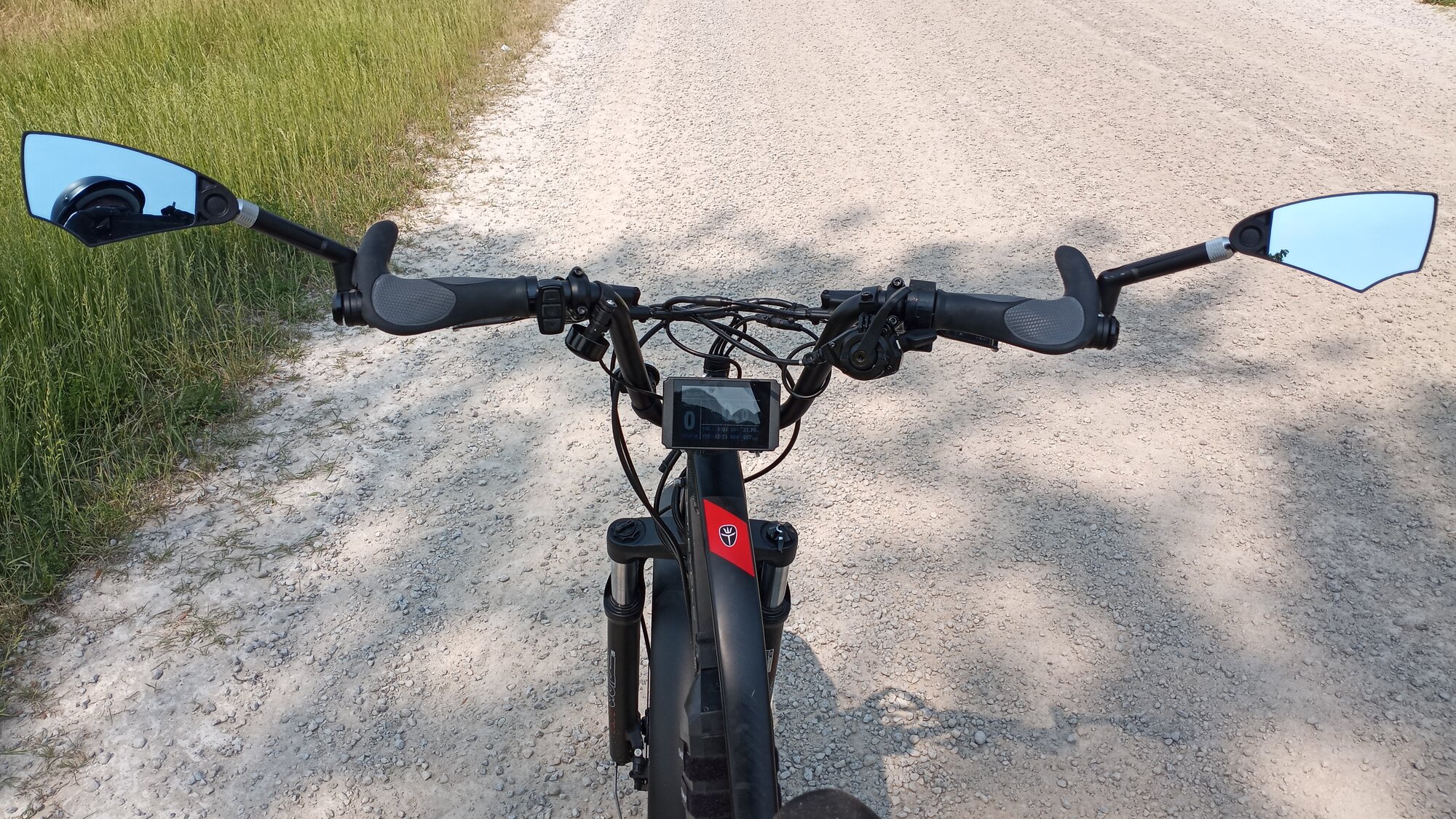

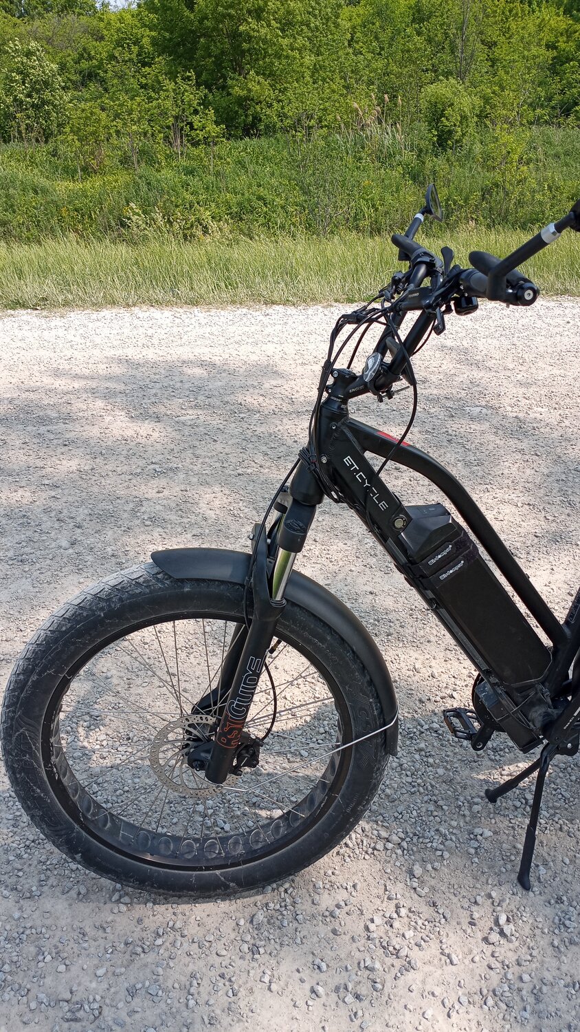

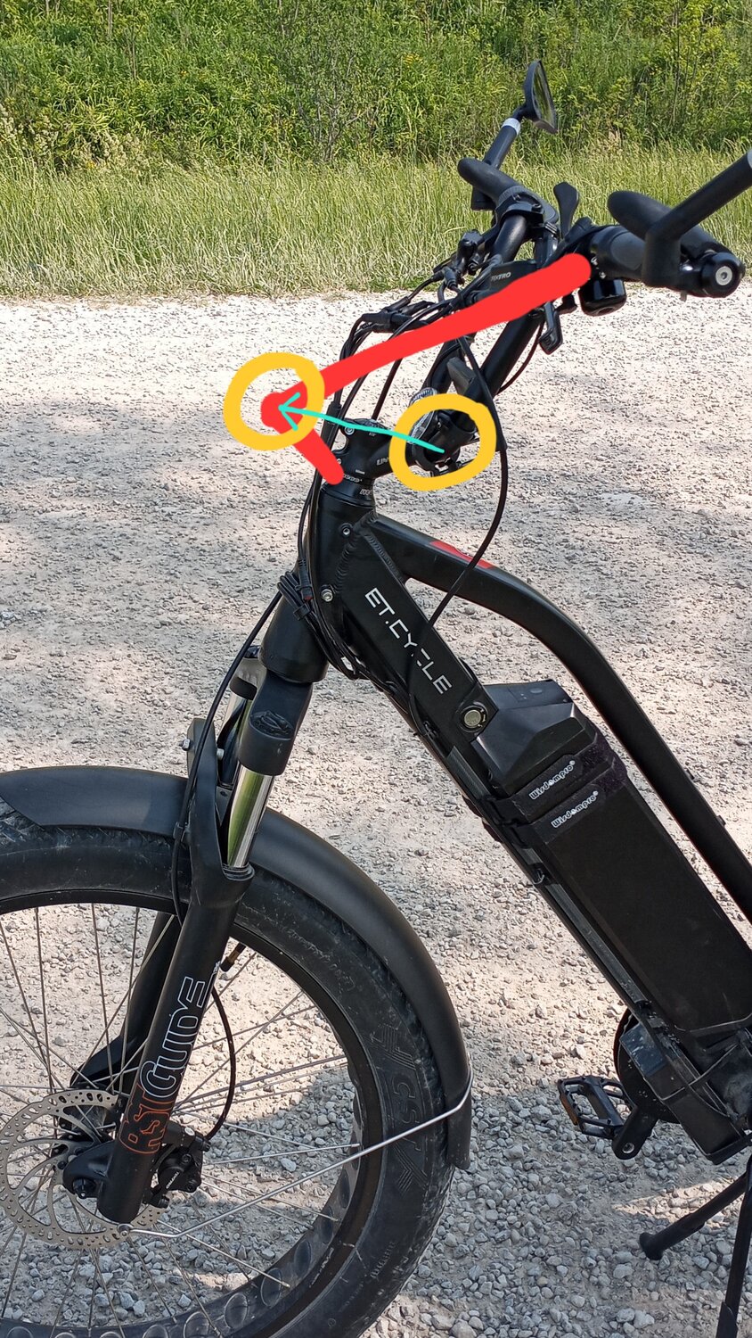

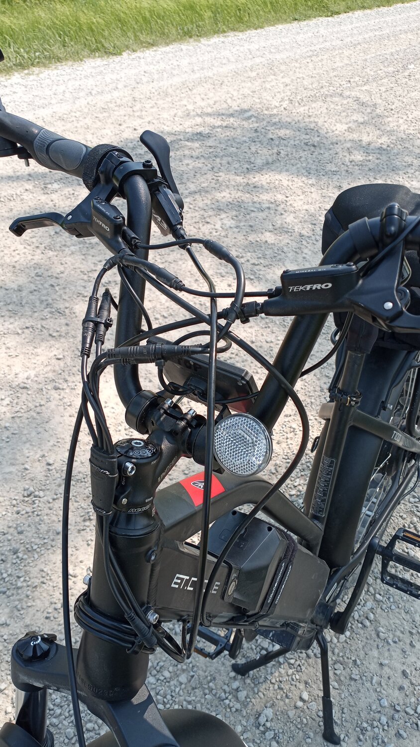

My handlebars and stem arrived and I got them installed.
It looks kinda stupid with the stem reversed, but I don't care.
It works for me. I am sitting up perfectly straight.
I could have installed the stem normally and tipped the bars back further, but now the bars a pushing straight down in line with the forks.
It's working great. The bars feel solid and there is no creaking.

If I had it reversed I would be pushing down on the handlebars at an angle when I'm pounding down a trail.
The stem/handlebar connection would be under huge torque with my 8½ inch tall riser bars.
I would strip the stem/handlebar connection.

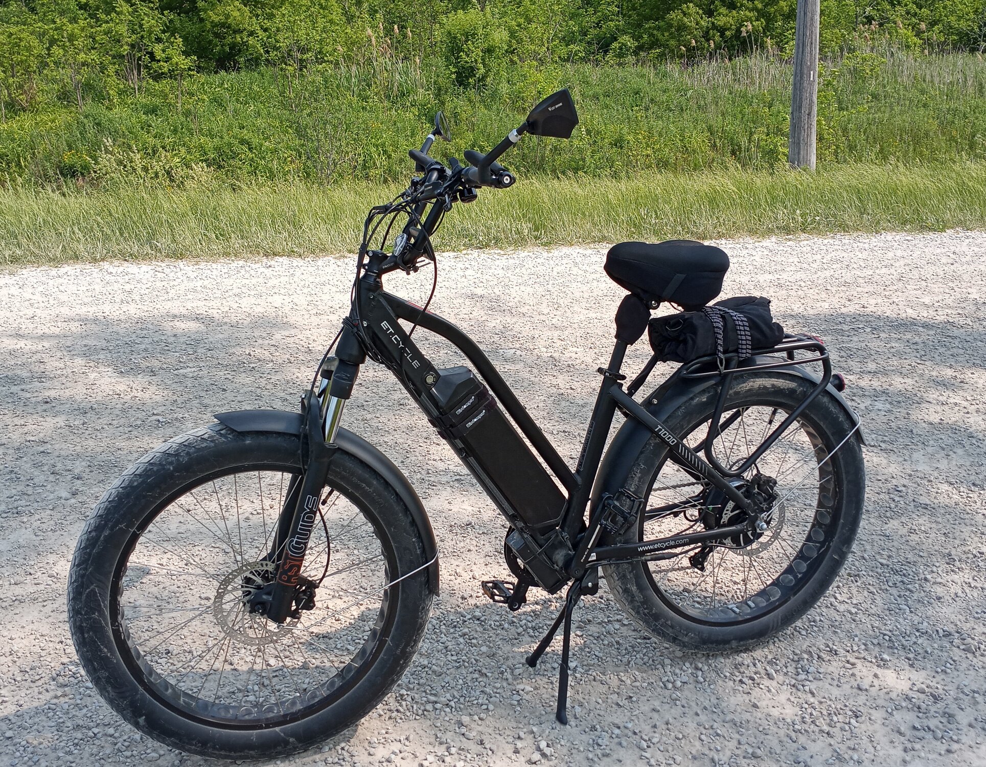

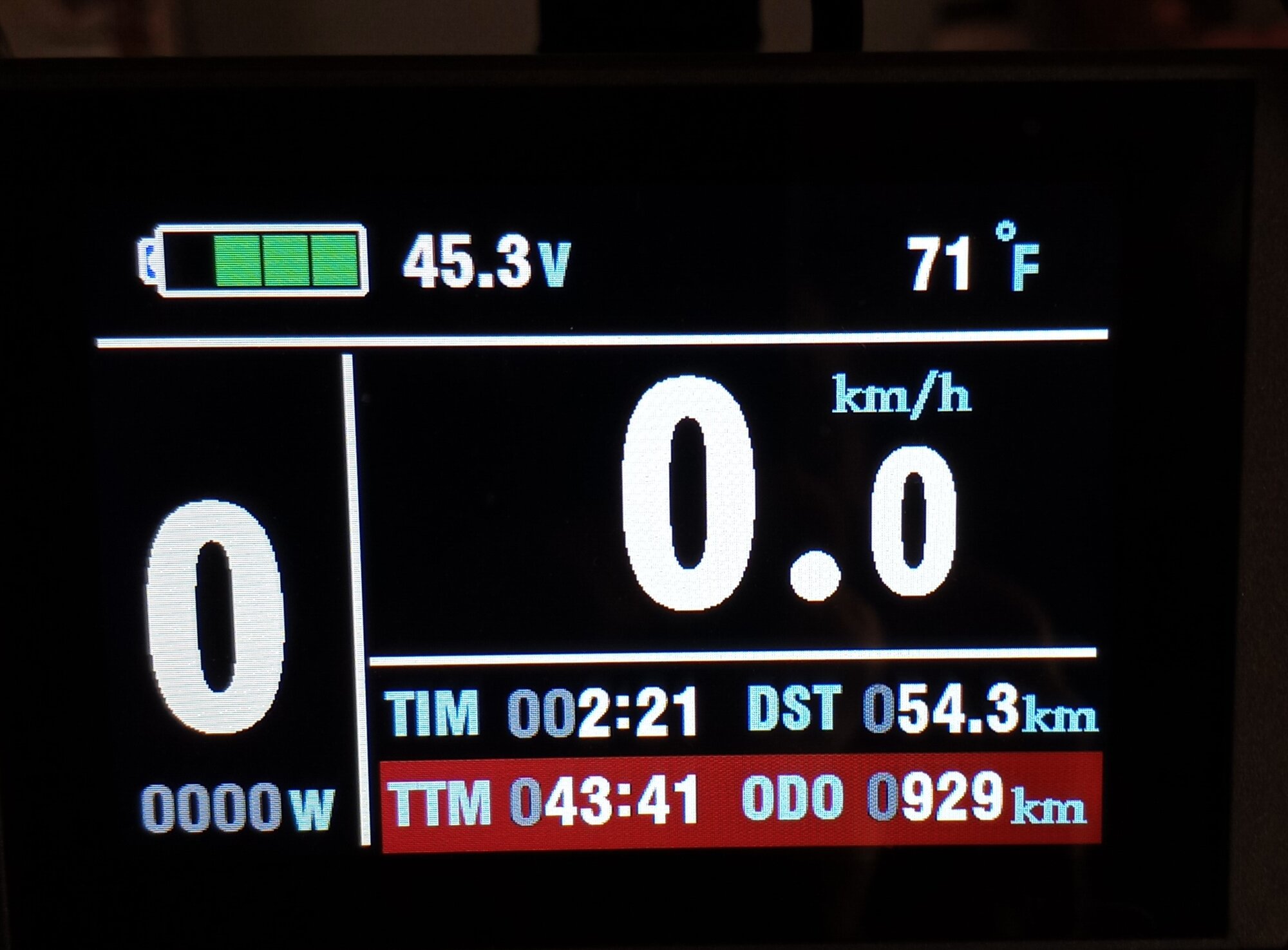

I rode Da Bull this morning 10 miler 5 miles out 5 miles on the return.
I rode 54 km today.
It took me 2½ hours.
I returned home with over 40% charge remaining.
I didn't pedal.
I rode 45 km today.
I didn't pedal.

I originally used BMX high rise bars for an upright riding position. While the height was good, the grip angle wasn't. I couldn't find high rise bars with the angle I wanted so I switched to a stem riser and Jones H bars.
I noticed no difference in handling between the high rise bars and stem riser but I would be leery of using either for extreme downhill or single track. Just my opinion though.
I noticed that when I was searching for handlebars. The BMX handlebars were straight across, and I didn't think that I'd like that. I did like how they had the second horizontal bar for reinforcement though.
I was nervous about using a stem riser, thinking that they might start creaking too, but my creaking issue may have been only because of the adjustable stem?

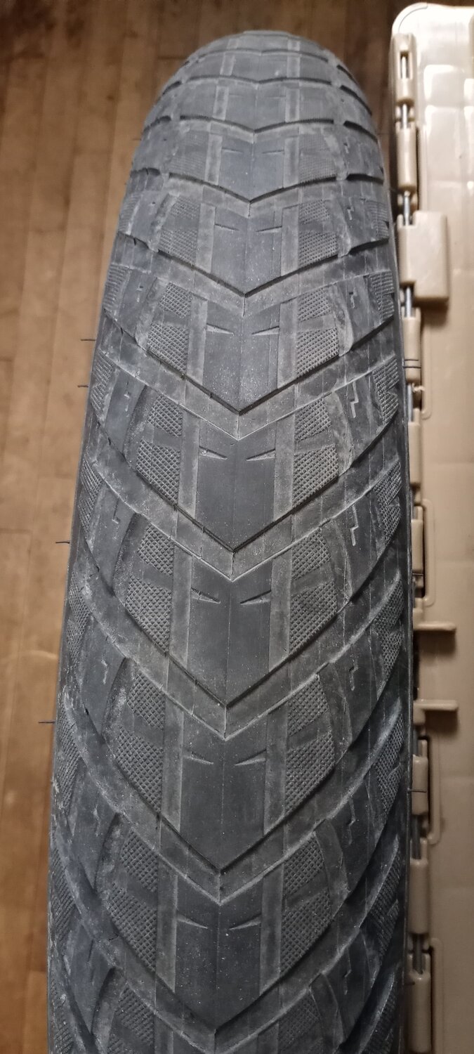

It weighs 90 pounds with street tires. I've got 1.5 mm of tread depth.
I have been "off-road" though, I just have to go really slow and careful.
I've got very little grip in the dirt, and I have to get used to my tires sliding around under me.
It really floats around on some of the gravel roads I've been on.
That's an uncomfortable feeling.

I know that @6zfshdb likes to sit up straight like I do and has riser bars.
He may have done something similar, but I may be the only one that reversed my steering stem?
I will admit that it sure looks wrong, and kinda stupid looking. 😂

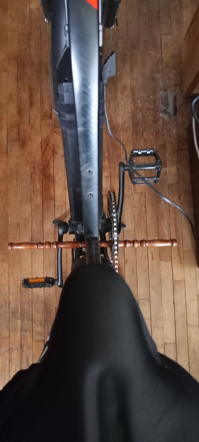

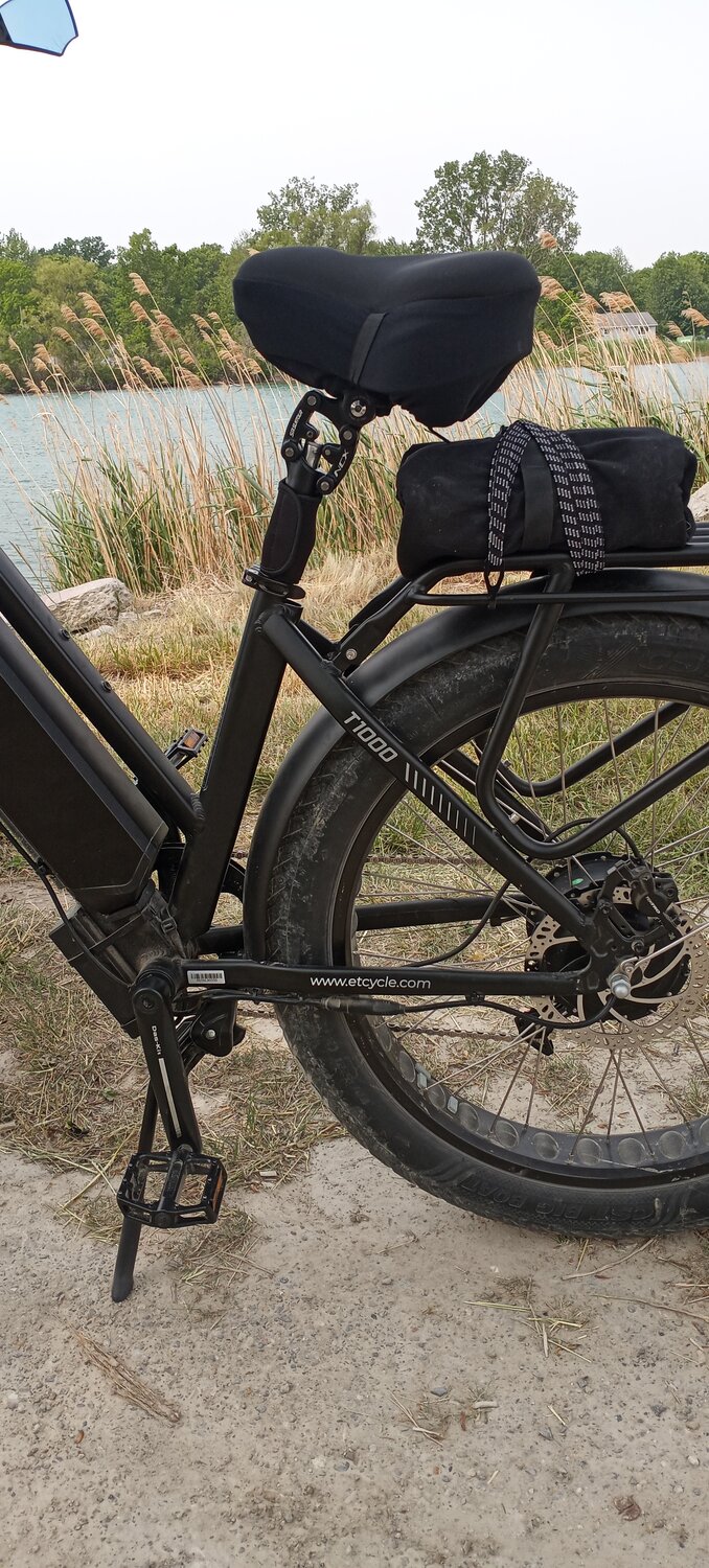

I tried reversing the stem on one of my conventional bikes to shorten the seat to steering tube measurement. It worked alright but it isn't necessary on my e-bikes.

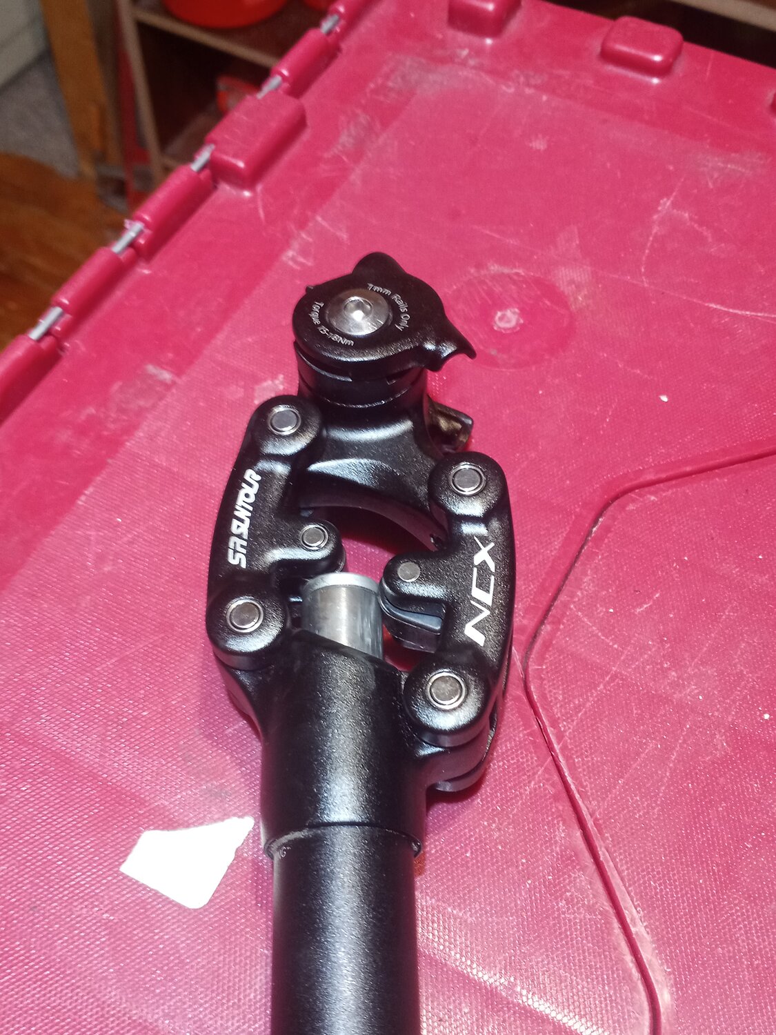

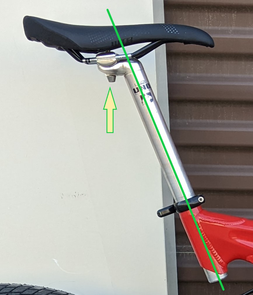

@PCeBiker you have an enormous setback on your saddle thats why the bike doesn't fit you and you need to go to such an extreme of reversing the stem. Also there are shorter riser stems out there. Controlwise and safetywise, you'll be far better off fixing the problem rather than doing this.

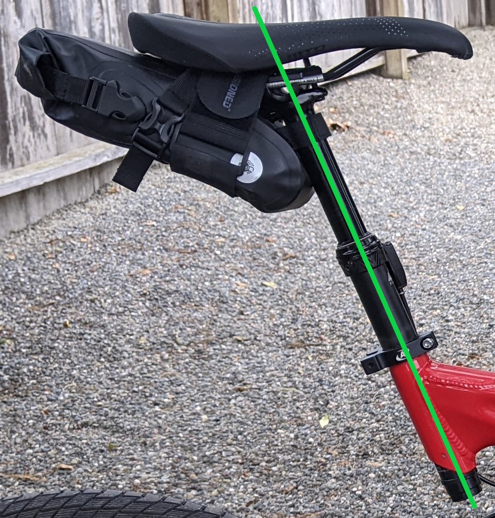

A Satori Animaris will give you the suspension without all that setback. And you'd want to move the saddle forward on its rails in the mount. I'll bet its pretty far back right now. Don't do that if you did :)

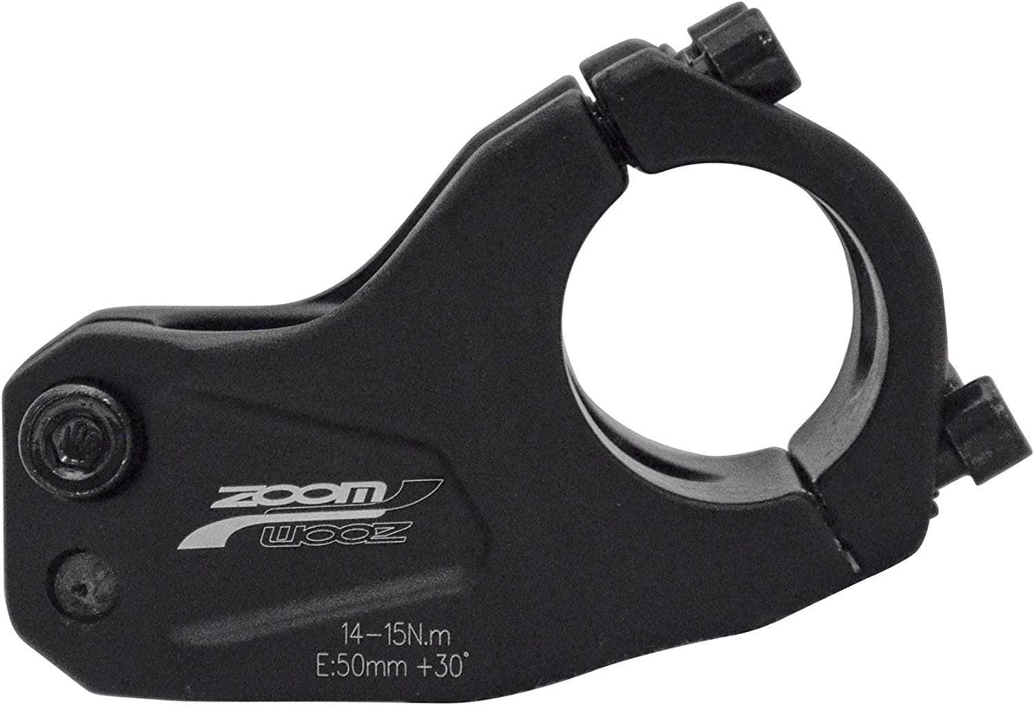

Here's a short riser stem so you keep the bars close and up without doing something crazy.
And here's what setback is. Some on the left, none on the right. The right post is a PNW Coast suspension dropper.
Setback stuff taken from here, where there's also a discussion on stems:
Most of that is the suspension seat post but I can slide the seat forward almost an inch.

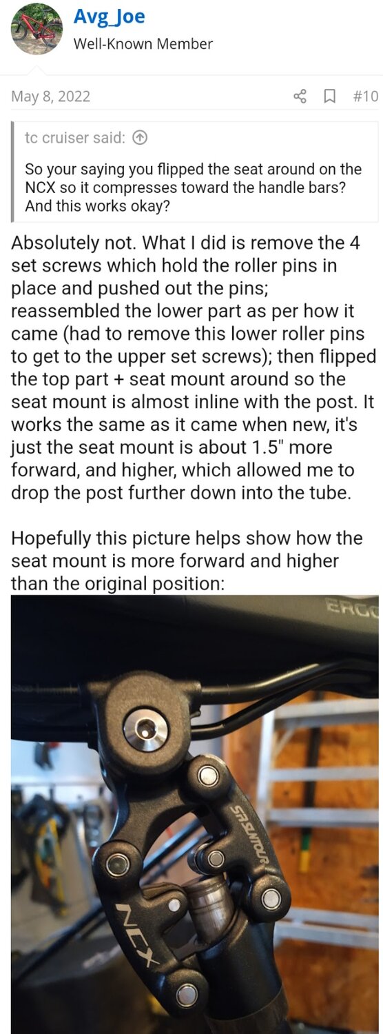

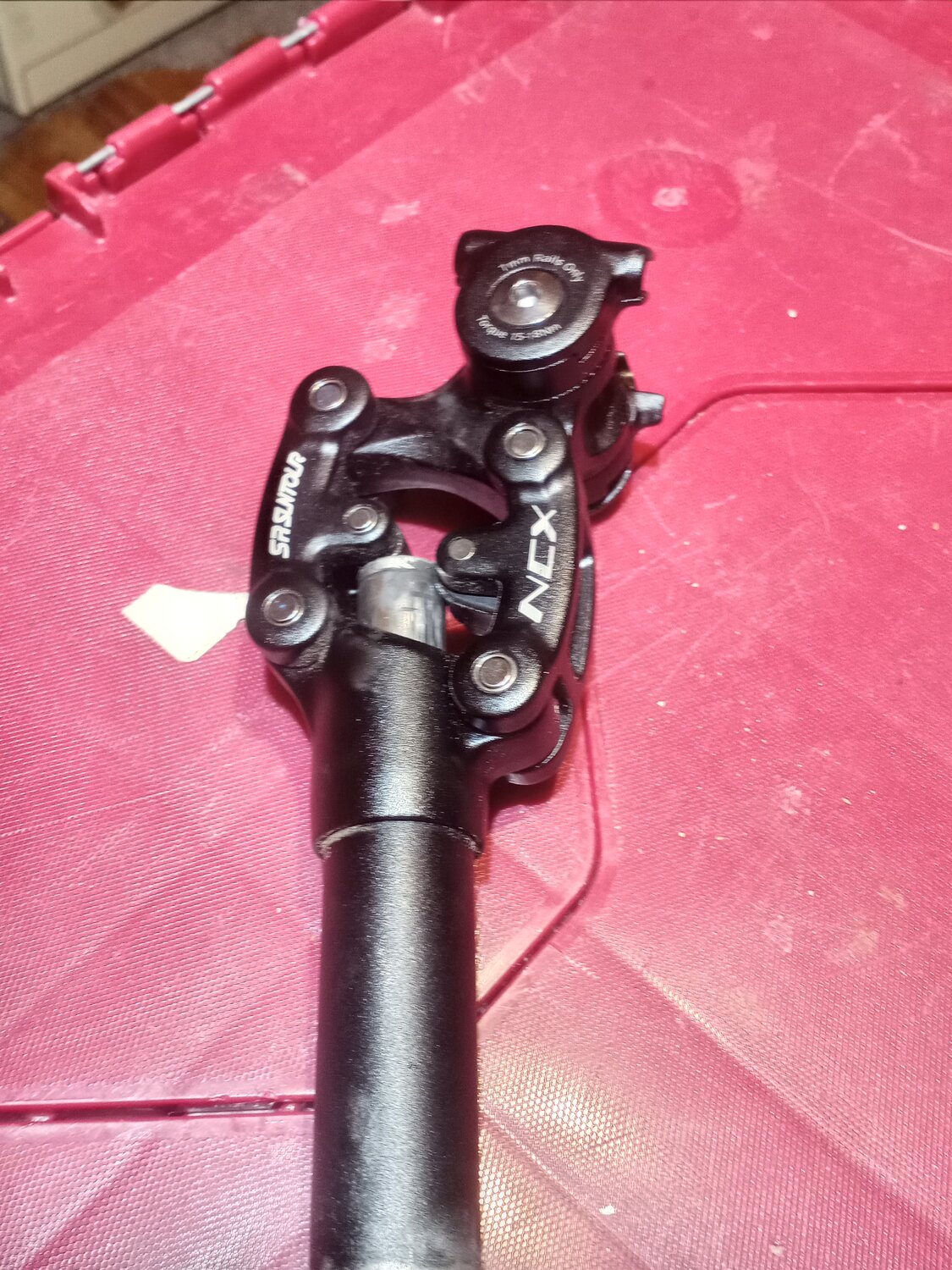

I remember seeing that now in an older thread. Clearly its had a major negative consequence. The Suntour suspension post in its normal orientation is known to bottom itself out on itself - i.e. smash itself. Your change fixes that but causes something I'd argue is much worse.
Not that I've noticed.
Everything feels solid and seat feels great. I can easily last 3 hours in the saddle.
I've got the opposite problem.
I've hardly got any movement in my suspension post.
I'm thinking about getting a softer spring,..

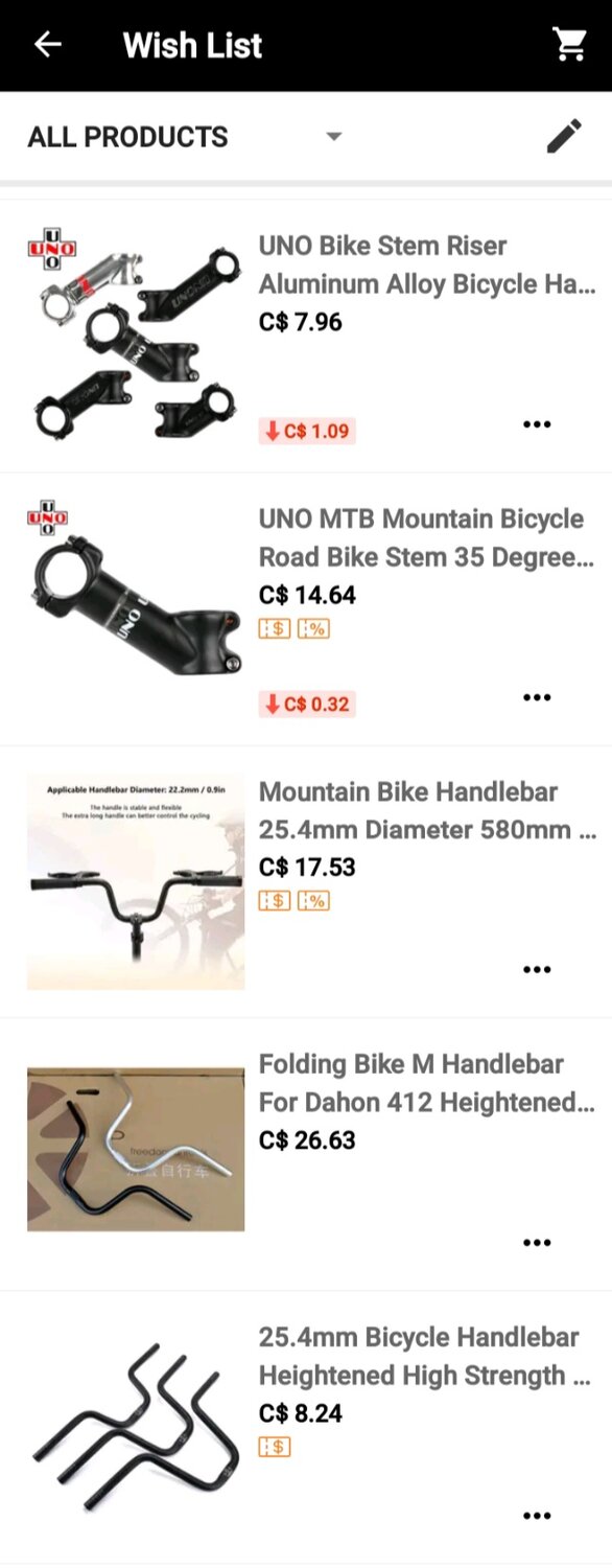

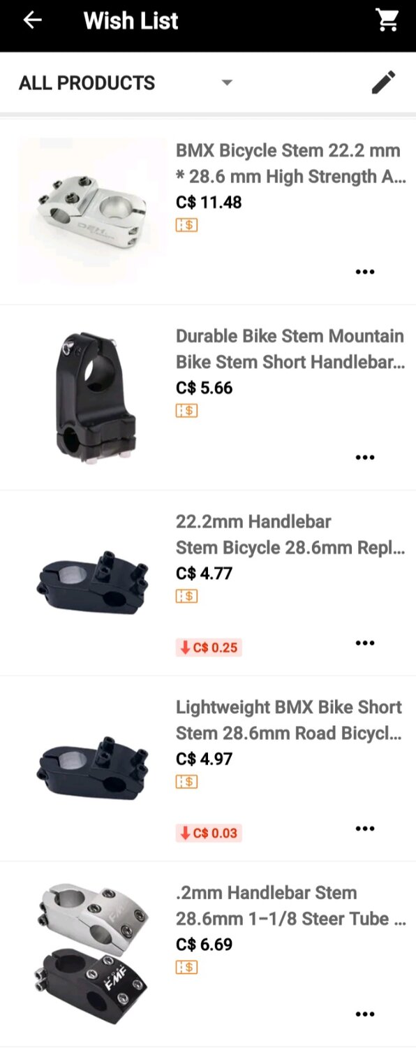

I couldn't find any taller riser bars, otherwise I would have mounted them normally with a short stem.
These are the only riser bars that I could find that would work for me, but I don't know what they are or where to get them. 😂

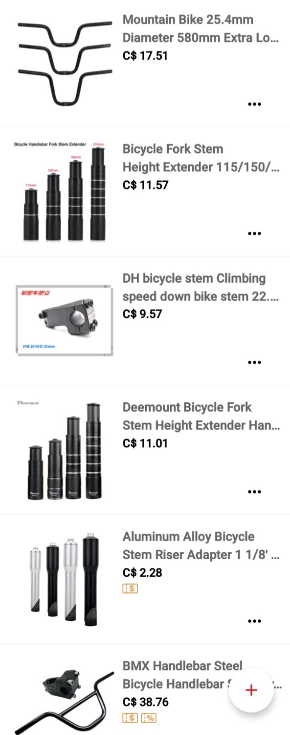

This is my wish list while I was searching for parts,..
The stem I chose reaches out and up enough to get my grips where I want them.
I guess that I should have bought a stem riser instead? Then I wouldn't be upsetting everyone. 😂

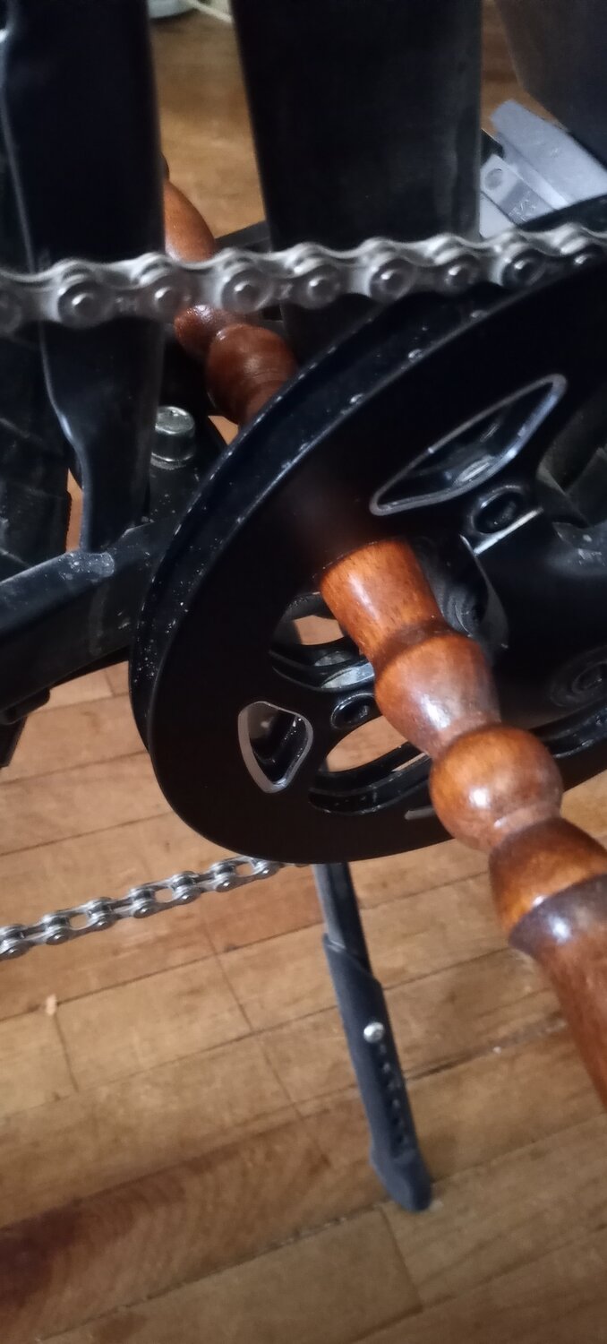

I'm thinking of installing foot pegs because the pedals keep moving around.
This aughta work,..
I can zip tie it to the frame behind the bottom bracket.
If I ever have to pedal, I can just remove it. 😂

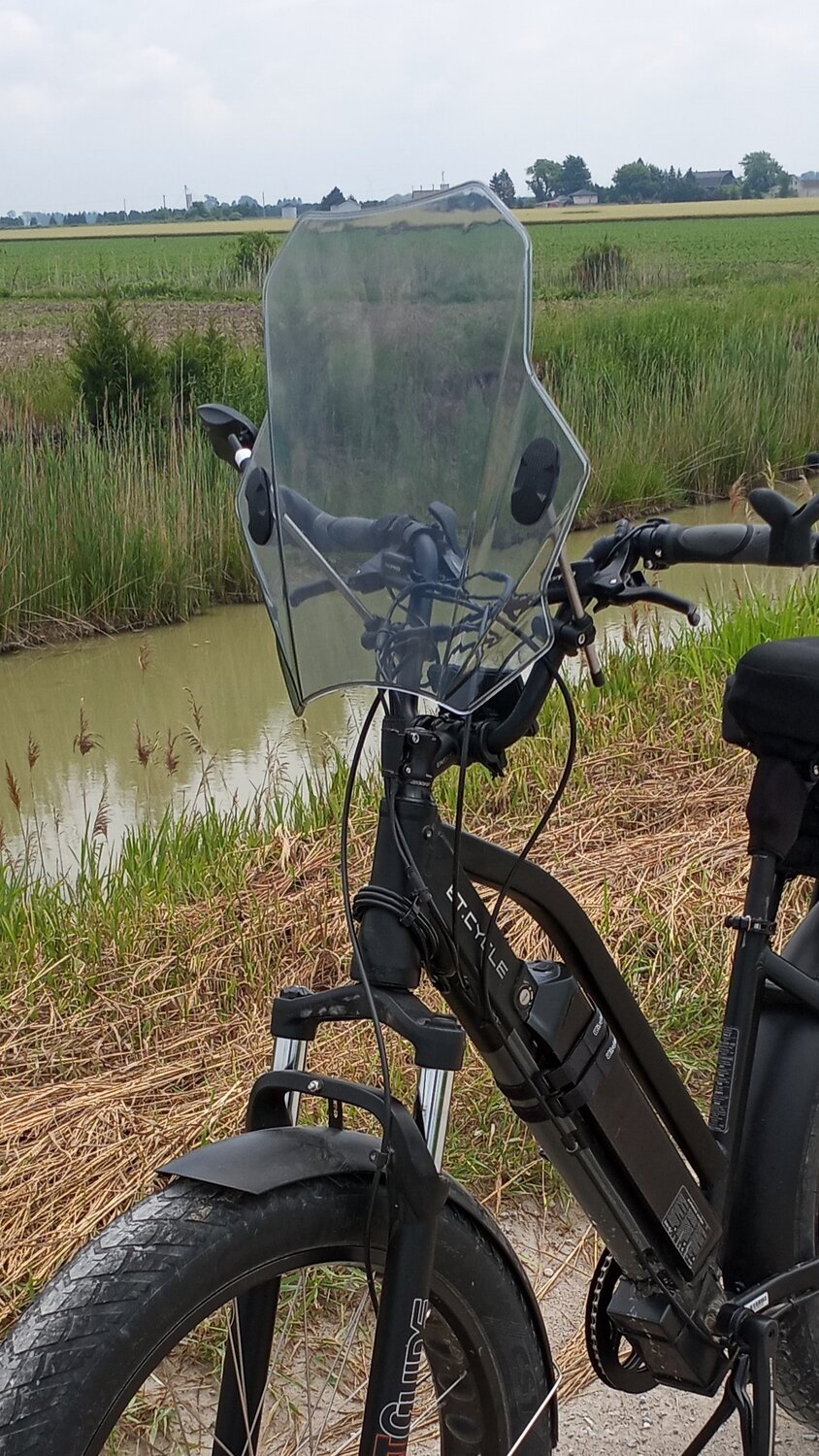

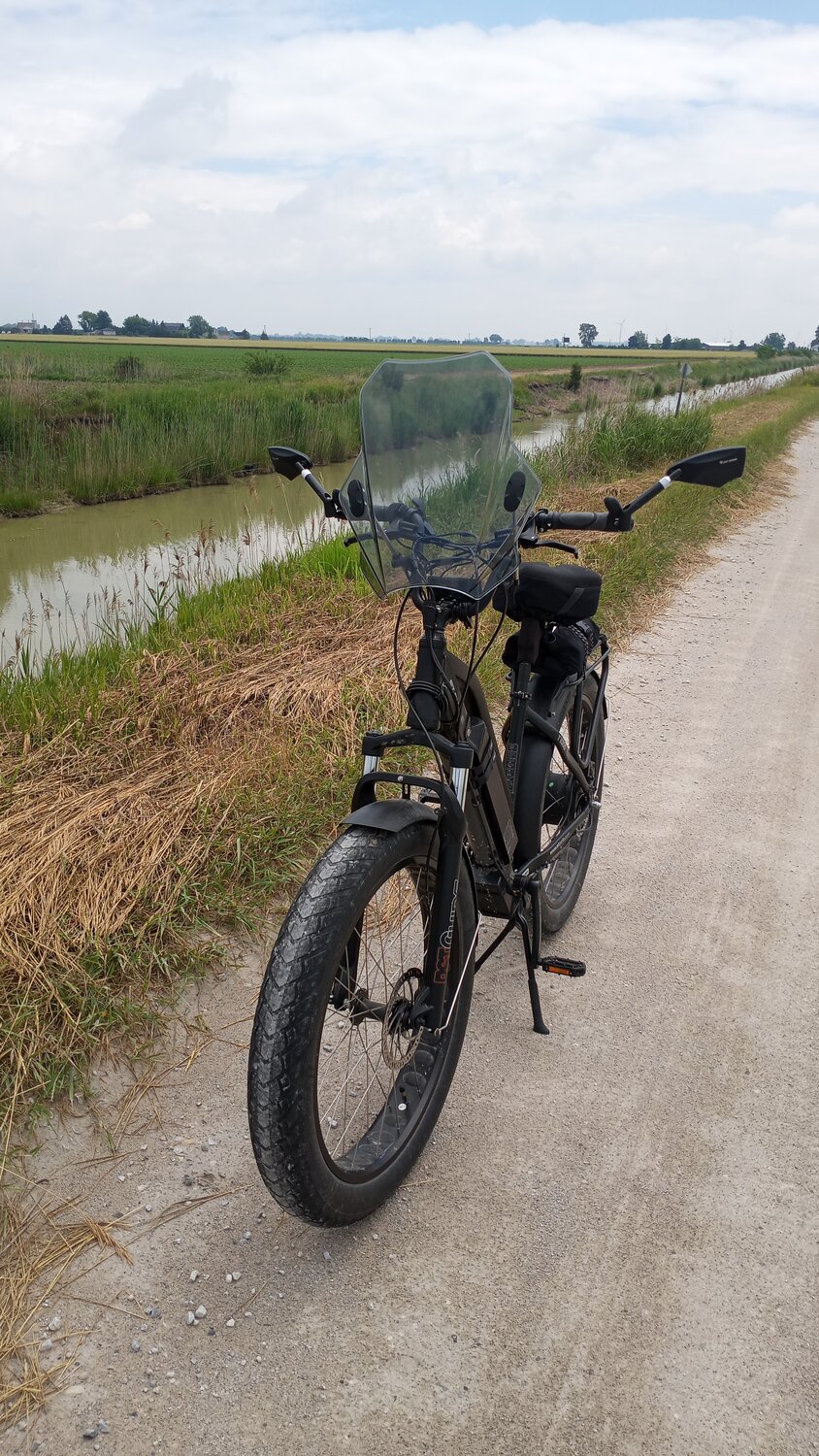

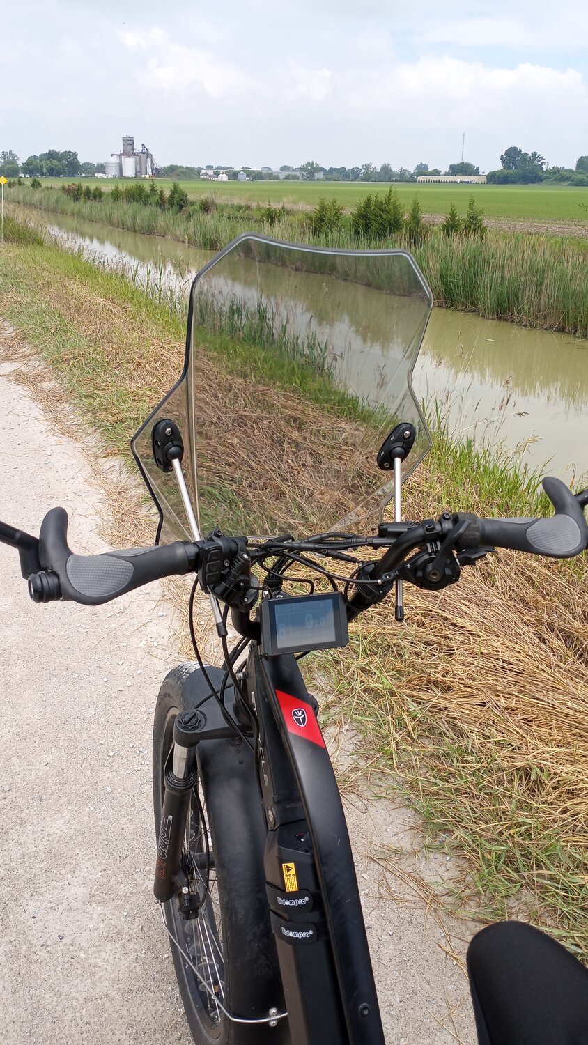

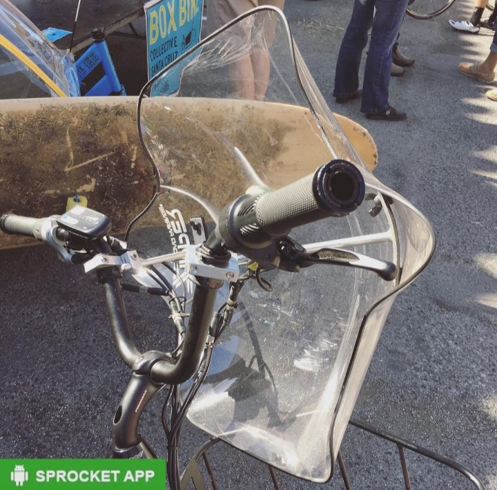

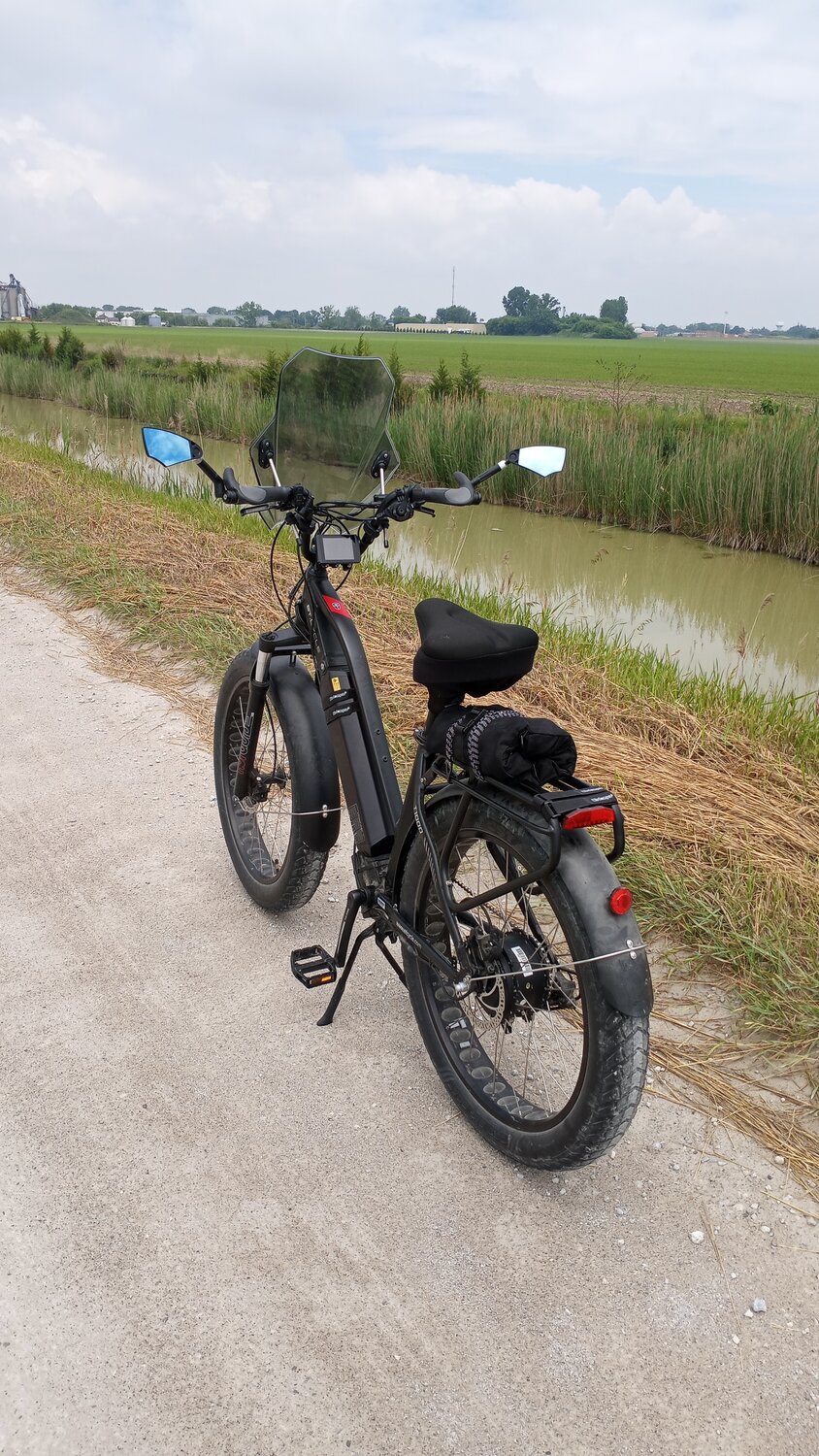

My windshield arrived, and I got it installed.
It looks OK and it helps to cover up my weird looking stem and handlebars.
I went for a ride and it was hard to tell how much difference it made as far as wind noise or wind resistance goes.
I'll try it in a stronger headwind and see how it feels. So far I don't feel it throwing my steering around.

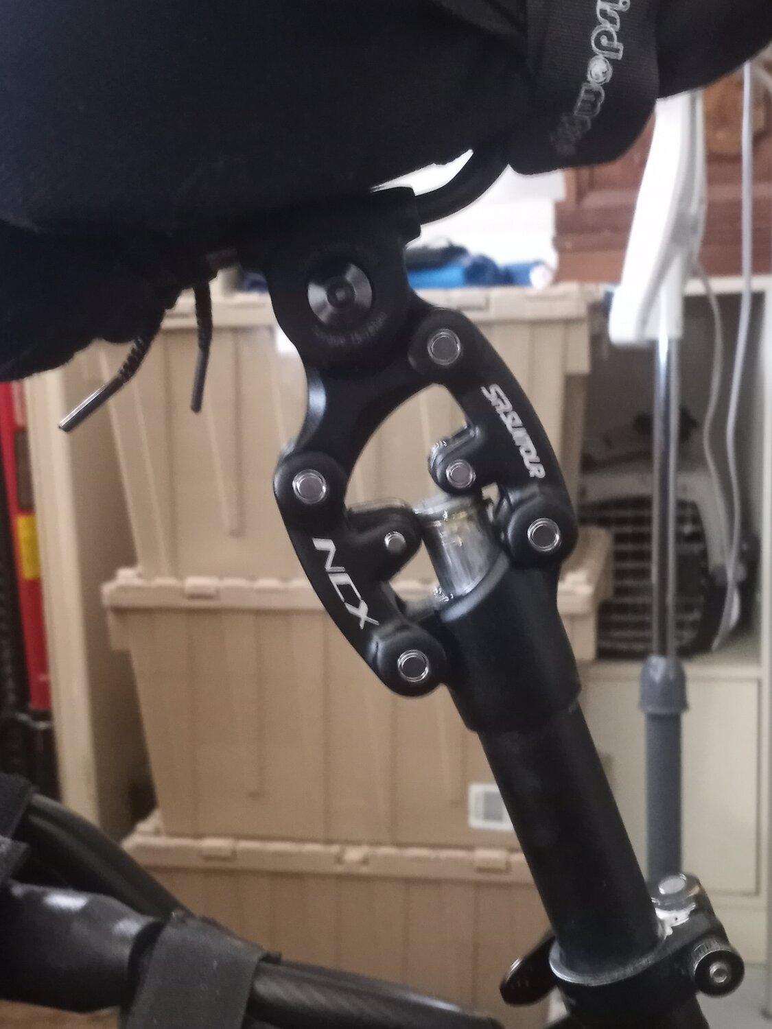

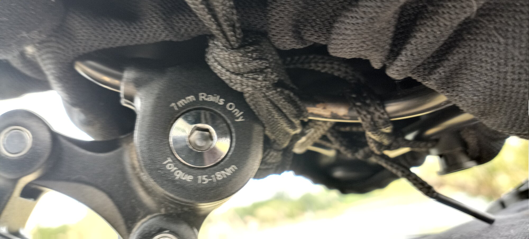

,..And you'd want to move the saddle forward on its rails in the mount. I'll bet its pretty far back right now. Don't do that if you did :)
I moved my seat as far forward as it would go on the rails (about ¾") but I didn't notice any difference in my posture or how it felt.
I had purposely moved the seat back to try to get more torque on the spring mechanism to get more movement out of suspension post.
I know what you mean about bottoming out the suspension on the Suntour seat post. As the suspension compresses, it rotates the seat back putting more torque/pressure on the spring, and it compresses easier and faster where it could bottom out.
(It works kinda the opposite of progressive suspension)
On the other hand when I adjust the tilt angle of the seat, the difference is Really noticeable.
I wish that I could adjust the tilt by half notches.

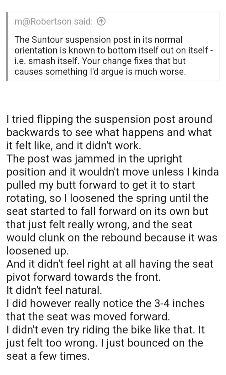

I tried flipping the suspension post around backwards to see what happens and what it felt like, and it didn't work.
The post was jammed in the upright position and it wouldn't move unless I kinda pulled my butt forward to get it to start rotating, so I loosened the spring until the seat started to fall forward on its own but that just felt really wrong, and the seat would clunk on the rebound because it was loosened up.
And it didn't feel right at all having the seat pivot forward towards the front.
It didn't feel natural.
I did however really notice the 3-4 inches that the seat was moved forward.
I didn't even try riding the bike like that. It just felt too wrong. I just bounced on the seat a few times.
The stem extenders work really well and don't look as goofy as high rise bars imo.

I flipped my whole damn seat post!!
No wonder it didn't work.
I will flip just the top part of my seat post. Duhhh... 😂
I got my seat post linkage turned around,..
I reinstalled it and sat on it and it felt OK.
I haven't riden the bike yet.
I'll see how much of a difference I notice.
