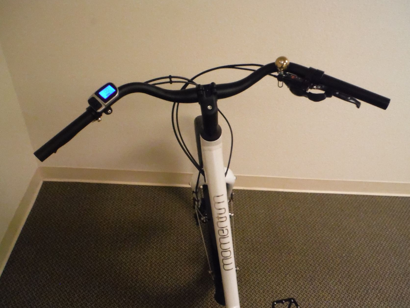

I think that, that is exactly what he is looking for, a straighter back with less HungChing and RiChing. More of a Dutch posture. Look how long the head tube is on a Dutch bike. It is about 90% as long as the fork. And see the raked back angle? She does not need to stoop. Pressure is off her hands and her elbows are slightly bent, relaxed.

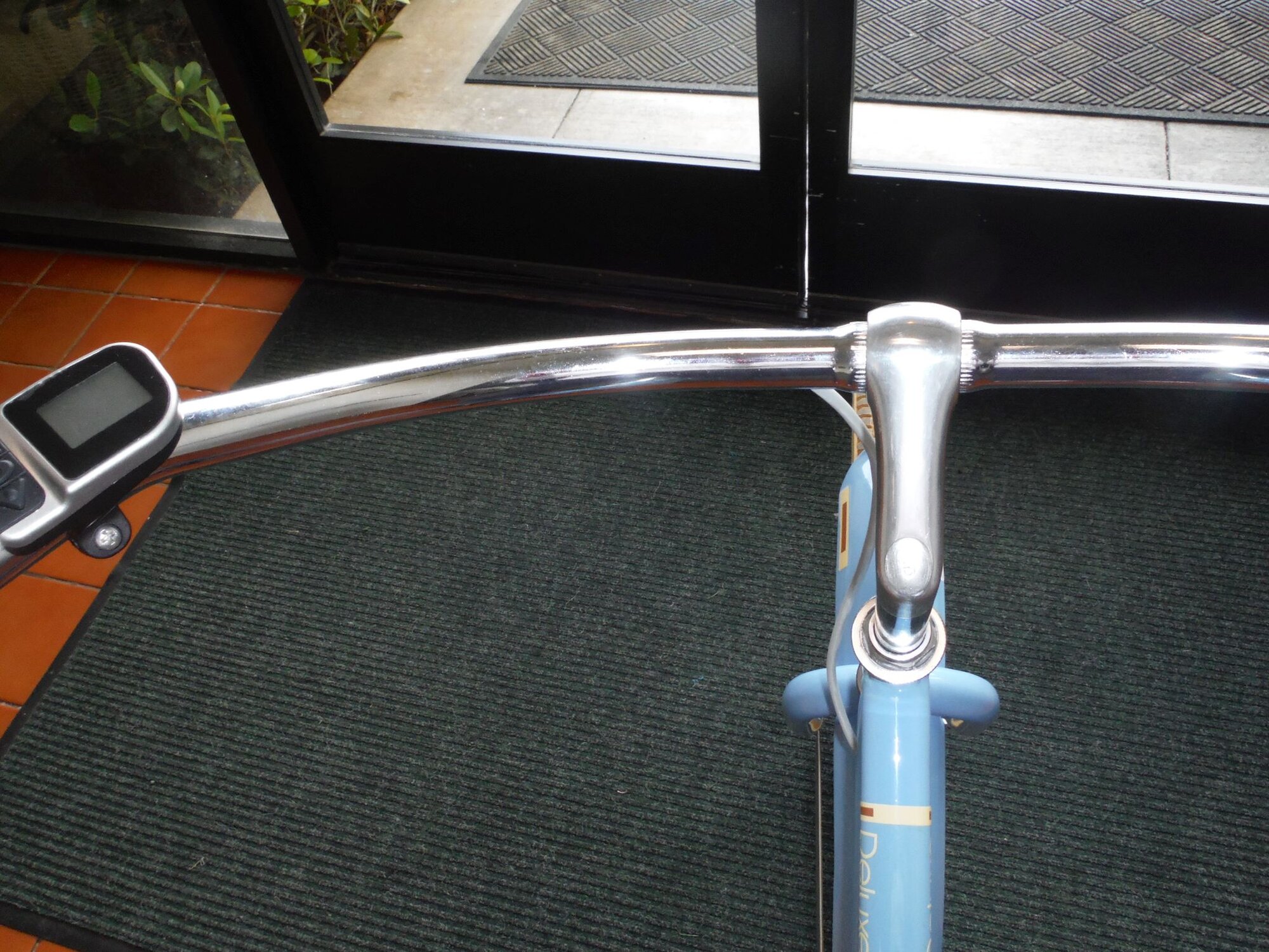

gooseneck
A 22mm gooseneck riser looks like this. It is not at all like a MTB. They can also be 'flipped' to bring the HB in, closer. Did you like the mud flaps? I thought you might like them. I just noticed that she only has one arm, which is kind of strange. I like the one where she is reading a book and has two arms.

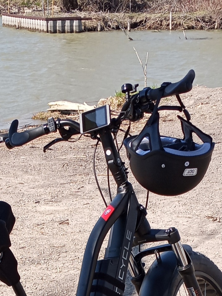

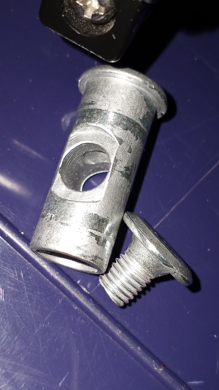

A bit of an update,..
I managed to find and stop the creaking.
It turned out that the pinch bolt wasn't tight enough.
You can see where the bolt is shiny from rubbing, caused by the twisting of the stem.
The stem had some shiny spots too, so I scuffed them out with fine sandpaper then reinstalled everything with anti-seize on the threads of the pinch bolt.
The creaking has stopped.
That was making me kinda nervous.

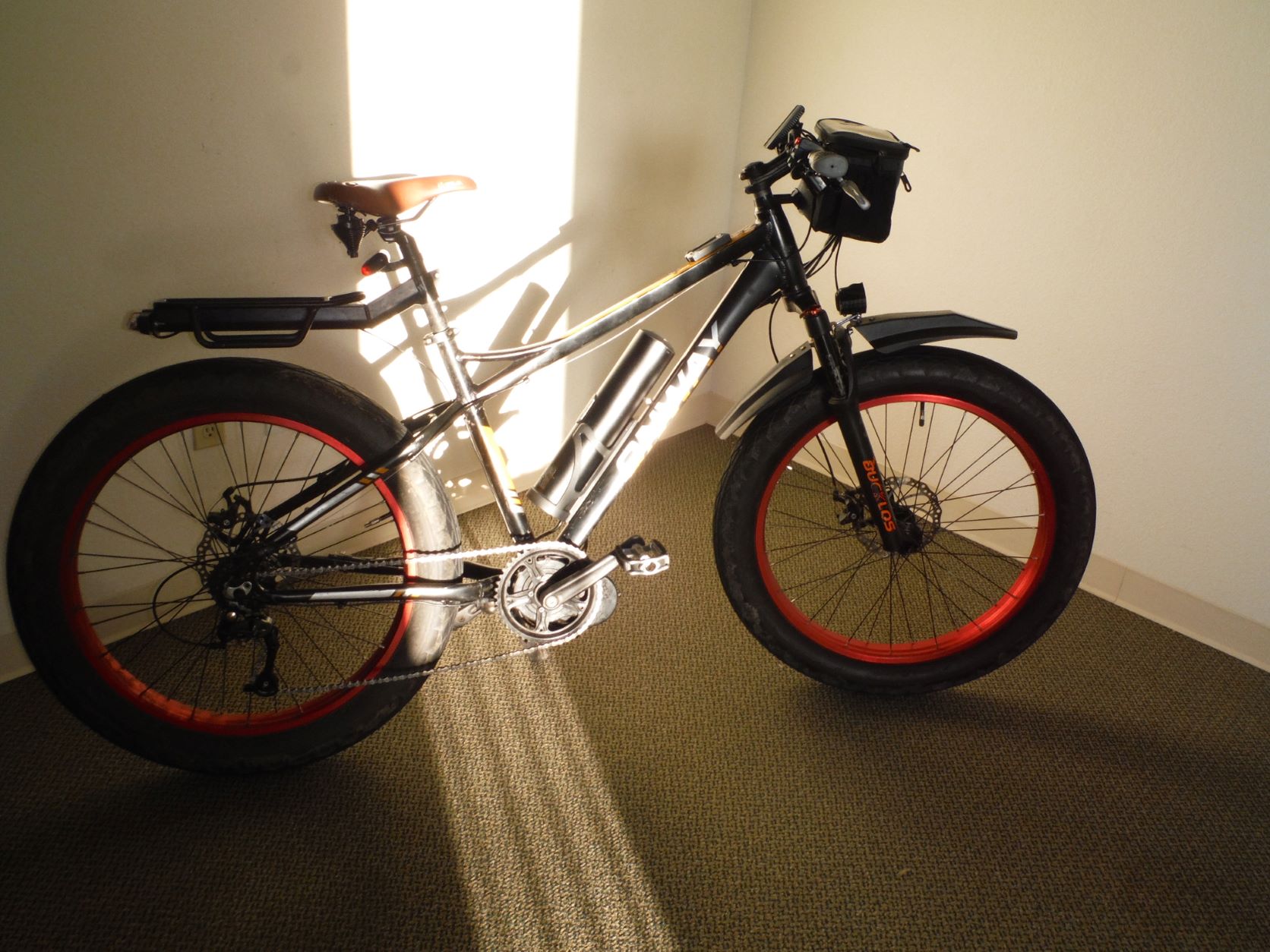

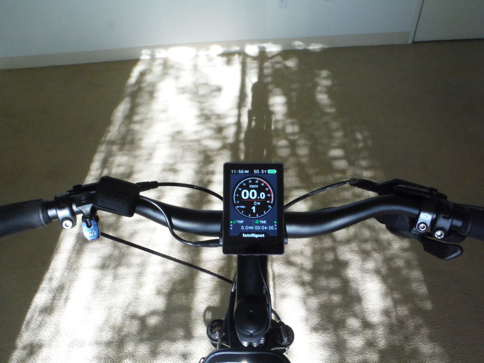

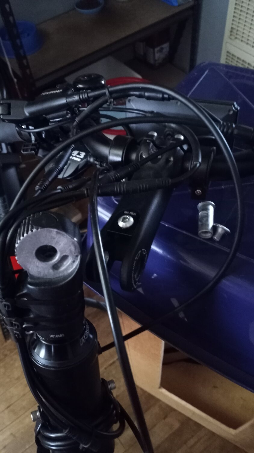

Ditch the wires and connectors. This is a Bafang build then a clean one.
I'm curious as to what you mean by that?
My bike won't run without the display and it's cable & connector. And I really don't want to do without my brake switches.
Are you suggesting deleting all this, or drilling holes in the handlebars, stem, and frame to run the wires inside, and hide all the wiring?
I've got wires all over the place and the only reason that I care is that I don't want to get hung on something and rip a wire off.
Here is a Bafang build. The weird wire to the left is the fork lockout. I deleted the extra connectors and wires to help clean it up. I am working on a one wire bike today with a coaster brake. It is getting a basket, so that wire will largely disappear. It is the final image below.

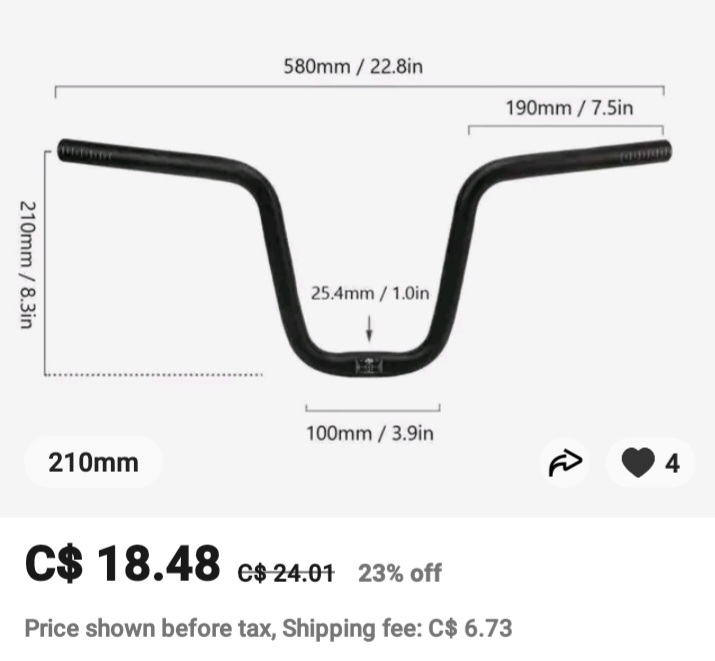

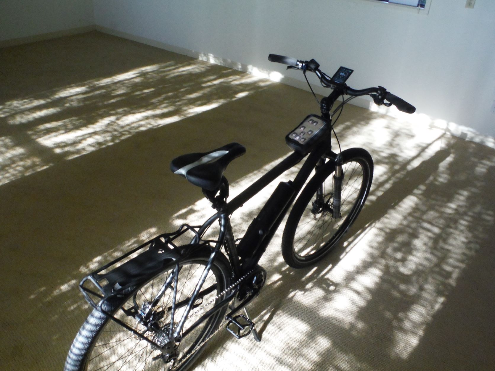

Well, the creaking started happening again, so I bought this stuff, and planned on reusing my handlebars.
But then I read this post and I changed my mind.
Riser Bars are the safer option.
So I bought this stuff instead,..
The handlebars turned out to be quite cheap. I figure because they are really common on folding ebikes.
which is the safer configuration, installing a taller gooseneck, or installing riser handlebars to raise the hand position?
I understand which is simpler to swap, but I'm having a problem with finding higher rise handlebars that leave enough space for grips, throttle, brakes etc before the bends
Hence the initial question tia
Here's a link to the handlebars that I bought.
They come in three sizes.
The handlebar ends have the same amount of space as my original handlebars, and they are 22.2 mm in diameter so everything will fit.
(A lot of handlebars that I looked at had a bigger diameter.)
Keep in mind the diameter where the stem attaches.
My original handlebars are 22.2 mm at the stem and almost all handlebars are 25.4 mm at the stem.
