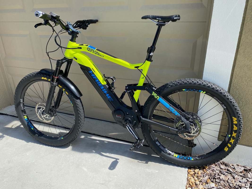

Here's the finished product. It's not been to a bike shop - I finally took the time to learn to adjust a derailleur correctly, and I set up the tubeless myself without a compressor. Changes I made:
- Maxxis Chronicle tires running tubeless
- Deity 50mm riser bars
- Ergon GP1 grips
- Specialized 75mm 24 degree stem
- WTB Saddle
- Crank Bothers Stamp pedals
- MudHugger front fender (had to order this from Europe)
- Haibike MRS adapter so I could add a bottle cage (@mikegs430 you have to order this from Europe and it takes forever to get here, then it's a bit of a pain to install)
After an endless amount of tweaking it's finally done. I think. Really enjoying it and definitely recommend it if it fits your riding needs.
Your 'Deity 50mm riser bars'-
I have the stock 780mm bars on my Haibike 10.0 Full Seven. Just curious what made you decide to opt for a riser bar? Initially, I swapped out my stem and replaced it with an adjustable with added spacers. Would I accomplish the same with the risers? Thanks! ;)
Hey Bob, yes you would accomplish the same thing. I went with riser bars and a 24 degree stem because I don't trust adjustable stems, particularly on trails, and because I personally prefer the look.
As of yesterday they are now "Deity 80mm riser bars." About to go on my first ride with them. The top (outside) of the grips is exactly 2" above the lowest part of the saddle now.
Actually, the Specialized stem I have IS in fact adjustable, at 24 degrees plus or minus 4 degrees. I have it at 28. It comes with two shims, one straight and one that has the hole cut through at an angle. One direction it's 20 degrees, and if you rotate is 180 degrees it's 28. Pretty cool actually.
