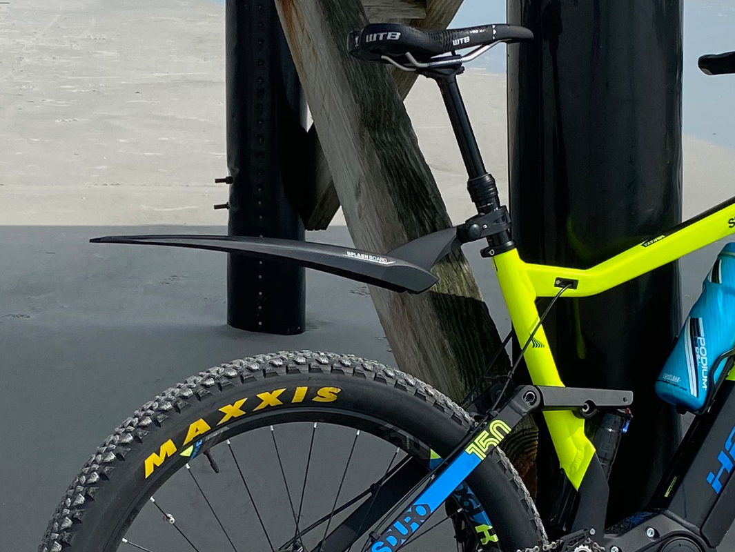

Here's the finished product. It's not been to a bike shop - I finally took the time to learn to adjust a derailleur correctly, and I set up the tubeless myself without a compressor. Changes I made:
- Maxxis Chronicle tires running tubeless
- Deity 50mm riser bars
- Ergon GP1 grips
- Specialized 75mm 24 degree stem
- WTB Saddle
- Crank Bothers Stamp pedals
- MudHugger front fender (had to order this from Europe)
- Haibike MRS adapter so I could add a bottle cage (@mikegs430 you have to order this from Europe and it takes forever to get here, then it's a bit of a pain to install)
After an endless amount of tweaking it's finally done. I think. Really enjoying it and definitely recommend it if it fits your riding needs.

That little front fender doesn't help much does it? Considering the stripe up the back you will get. LOL

Yeah the fender is small but does exactly what I need it to - protects the top of the forks, the bars, shifter, brake levers, display etc. Most importantly though it keeps water and mud out of my face and off the top of my body.
And no stripe! I also have a solution for that, which worked well for sand on the beach yesterday:
