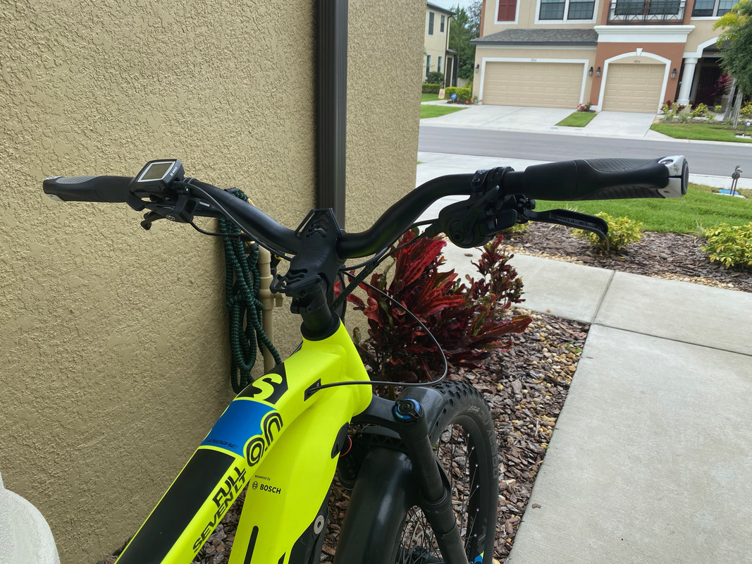

Hey Dan-Hey Bob, yes you would accomplish the same thing. I went with riser bars and a 24 degree stem because I don't trust adjustable stems, particularly on trails, and because I personally prefer the look.
As of yesterday they are now "Deity 80mm riser bars." About to go on my first ride with them. The top (outside) of the grips is exactly 2" above the lowest part of the saddle now.
Actually, the Specialized stem I have IS in fact adjustable, at 24 degrees plus or minus 4 degrees. I have it at 28. It comes with two shims, one straight and one that has the hole cut through at an angle. One direction it's 20 degrees, and if you rotate is 180 degrees it's 28. Pretty cool actually.
Great! Nice custom setup you have going on there. Ergon grips, etc. I usually stick with what comes stock on the bike, then I slowly swap out and then customize from there as I see fit. So many mfgs out there for riser bars. Looks like those fit to the components on the bike nicely. I was also considering cutting down my bars to 760mm for a more trail friendly setup, however, I'll begin to lose the real estate on the bar setup. Decisions, decisions.
BTW-The adjustables seem to make more creaking noises with time than a standard type. Can you please leave a link to your stem so I can make a comparison? Much appreciated.
