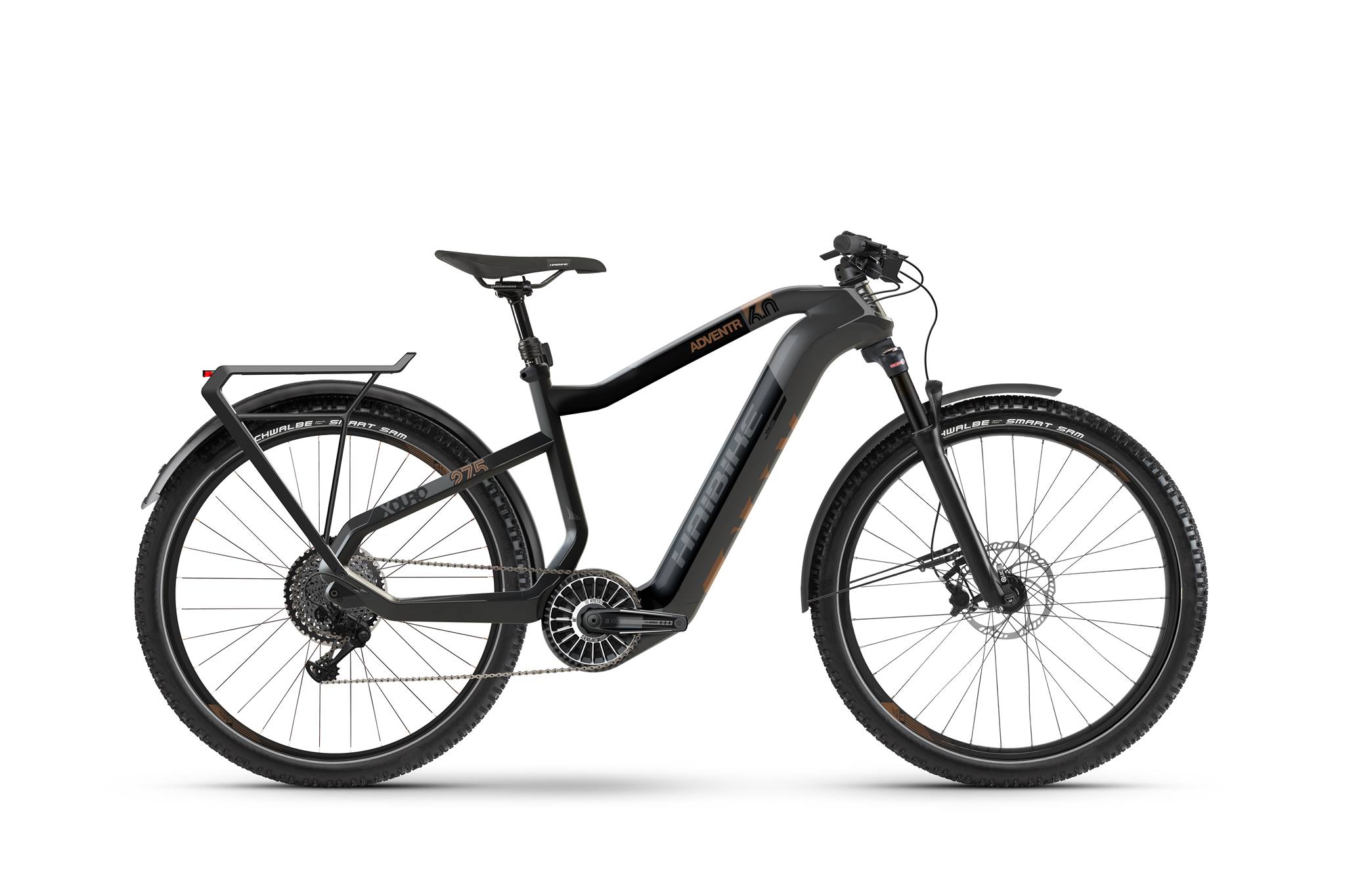

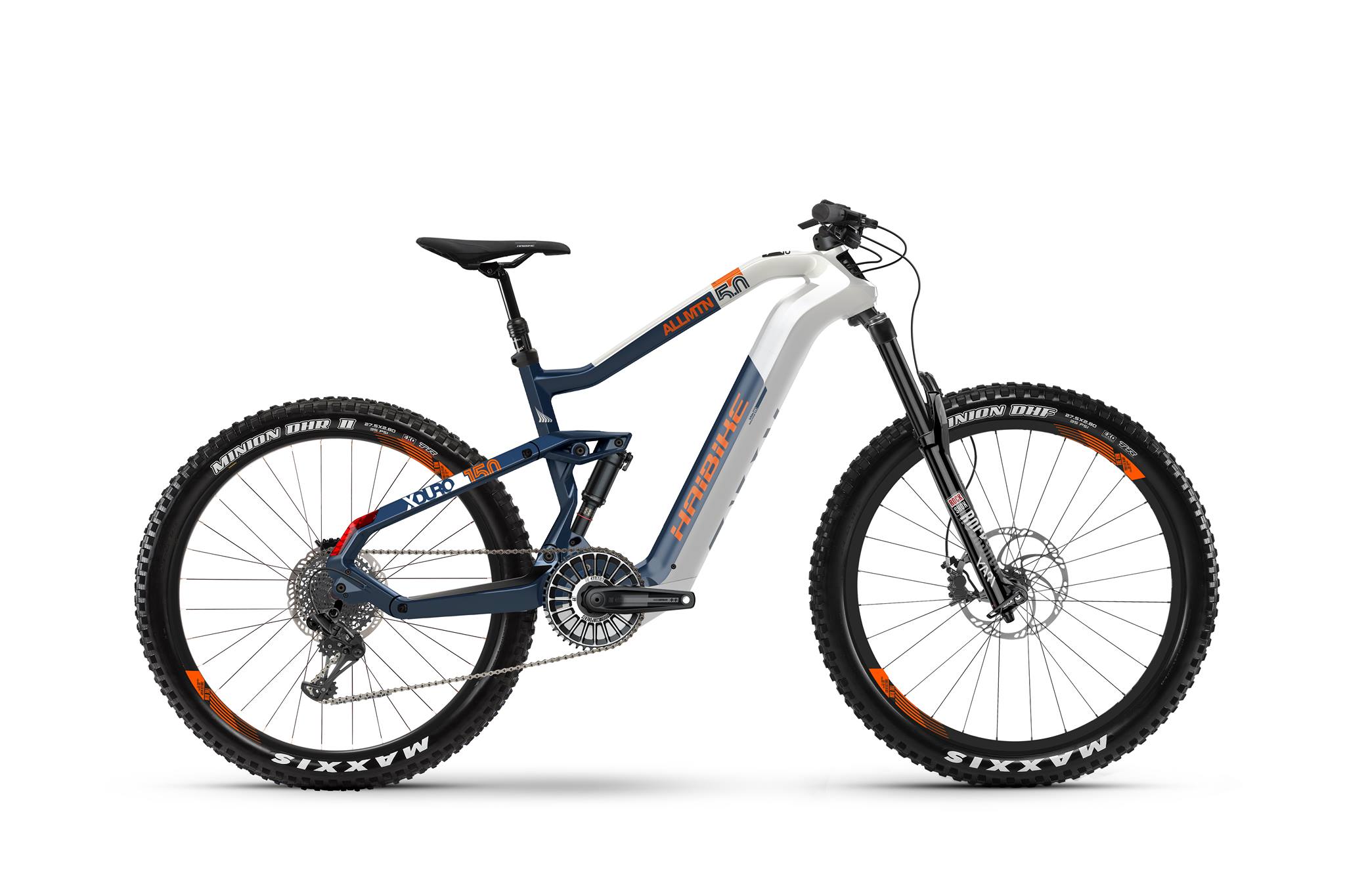

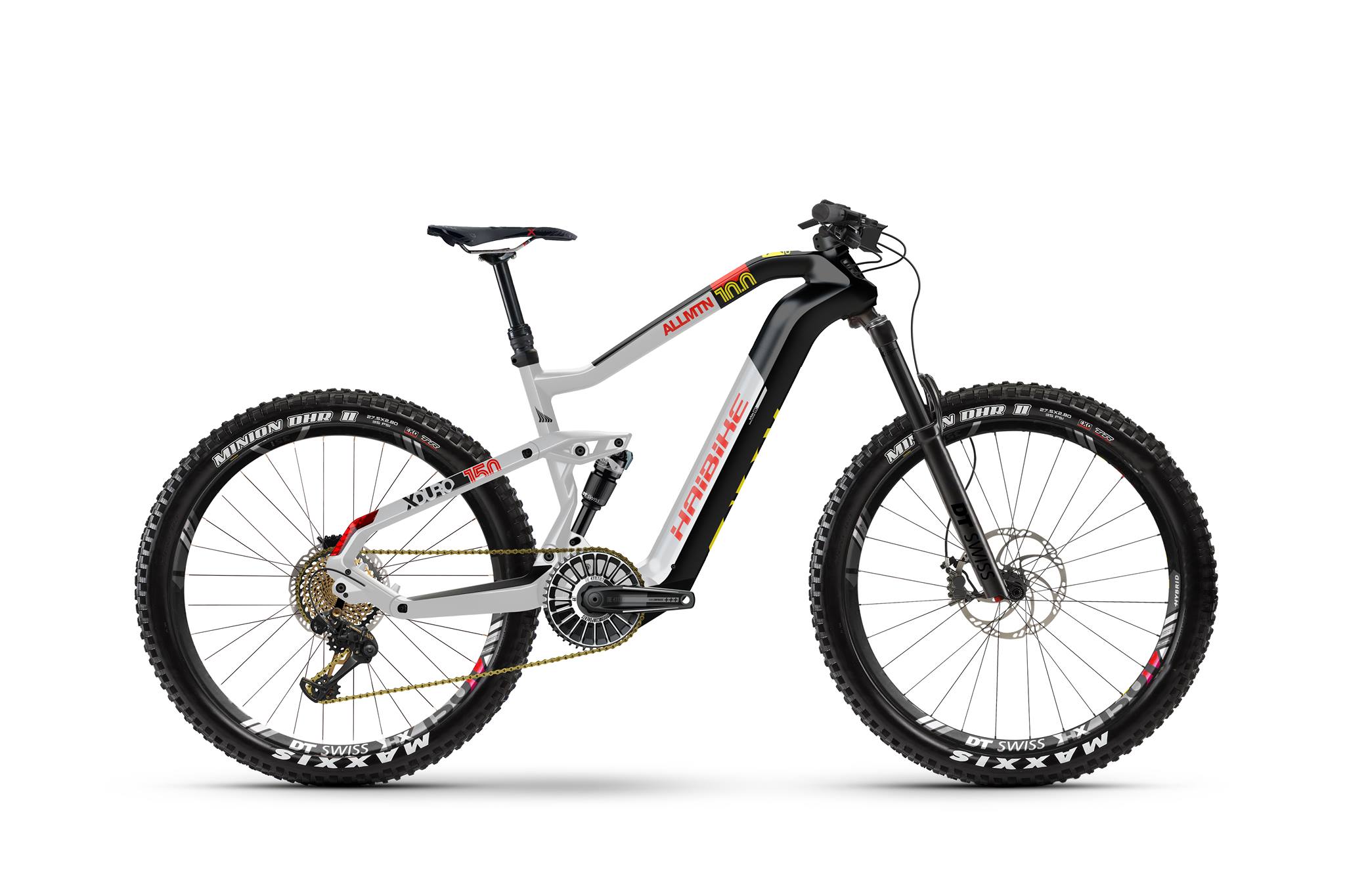

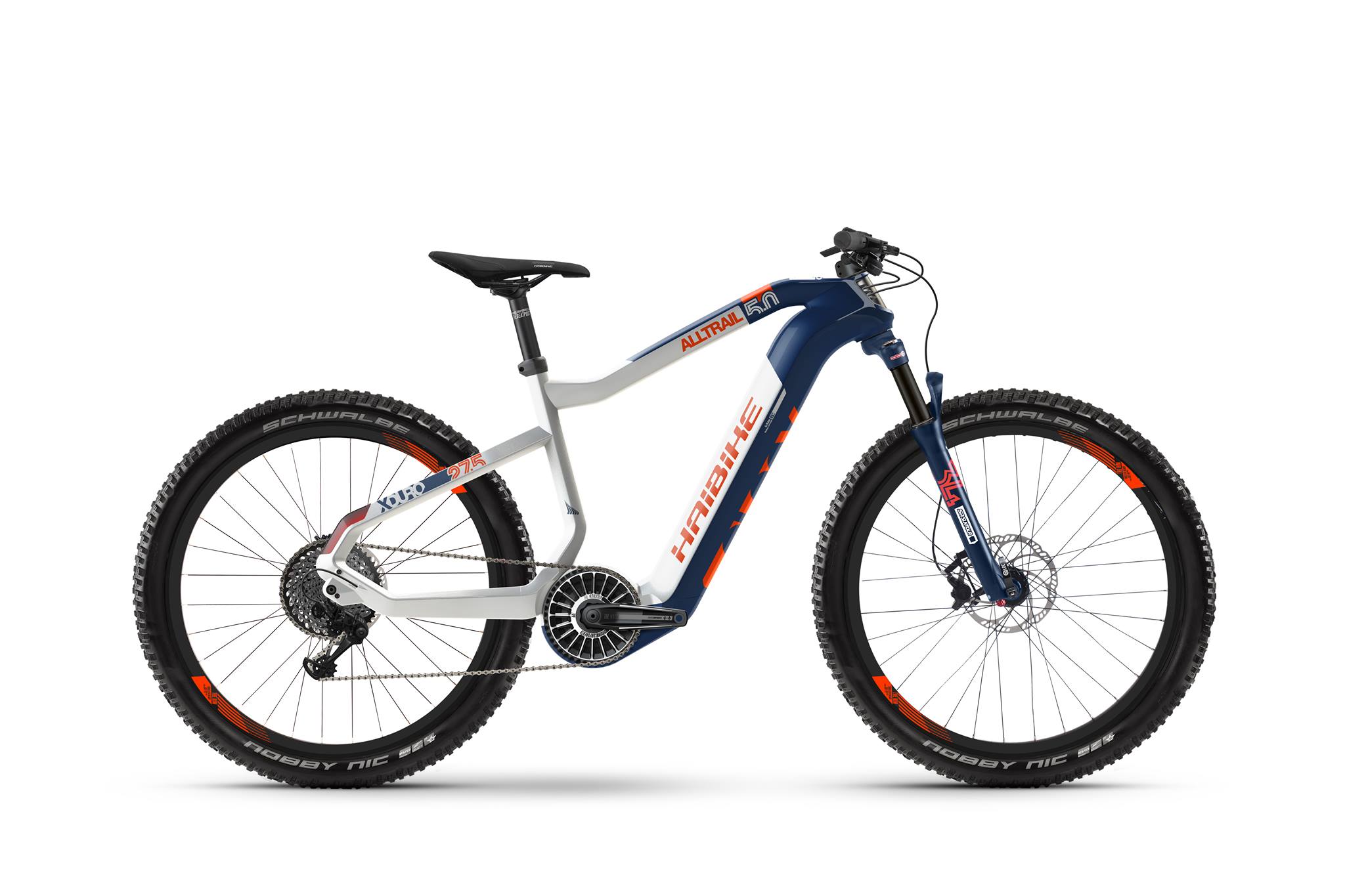

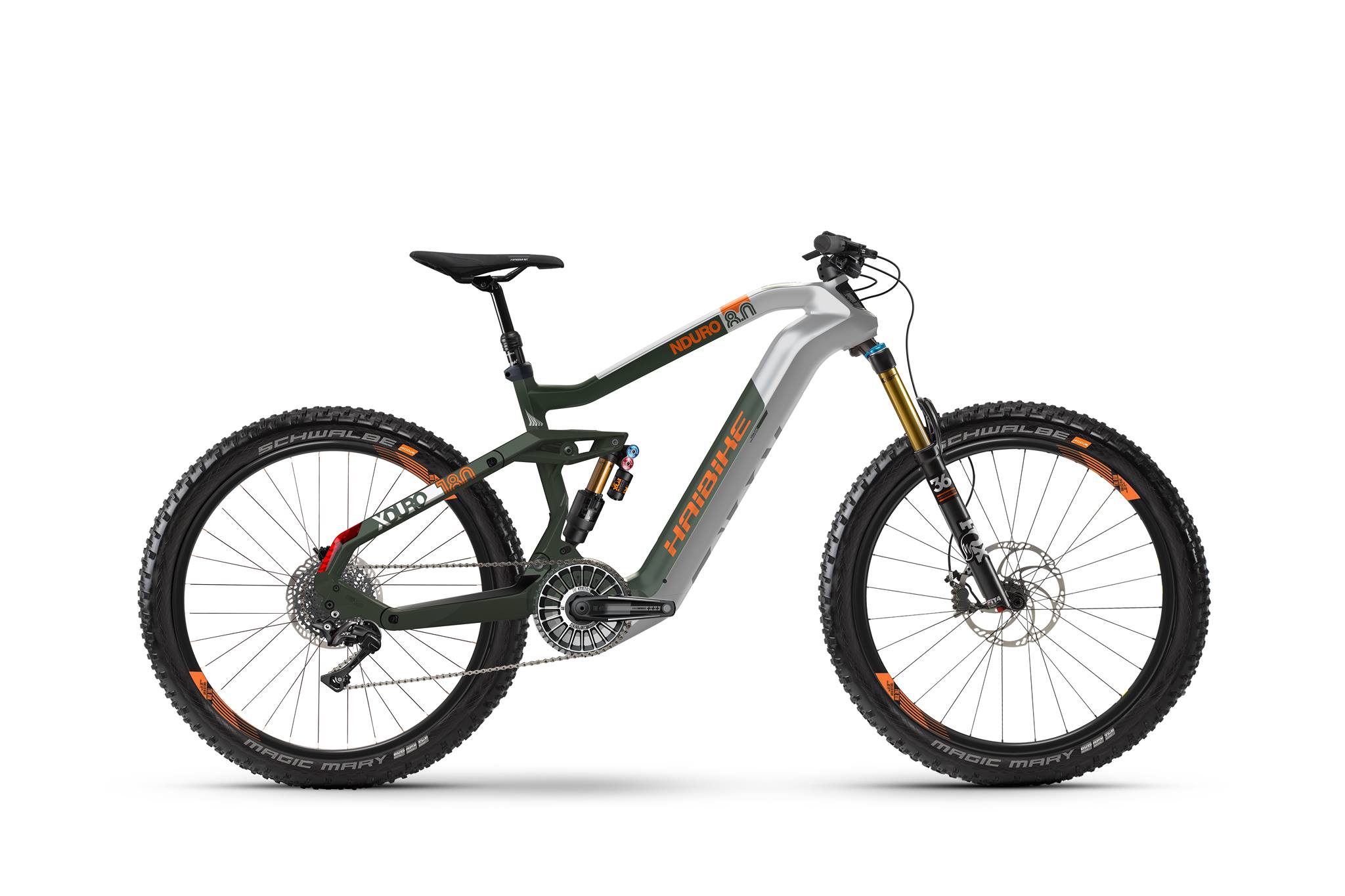

View attachment 23438View attachment 23439View attachment 23440View attachment 23441View attachment 23442
