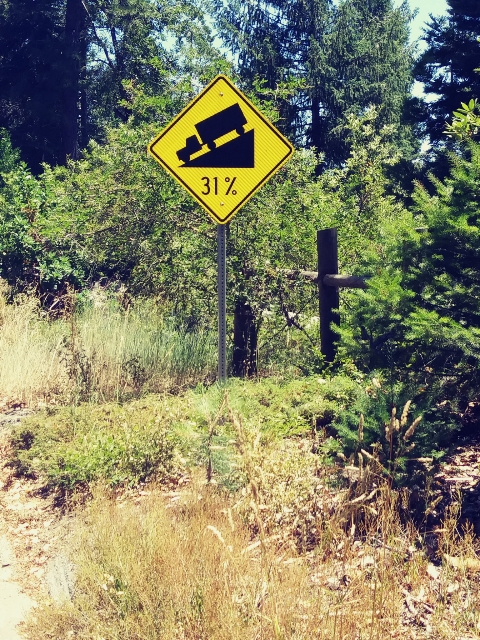

I have a 250W mid-drive ebike. The motor will develop 90Nm of torque and over 600W peak. I have climbed one hill that was signed as 31% slope (17 degrees), though it was just a short section of he hill. I was able to finish the climb, but in the lowest gear and standing on the pedals. I wouldn't do this daily and I wouldn't try anything steeper, certainly not 45 degrees.

Let's all be nice, but I respectively disagree. The rider is going to have a challenge on the OP's city hills of 30-45 degrees (58% to 100%) slopes with either motor discussed in the OP's original post based as I mentioned in #2 above based both on my personal experience with a mid-drive with similar torque and power to the 250W Bafang. This is confirmed in Grin's Motor Simulator as far as motor specs are available. I have used this simulator for other hub drive motors that I installed in DIY conversions with performance results that closely matched the simulator's calcs.
