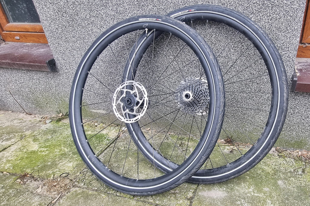

Gravel cyclists seem to be picky about the tyres they use for their bikes. Panaracer Gravel King, Schwalbe G-One, Maxxis Rambler seem to be popular choices.
I consider a purchase of Specialized Pathfinder Pro 2Bliss Ready. Yes, I know these are intended for tubeless use. The rims in my Vado SL are not tubeless ready. Does anybody of you ride Pathfinders? Experiences? I need tyres that are very fast on the pavement but would handle even pretty harsh terrain and loose gravel. And, of course, be supple.

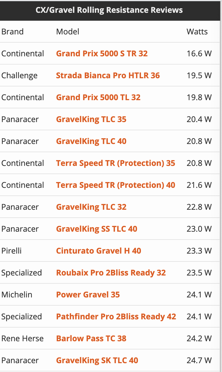

bicyclerollingresistance.com is a good source for tire rolling resistance.
Here's a list, in order of Watts consumed, for some of the tires with the least rolling resistance:

Thank you very much for sharing your thoughts!

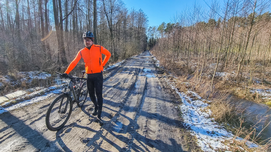

"Gravel cycling" means Pavement, Gravel, Dirt. Gravel cyclists are expected to ride very fast on the pavement and be able to maintain traction even under muddy conditions off-road.

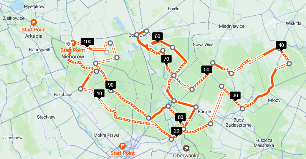

A typical racing route for gravel cyclists where I live: 100 km, 31% paved, 45% dirt, 24% gravel.
And the conditions are harsh.

I decided to go back to Nimbus. Why let good tyres go to waste? I ride Vado SL mostly on the pavement, and the speed loss is vital there. I hope I won't crash on my gravel rides!
