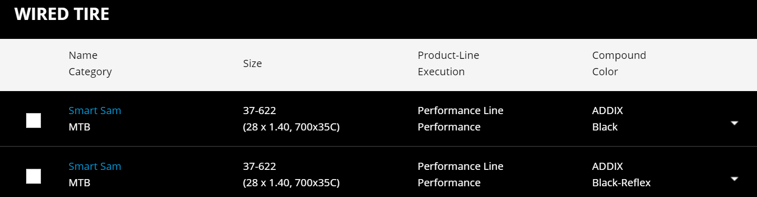

wrt tyres, which ones are they,
- Schwalbe Smart Sam Plus DD GreenGuard SnakeSkin Addix Wired 29" Tyre
- Schwalbe Smart Sam Plus DD GreenGuard SnakeSkin Addix Wired 700c Hybrid Tyre
Either of these:
Just Smart Sam, size 37-622 or 28x1.40" or 700x35C. These two options only differ with a reflective strip (Black-Reflex). Any other variation of Smart Sam is not what I'm talking about.
