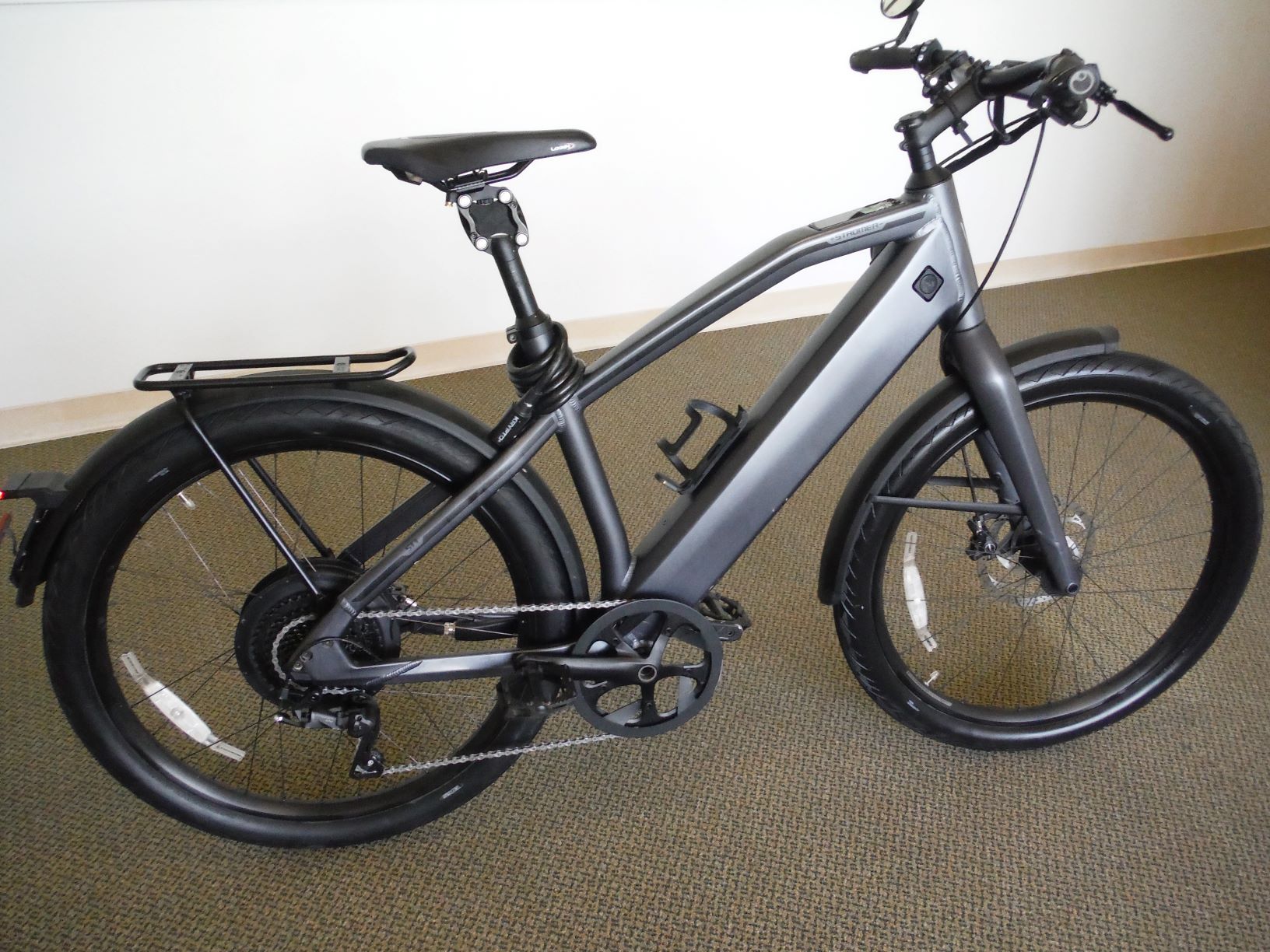

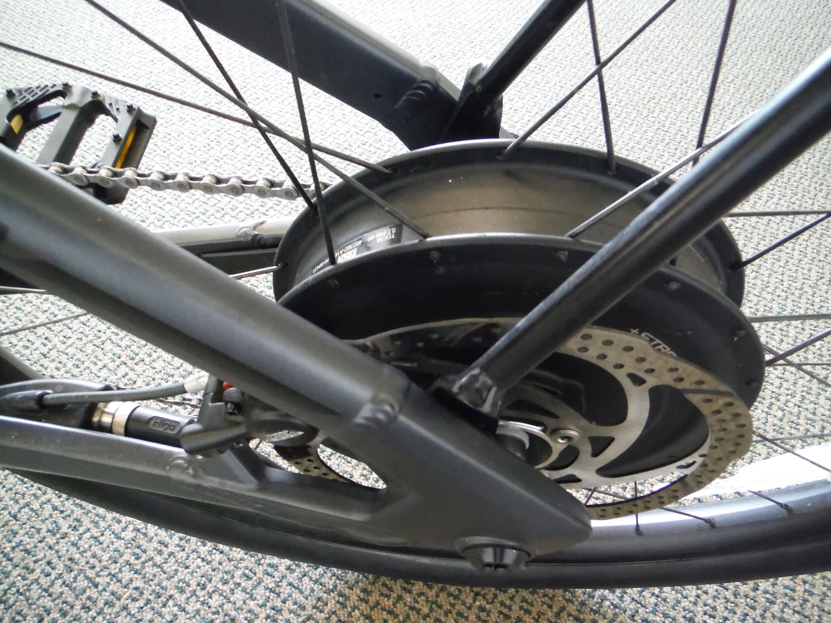

A super premium custom made battery with the best cells and with the very best battery management chips - that is not proprietary but works across bikes - costs around $420 shipped. I have seen people pay $600 plus shipping for a 260Wh 'range extender.' What a rip. One Stromer guy killed his fully charged bike with a 12 mile ride into a headwind. When he departed it said he had a some astronomical range. I had to rescue the guy because what he had was a clunky, heavy hub-drive, and those can't do those sorts of tricks. They die.
