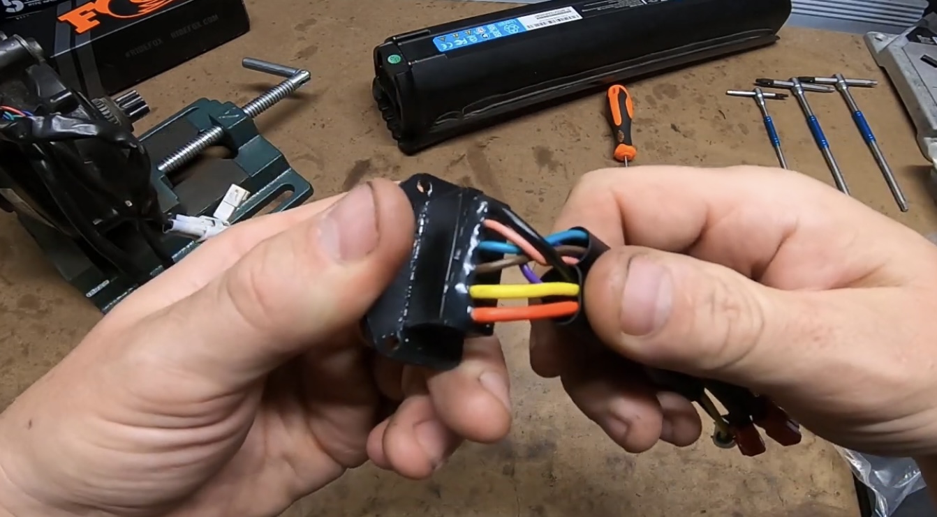

Another long wait, but the guys there are great and extremely thorough. This time they discovered that the Motor to Battery Cable had a fault, another couple of weeks wait for a replacement part and fit. Specifically the fault appears to be in the back of the battery connector where the wires enter the battery terminal fitting, it appears that it is not uncommon for moisture to penetrate this area and corrosion to form. They had another bike with a similar problem in the shop and it was fizzing in this area. They said that on this other bike it looked like the back of the connector where the wires enter the rubber had been dumped in salt water.
Since this connector & loom was replaced I've had no further issue.
I should have said, that in this picture a UK owner who has had the same battery connector issue has sealed up the wires on the loom where they enter the rubber on the back of the battery connector as a precaution. Once my bike is out of warranty next year, this will be on my "to-do" list.

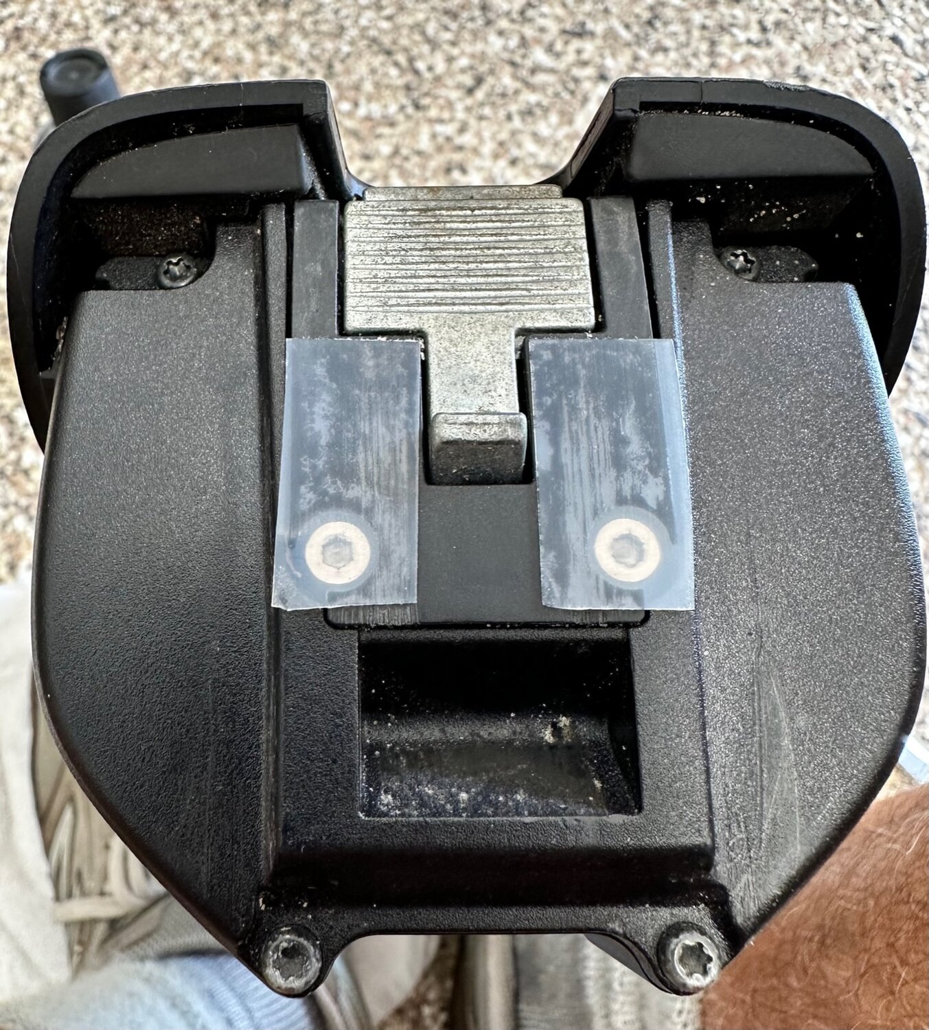

I just found a fix that worked for me. The problem had been getting worse with time, shutting down more frequently. Had gotten to the point of not being useable. I cut two squares of UHMW and applied them to the top of the battery (see picture). Problem stopped immediately and I have ridden the bike 3 times since, about 50 miles including some very bumpy dirt trails.
I do believe the battery's firmware is too sensitive to momentary disconnects and I'd like to get my battery flashed, but too much of a hassle dealing with Giant. I'm not going to mess with that unless the problem returns.
