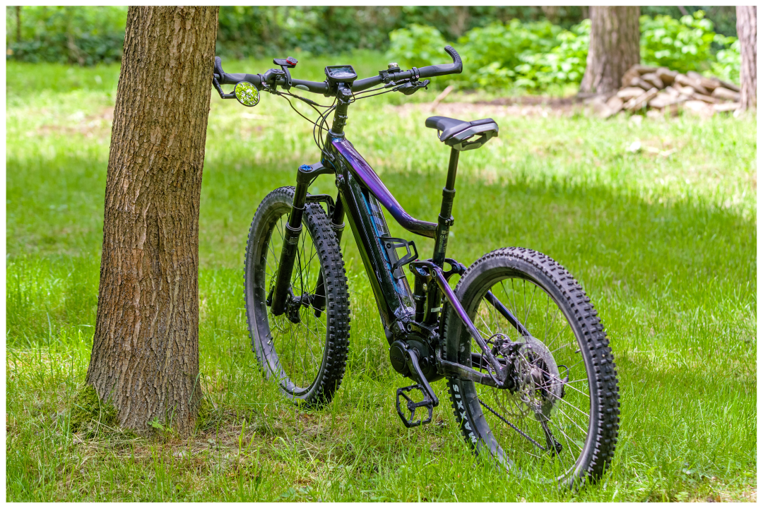

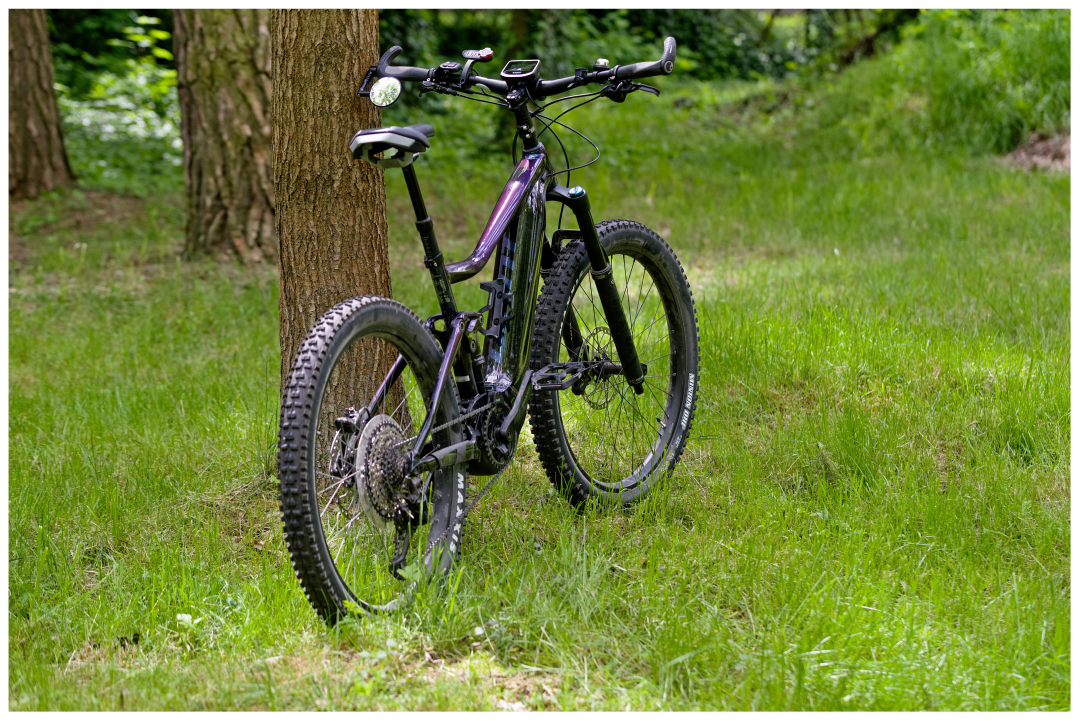

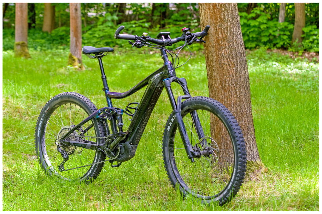

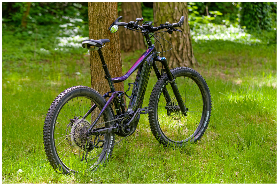

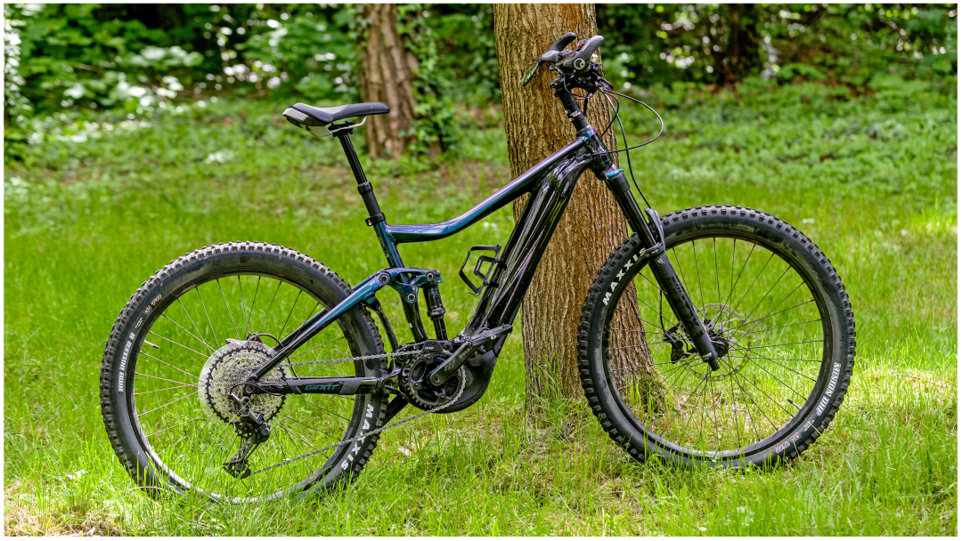

I must admit I could not see a Giant e-bike in my stable in the past because...
...there are no Giant S-Pedelecs available in my country, Poland. Initially, I was in search of e-bikes that could easily and without de-restricting ride beyond the EU 25 km/h pedal-assistance limit, and actually I found two such e-bikes. As an inhabitant of the flatland, I had no need or desire to look for an e-MTB, and all of them are the 25 km/h ones. As a technology fan, I loved reading about and watching videos on the e-MTB though. It was a two-week "fast" during which my two e-bikes were stuck in different workshops for upgrade and/or service. And then I thought "why don't you find a full suspension e-bike for yourself?"
I was in a quest for Specialized Turbo Levo, and I could say -- to my luck -- none were available. It was @Browneye here who inspired me to look to the Giant Trance E+ 2 Pro; the guy went through all the LBS in the Orange County in a quest to find the dream e-MTB for himself. If it was for Chris to buy that Giant e-bike and he was so happy with it, why not I? It was @PDoz who had inspired Browneye in turn :D An Ozzie, a Californian, now a Pole, hah.
Then I believed in Giant and their e-MTBs. Giant has a tremendous, strong, and capable network of LBS, standing for the customer and creating loyal base of users. SyncDrive (or, Yamaha) motors are perceived as powerful, durable, and they break very rarely. Yes, same as every brand they have their ups and downs. The new RideControl One remote is modern, minimalist and requires the RideControl App to get the max from your Giant e-bike. Unluckily, the Giant app is a cr@pp, and the first thing I did to my Trance E+ 2 Pro was downgrading it to the 2020 RideControl Evo display. I'm extremely happy now.
What a beauty of a bike! Delightful Cameleon painting. The geometry meticulously designed, high-end components, extremely powerful yet battery-saving electronics. A small detail says everything about the skill of Giant engineers: The way the battery is integrated in the frame. You turn the key in the lock; pull a small latch and the battery gently slides into your hands. You replace the battery and it clicks in the frame so fast and smoothly you've hardly noticed it was already done! Yes, this, and every and single component is so well thought in this e-bike. The range is so big I don't need to buy a spare batttery.
My brethren were trying to convince me to make some upgrades: "Add mudguards" -- "No, it won't be done; every detail of this e-bike is so well-thought I don't wanna to spoil this perfection!"
I've been already in the hilly country with my Trance a.k.a. Monster. I rode single track, downhill, a 45 degree slab, sand, cobblestone. I don't want another e-MTB! I'm in love with the Monster!
Someone could have asked "What do you need an e-MTB for in the flatland?" -- "Because I've always liked the idea of riding off-road, and yes, there is a lot of off-road here in Mazovia!" :)
Share your experiences with Giant e-bikes of different flavours! Let us make a community, The User Club!

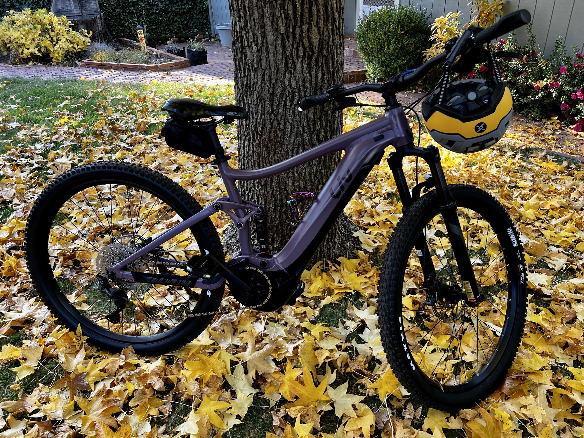

Nice to find a forum of people with a Giant/liv eBikes. Not many out there.
I bought a Liv Embolden e+2 in November of 2022. I love this bike. i’ve had others..
Bolton, Aventon, Lectric .. nothing compares to my Liv.
