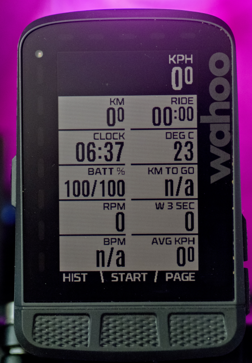

With Bolt v2, the e-bike is identified by "E-Bike" sensor. With Roam, you can see the "traditional" e-bike sensors in addition to the "E-Bike" but you do not need to use them (it would be counter-productive and confusing). For both computers, equipping a traditional bike with separate sensors allows using any of the sensors (or all) in more traditional way. No sensors? Wahoo becomes a traditional bike computer.
Wahoo ELEMNT is relatively a new thing and the software is neat and clean. I would say the brand did their homework in relation to e-bikes.

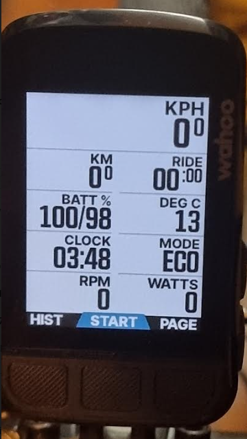

One of versions of my Wahoo Roam configuration, the Workout page. Range Extender charge level is shown separately from the main battery.
The current configuration of the Workout page of my Bolt v2.

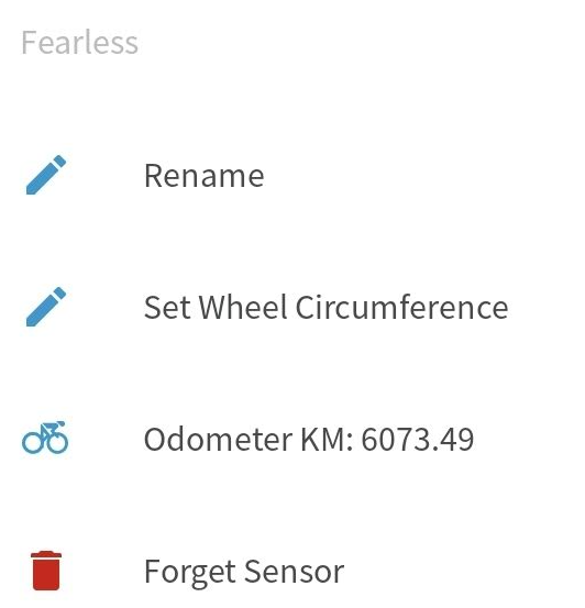

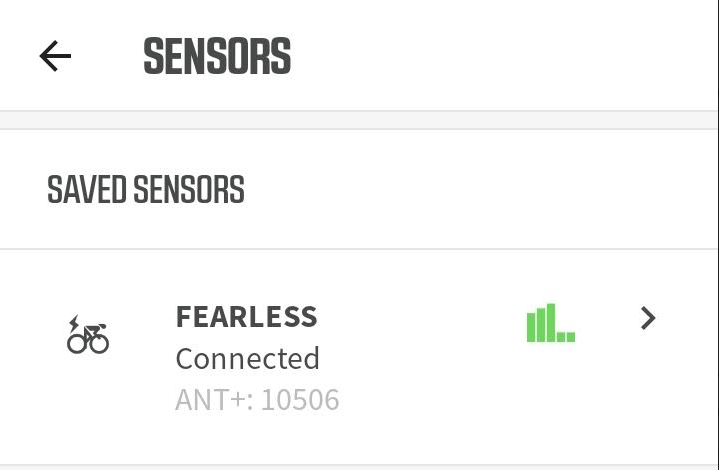

Wahoo does not need using other sensors than the "E-Bike". My configuration for Roam includes three e-bikes (two Specialized, and one Giant) and a HR monitor.
Where has the Odometer information come from? :)

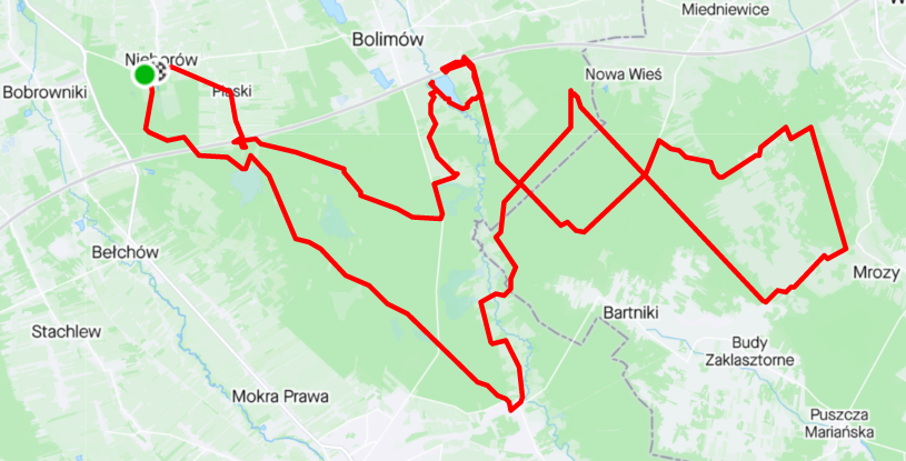

I often ride gravel with cycling clubs. Everyone sane in the group has a bike GPS running with the same GPX course file; it would not be possible to follow the group in the case of losing the contact with other people, which is a norm.
February 12th, 2022. A big group gravel ride. The group broke soon into solo riders and very small groups. It would not be possible to make the ride without GPS navigation.
March 5th, 2022. Another big group ride. The group has completely split, and strong riders found themselves far forward. I was following the course, and to my big surprise, I caught up with the leaders somewhere in the forest.
