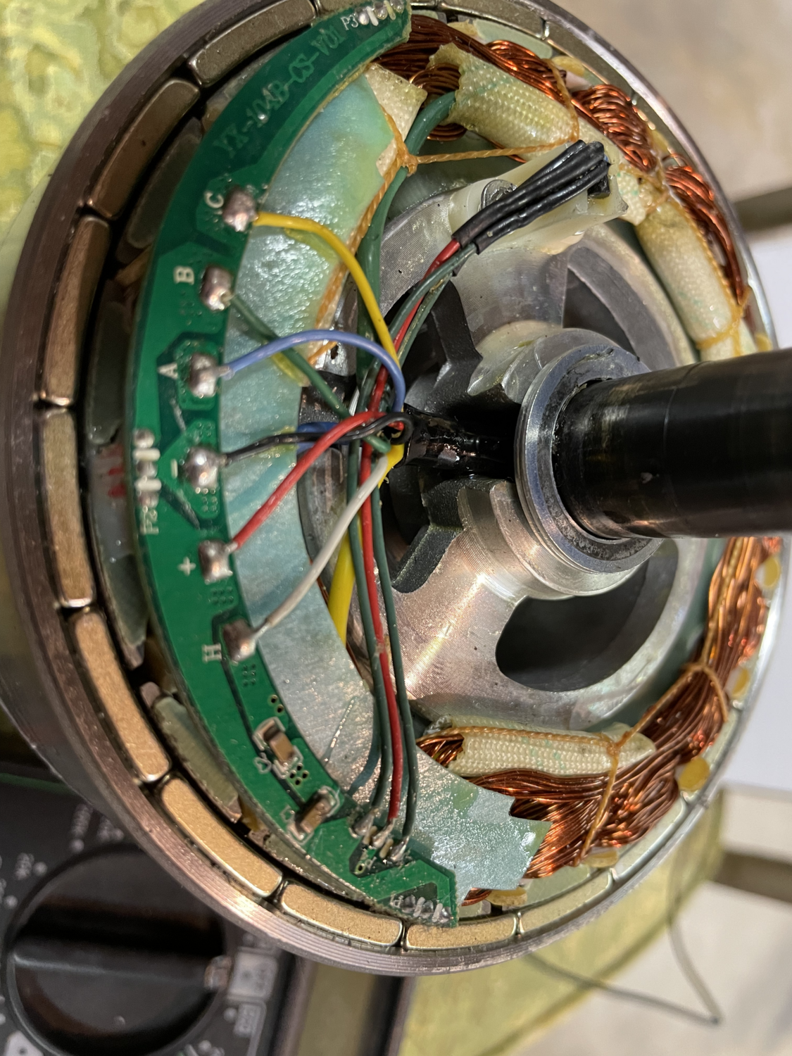

Ok, so I finally got around to cleaning my shop and then tearing into my Ecotric's motor/hub. I'm currently doing continuity testing on all the wires leading into the hub and so far the results are rather strange so I'm looking for some help. The attached image is what I have.
Can anyone even tell me what brand of motor/hub this is, and maybe point me to some photos or diagrams? I think I have an idea of which wires are what, but my continuity test results don't correspond to what I thought I'd find. Can anyone tell me what circuit each wire is supposed to carry, especially the three wires connected to the circuit board near the bottom of the image?
