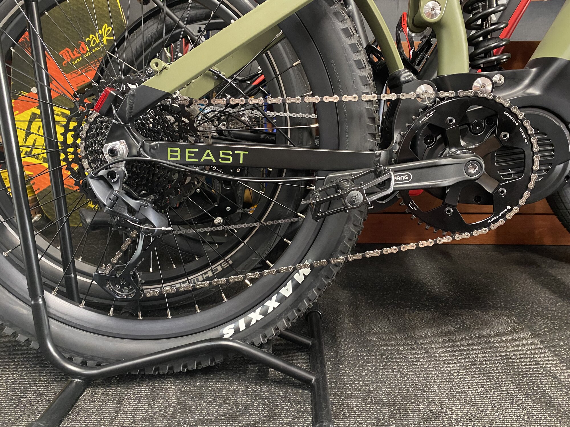

Resurrecting an old thread - I just put a replaced the factory ring on my Frey HT1000 with a wolf tooth 130x5 48 tooth ring.
  • There is very little space now between the rear fork frame and the perimeter of the teeth/chain. Probably 3/8" clearance now. I doubt a larger gear will clear it, but this is fine.
  • The new ring is thinner @ the mounting bolts and they stuck out a bit and clip the frame on rotation. Bike shop gave me shorter bolts. Still good thread engagement. Is good now.
  • The chain guide has adjustment. Is adjusted all the way out to accommodate larger diameter, is perfect.
  • Replaced the chain - old chain had 1000 miles on it. I do not know the new chain length. I can ask the shop if anyone wants to know the specifics.
Preliminary performance:
  • AWESOME!
    • I pretty much exclusively ride at assist level 1. When on level flat surface (95+% of my riding) I was nearly always in the top gear. I wanted the typical condition to not be on the extreme cog. This change moved 1-2 gears down on the rear sprocket for comparable cadence. Now typically riding in 7th @ 18-20mph vs 9th at the same speed.
    • 9th gear is @ 25-27mph at my cadence. Hard to maintain in assist level 1 without a tail-wind or decline. I think this is where I want to be.
      • For reference I am heavy (fat) @5'11"/255# but otherwise (beer) decently fit (heart/lungs/legs).
  • UNKNOWNS
    • Efficiency - I have been getting ~50 miles to a charge. (Did a little better in the FL Keys where its totally flat). Have not ridden any distance with the new setup so I don't know how this will affect range. I expect (hope) it will be same/bit better. Mechanically it should be about 1-2% better but not sure if/how that translates to manual pedaling. I don't expect much change and will not be disappointed as long as it does not decline.
Love my Frey HT1000 bike - Think the Amish guy at the bike shop was impressed too.
Just did the same to my Frey Beast. Makes better use of the grunt these motors have even in the lowest assistance level.
