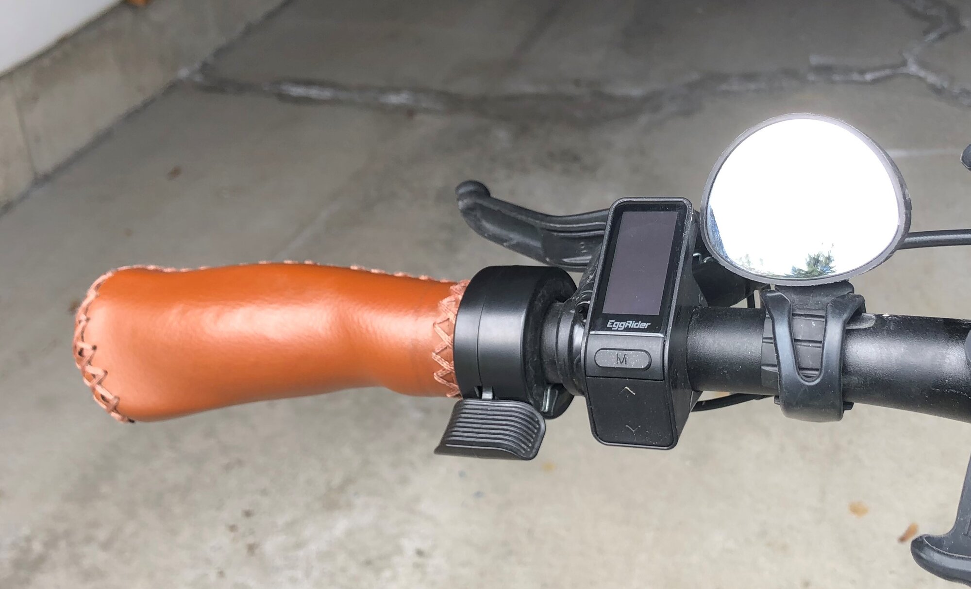

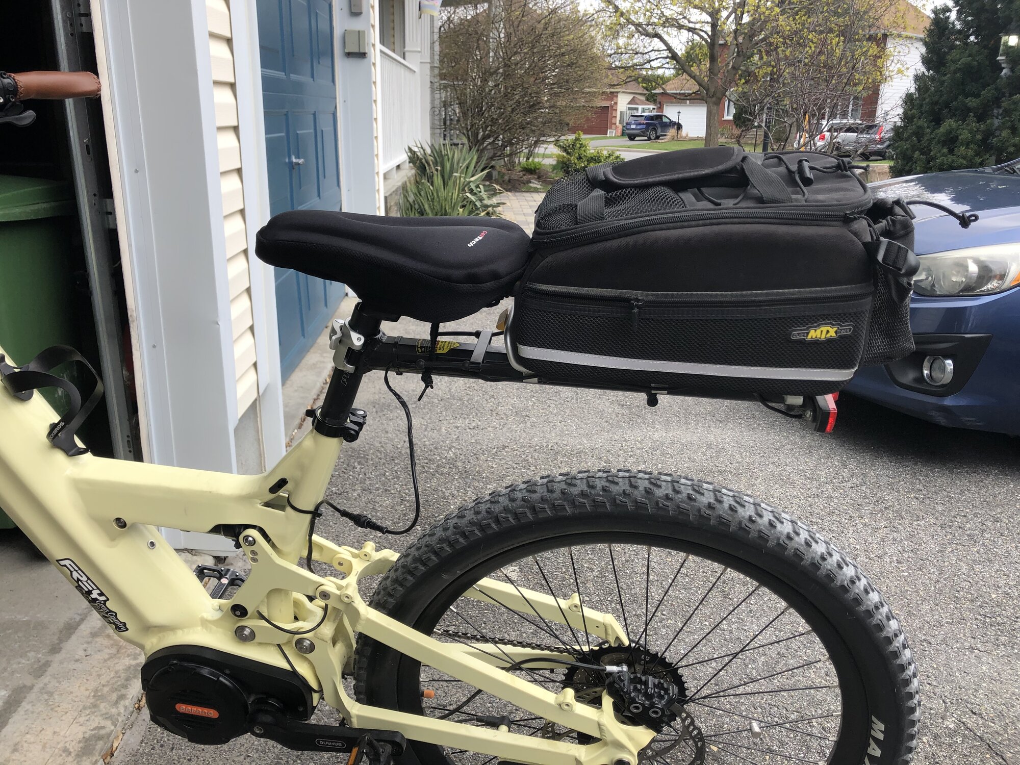

Hey Ebike Addict. I just received the identical CC as yours and have a couple of questions. What are you doing for a rear view mirror and if you cut out the end of the existing grip, how did you do it and has it remained clean and tidy. Also, I am considering that same Topeak bag setup you have. Has it been stable and do you have a dropper post? Thanks, Taylor
Hi Taylor. Congratulations on your CC; it is a great bike. After 1,500 miles, I am still just as excited to ride it as the first day. To answer your questions:
1. I was also hesitant to open a hole in the grip for a mirror attachment. So, I am using one of those smaller mirrors that you attach on your handlebar. (see picture). You can find those mirrors in any bike shop.
2. With regard to the Topeak bag, I found it very useful and stable. I don't have a dropper post. I initially installed it above the stock rack. However because of the vertical travel of the rear wheel due to the rear shock, the stock rack will sometimes hit the bottom of the Topeak rack. So I ended up removing the stock rack and transferring the rear light to the back of the Topeak rack. I am using a connector that allows me to remove the rear light wire if I need to take the Topeak rack off. (see picture).
Hope this helps!

Thanks EbikeA, Im leaning towards that same type of mirror. I also notice our display controls are different. Lastly, I have a dropper post so the Topeak may not work...
