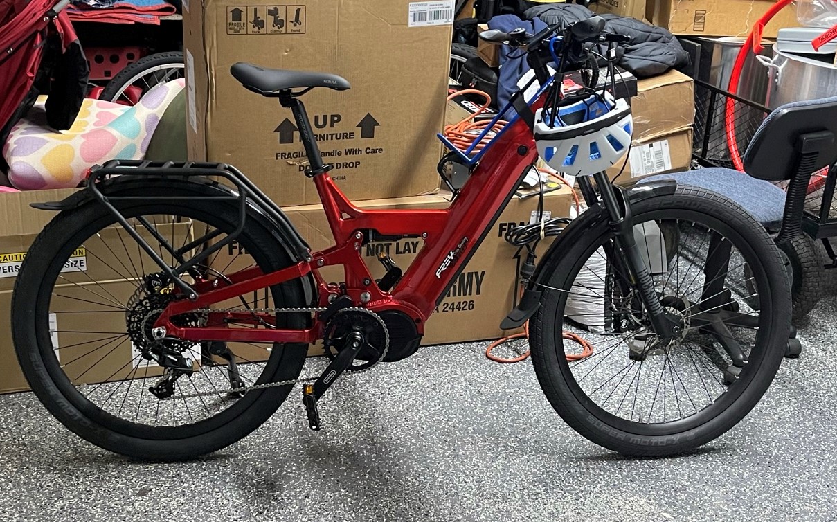

My CC arrived yesterday. FEDEX banged up the shipping pretty good and delivered it to my wife upside down. Put it together last night and found the front caliper pressure hose severed. All the fluid leaked out. No front brake :( Contacted Cecelia and she is immediately sending out the replacement. I will file a claim with Fedex as well. Took it for a ride yesterday anyway. I'm in love. Needs some tweaking and adjustment, but otherwise in perfect shape. I should have ordered a dropper post with the bike in hindsight. Does anyone know what brand and model Frey was supplying with the bike? I'm going to get one.

My CC arrived yesterday. FEDEX banged up the shipping pretty good and delivered it to my wife upside down. Put it together last night and found the front caliper pressure hose severed. All the fluid leaked out. No front brake :( Contacted Cecelia and she is immediately sending out the replacement. I will file a claim with Fedex as well. Took it for a ride yesterday anyway. I'm in love. Needs some tweaking and adjustment, but otherwise in perfect shape. I should have ordered a dropper post with the bike in hindsight. Does anyone know what brand and model Frey was supplying with the bike? I'm going to get one. View attachment 84769
