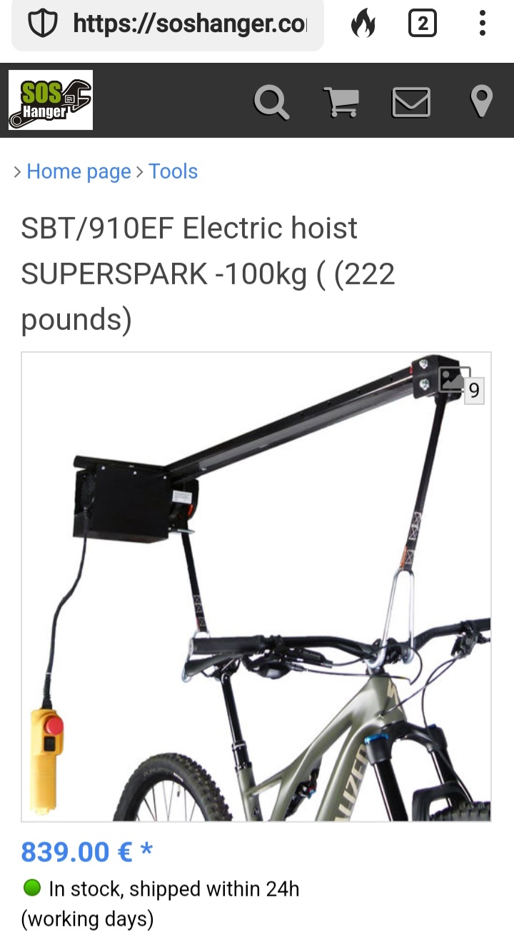

Indeed, if you've got 2 people on hand why fuss with the floor jack ballet (duh...). Neighbor's kids are young and beefy, but I'm trying to avoid becoming the needy old man, lol. Still pondering the cradle idea if lifting won't do damage. Otherwise, there's hoist install to be done. Just need to fortify garage rafters and add an attachment for chain hoist... Sigh...

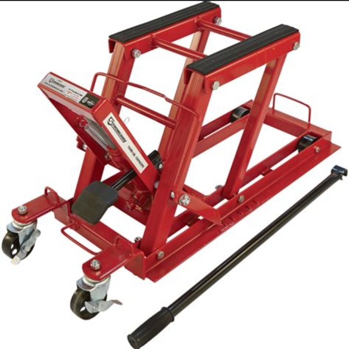

Sorry.... I was lazy in my post (search), but I did say "something similar to this"
This is more like it.
or
https://www.amazon.com/gp/product/B001EUL2DO/ref=ppx_od_dt_b_asin_title_s02?ie=UTF8&psc=1
Yeah, like this,..

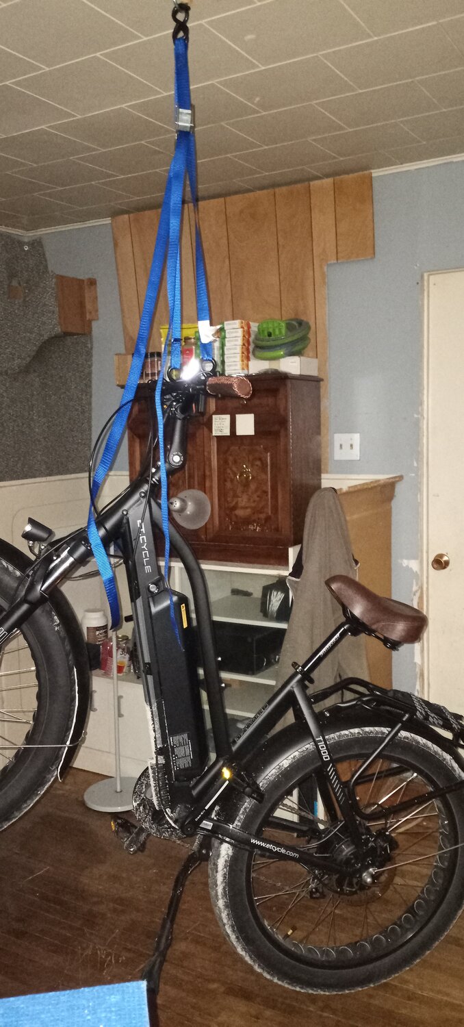

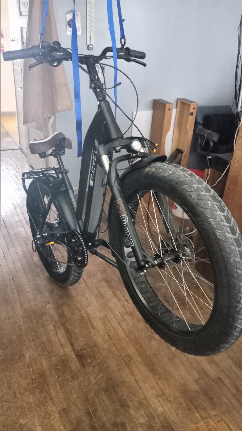

I bolted a U-bolt to the rafters above my ceiling.
A pair of tie-down straps are plenty strong enough to support my entire 70-80 pound ebike.
A strap at either end gets the whole ebike in the air
I use the "lift" mostly to get either end at a more comfortable working level, so that I don't have to bend over.
