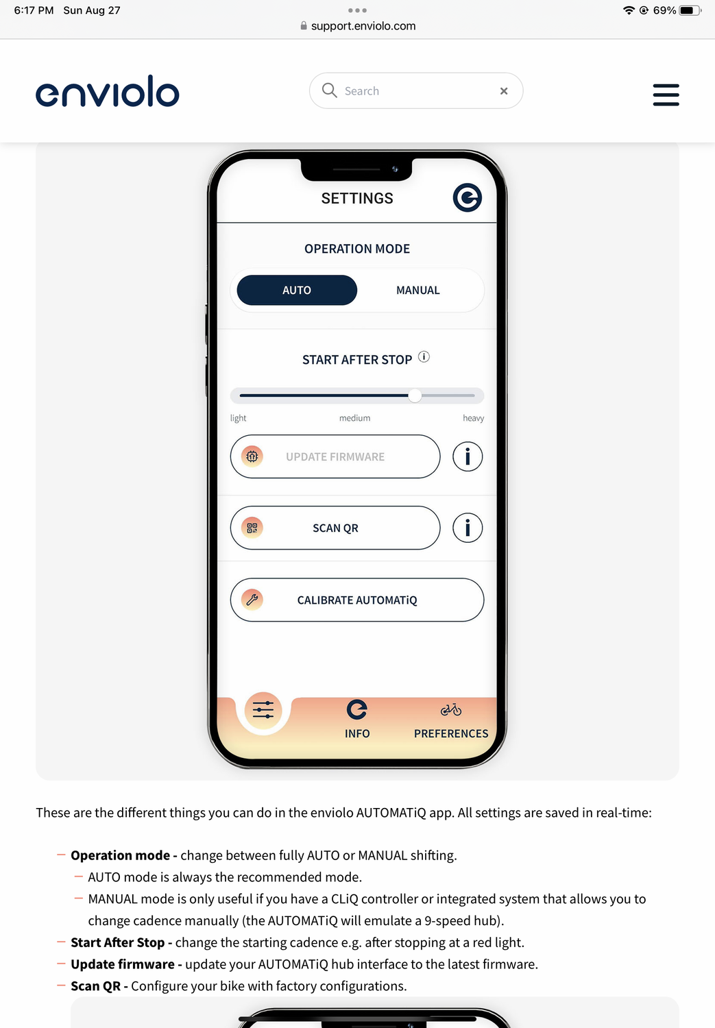

I would say that the only time it feels like it’s not quite right is starting from a standstill, where it feels like it stays in a lower gear a bit too long (making it feel like the pedaling is too easy/powered) before starting to upshift, if that makes sense.
Have you tried adjusting the “Start After Stop” parameter in the Enviolo app? Maybe that will help.
