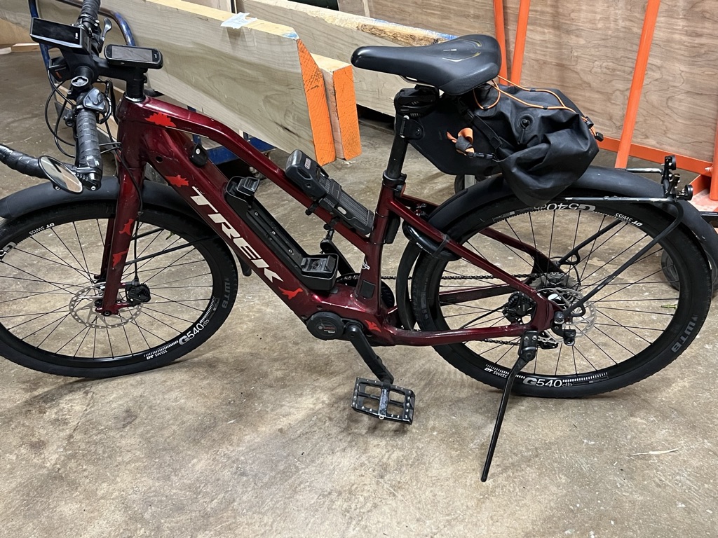

First Ebike - 2022 Trek Allant+ 7S

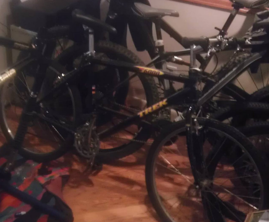

This is my 2nd Trek. I still have the other - a '90s 6000 that a lot of us called mountain bikes back then. I don't know what's 'officially' considered the first mountain bike unless we're considering klunkers, but compared to what was available at the time, it was more capable than most. What suspension?, 26" 1.75 rubber, cantilever rim brakes, grip shift, and a rather dodgy looking cockpit compared to today's standards. I've never ridden this hard, but had a Cannondale F400 around that time that was similar. We'd take these things down black diamond trails and never think anything of it.
I was at a buddy's house about a decade ago and noticed this lying under piles of crap in the garage - somehow still pretty cherry I assume by the lack of time he spent on it & being covered in garage crap. I asked him about it and he seemed a little shocked I would find it appealing. I started to explain what about it makes it cool and he paused me and said 'what'll you give me for it'? $100? Sold right there on the spot.
I rode this bike almost daily for the year I lived in Boulder, CO. It's still the smoothest bike I own as long as you stay on reasonably smooth terrain like bike paths. 30ish years old and still rides like a dream. Or will when I put on some new rubber. This one was also built by hand in the USA which adds value to me. And not only to me. Go see what a handmade US frame costs. I haven't priced one lately, but I'd be shocked if you could get a frame for under $2500.

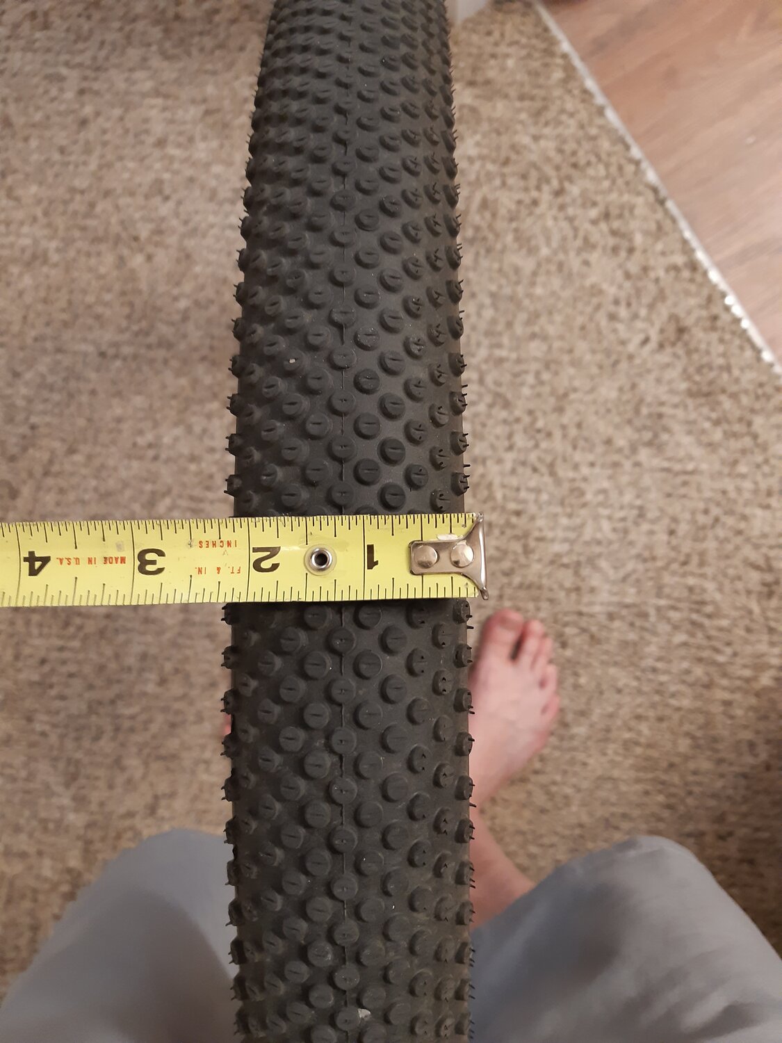

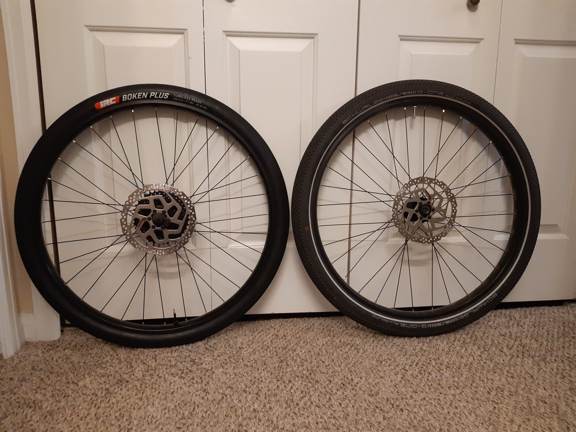

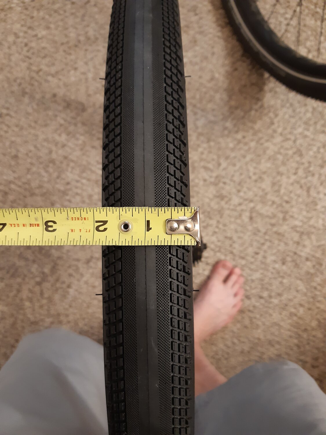

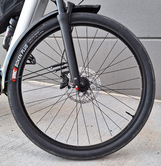

So after about 1500 miles, it was time to do something with the tires. I've suffered 3 flats with these - time to go tubeless. Not only did I want to go tubeless, but I wanted something a little more efficient with lower rolling resistance. I think. Also, the G Ones feel like they're rolling in harder corners and make a bit of noise - which means friction.
I didn't find exactly what I wanted to use - a Maxxis Torch. They don't make that tire in a 27.5, so I settled on the closest thing I could find - IRC Boken Plus. They're a little stealthier than the G One as they don't have the reflective stripe up the side. I don't ride in the street, so I never really considered that a feature.
While these weren't the easiest tires I've ever mounted, they didn't put up too much of a fight. I did need a single lever to get them on, but they were easier to get on than the G Ones were to get off. I needed 2 levers for one of those. Both inflated and seated the beads on the first tries. The tires are made of some super sticky rubber which kept the beads from sliding while I levered the last parts on.

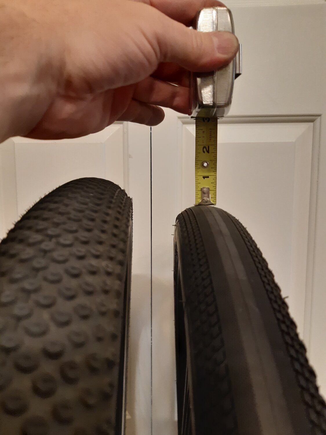

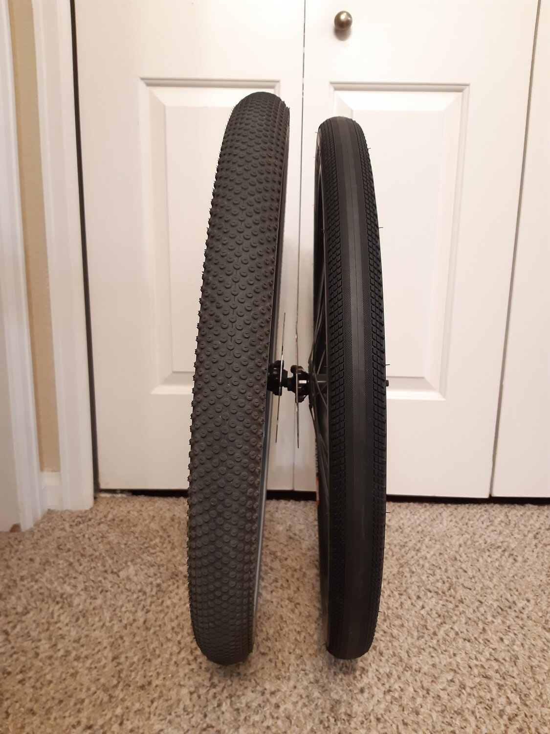

One thing that I immediately noticed is that they're noticeably shorter.
The Bokens are also considerably narrower.

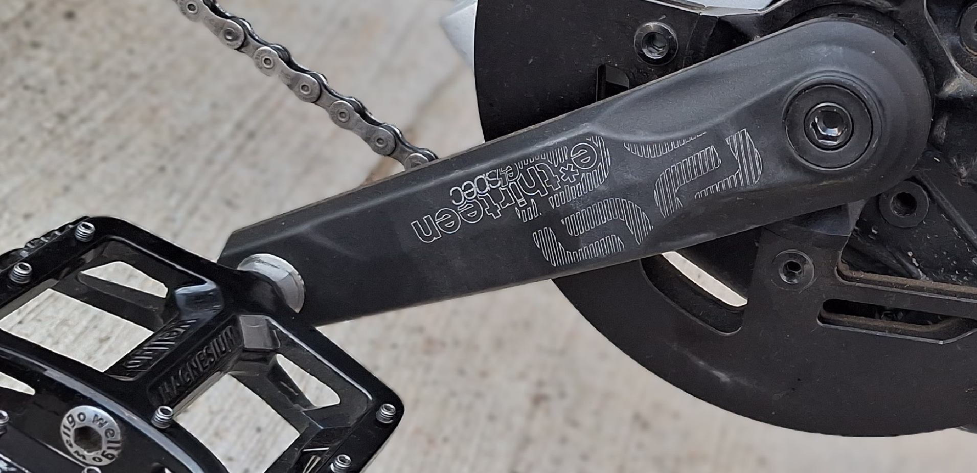

The Trek dealer gave me a smoking deal on the new crank arms (EThirteen Plus Bosch GEN4 160mm aluminum), so I'm going to let them do the install - which includes a Face, Chase, Tap, Ream, Hone, Align. Stoked to get it back so I can try out the new goods!

So about these new tires
I kept expectations low. The narrow made me nervous. Preconceptions of narrow tires bowing to lesser territory and all
One thing that's immediately obvious is the girth reduction. I could smuggle drugs in the fenders now. That's yet to be rain-tested, but keeps dust down on all the parts. I think. Haven't seen a lot of dust the last few weeks.
Once I got on it that was all gone though. This should be the factory tire. Tubeless. 40 psi in the rear, 35 up front. Reverse mullet pressure mmmkay.
This tire setup does everything right. Rolling resistance is minimal. Grip is always consistent. Gives you the cornering confidence of a motard. It survives light trails. Makes thorn flats irrelevant. Increases range over the stock Schwalbe. It's just the right mix of compliance and energy retention.
About that. The stock Schwalbe has a roll to it that while predictable, makes you second guess things. It's noisy in corners. It lets you float through grassy passes, but I don't usually need that extra buoyancy. And they barely fit the fenders.

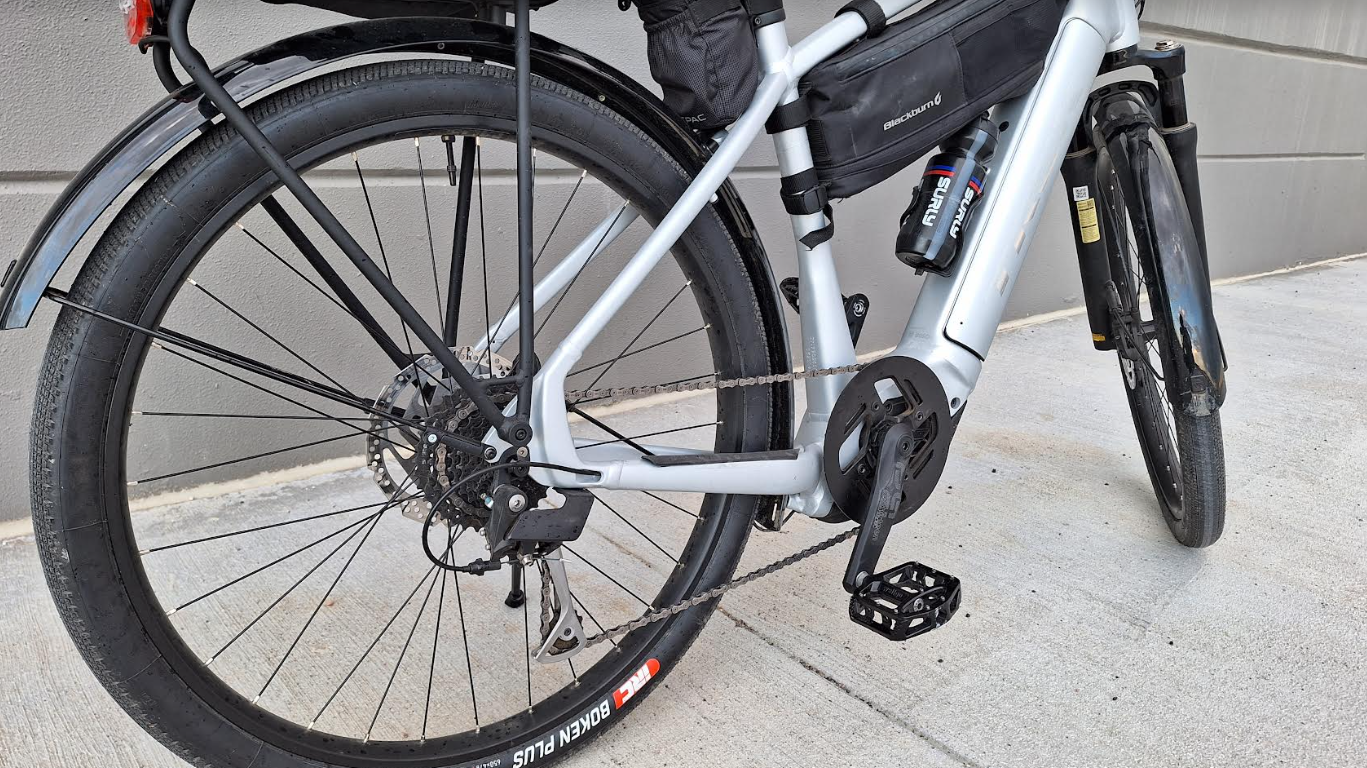

So this still unnamed steed is starting to show its age a little after a bit over 1700 miles. Despite attempts by 2 shops and the factory, this top bottle boss on the seat tube is an escape artist. I think I'm going to tackle this one myself. Maybe some JB Weld or some other sort of adhesive. Friction fit is clearly not working. The lower is fine. But I want it back, so Ima take a stab at it.
Still no luck with the fork preload adjuster either. 2 shops and it's still INOP. Can't say I've been able to get them too interested in fixing it either.
The Trek store here did solve my front hub issue quickly though. When I was truing up the wheels for the new tire install, I found crunchy bearings in the front hub. Turns out someone had hamfisted the preload. The wrench there backed it off, and now they run more smoothly. However, I'll need to keep an eye on these. There may have been some damage from the excessive preload. Yes, I'm considering a new wheelset. Rims are good, but I'd prefer sealed 'cartridge' bearings.

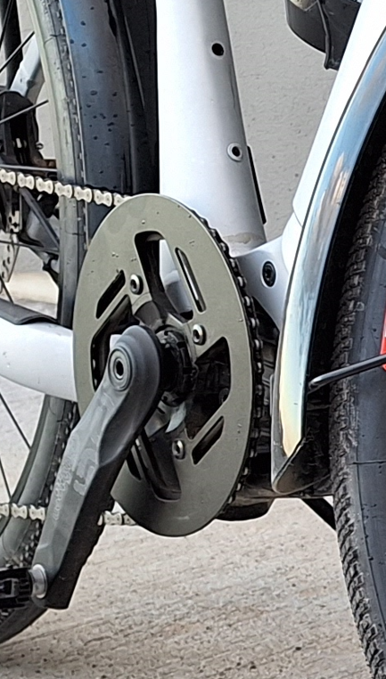

Oh, and you may have noticed a non-standard part there as well. While I was at the Trek store, I inquired about shorter crank arms as the bike is sitting lower with these new tires. I found the 170s to be excessive even with the G-Ones, so I got hooked up with a set of EThirteen espec 160mm crank arms. They are rather attractive, don't you think?
I let the shop install these for a couple reasons. There is a setting for crank arm length in the software, so I can't do that. Also, they gave me a sweetheart deal on the crankset. While it seems they mostly got it right, I had a pedal come loose at about 45 miles. :rolleyes:
Aside from that, mission accomplished. They get my feet a bit more off the ground and make me work a little harder for the miles - which is just fine. I have a motor for the lazy days.
