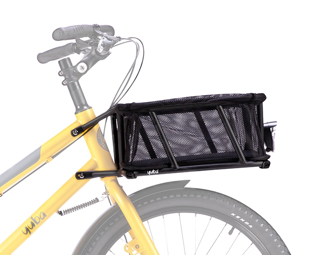

I also installed a basket in the front that mounts to the frame, so when you turn the handle bars the basket stays straight. I mounted the controller in the basket. The front motor is so small that from a distance you can't even see it. I thought about mounting the battery somewhere else besides the frame triangle but it just fits so nicely in there and makes the bike so stable.

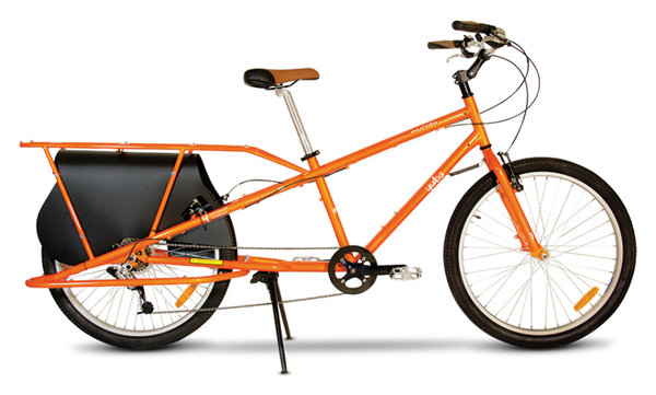

My yuba bodaboda has a 11 to 32 8 speed sprocket set. With 32-42-52 front I can go 1 mph unpowered up 15% hills, or I can keep up with the motor @ 25 mph. I don't help much at 52:11. Unpowered is important, as the throttle can fail in the rain. Happened 7/12, had a plastic bag over the throttle but the rain was so hard it burned the pin off the ASI controller for the MAC. Pedaled unpowered 20 miles to summer camp then 30 miles home the return trip. Still waiting for a new controller ordered 7/14.
I have a front motor. Was ebikeling 1300 W geared hub (wore out gears 4500 miles), then until 2 weeks ago Mac12t 1000 w. The higher wattages don't really add much torque, they just heat the motor up faster. 500-700 w is about the most efficient up steep hills. I have the battery hung off the front as you do. I built a 5" wide box for the battery instead of the yuba bread basket that is 14" wide. You can see the back of it in my avatar left. It is lined with foam blocks from the battery shipping box, with a green plastic bag over it. I use knobby front tires, 2.1" kenda or giant. They get less flats than road tires, like every 2 or 3 years.
I determined I hated ebikling PAS when I had that motor on the front of a huffy Savannah cruiser. It had a minimum acceleration of 500 W, which was dangerous if PAS kicked in while I was turning sharply or riding on my rutted grass driveway. I didn't move the PAS pickup when I moved the motor to the yubabike, bought 12/17. I use throttle only.
The front could still fall down on wet or muddy steel plates (contruction zones), wet wood bridge decks (never happens here) or ice. The tort lawyers of USA drool at the thought of yuba selling a front motor bike. A fall with a kid in a carrier on the back, what a windfall!. 30% of a million dollars! I simply don't use the motor in those situation. In fact I walk the bike over the muddy plate in the contruction zone. I have a brain & use it. As a result I have a nicely balanced bike instead of the rear heavy slug it was when I first had a 1000 W direct drive motor on the back.
BTW the nice thing about a converted bike, you can use the extra wire harness to the motor to make a loop to it under the wire ties. So I can change the tube without unplugging the motor; just cut some wire ties & lay the wheel on the ground. I flip the bike upside down to change tubes, I deleted the display. Just a voltmeter in the throttle.
BTW this week with the front motor & battery removed, the bike won't stand up on the dual leg stand even with just tools, water, tubes & rain gear in the panniers. The front lifts in the air & the bike falls over. I carry 60-80 lb of groceries & ag supplies out to my summer camp weekly. Had 8 liters of soda & 2 1/2 gallons of weed killer home from the store yesterday.
