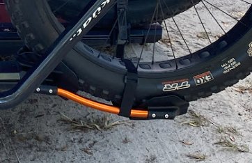

I have a 2 inch receiver on my 2017 Pacifica. This year the desire to make it easier to roll the bikes up a ramp got me to buy a kuat nv 2.0 rack and ramp accessory. My hope was to allow my wife to roll the bikes up the ramp without assistance. That failed on our first trip. I will get back to that. I am the one who loads and unloads the bikes on the rack. I really like the RockyMounts Backstage rack. It is very solid and the bikes are secure riding down the road. My purchase of the Kuat nv 2.0 was a decision based on a few reviews and seeing them at the local trails. I like the Kuat anti wabble design but don't like the fat tire add-on strap. That brings me to the failed on our first trip statement earlier. We were able to roll the first bike on no problems. The second bike had a problem if using the Kuat Ramp accessory. The bike handle bars hit and you cannot roll the bike all the way. Never thought of that issue. I had to roll the bike back and lift it onto the rack. That was the fail. So if I had two different height bikes that cleared the handle bars that would have worked but I don't. If others have racks that work for two fat tire bikes love to hear from you. Kuat will go back to REI and I will keep using the RockyMounts.

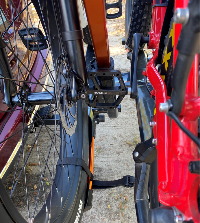

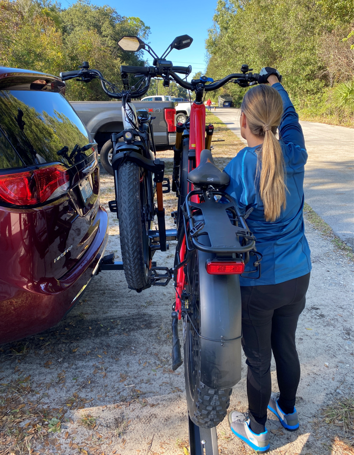

We did try to tilt the rear bike but the amount required to clear the handlebars was too much. I ended up lifting the rear bike on the rack. Some guy walking by suggested we loosen the handle bars and turn it 90 degrees. That's not a option either. We also ran into this clearance issue with the pedals. Dropping the bar allowed the clearance but the spacing between the bikes is close.

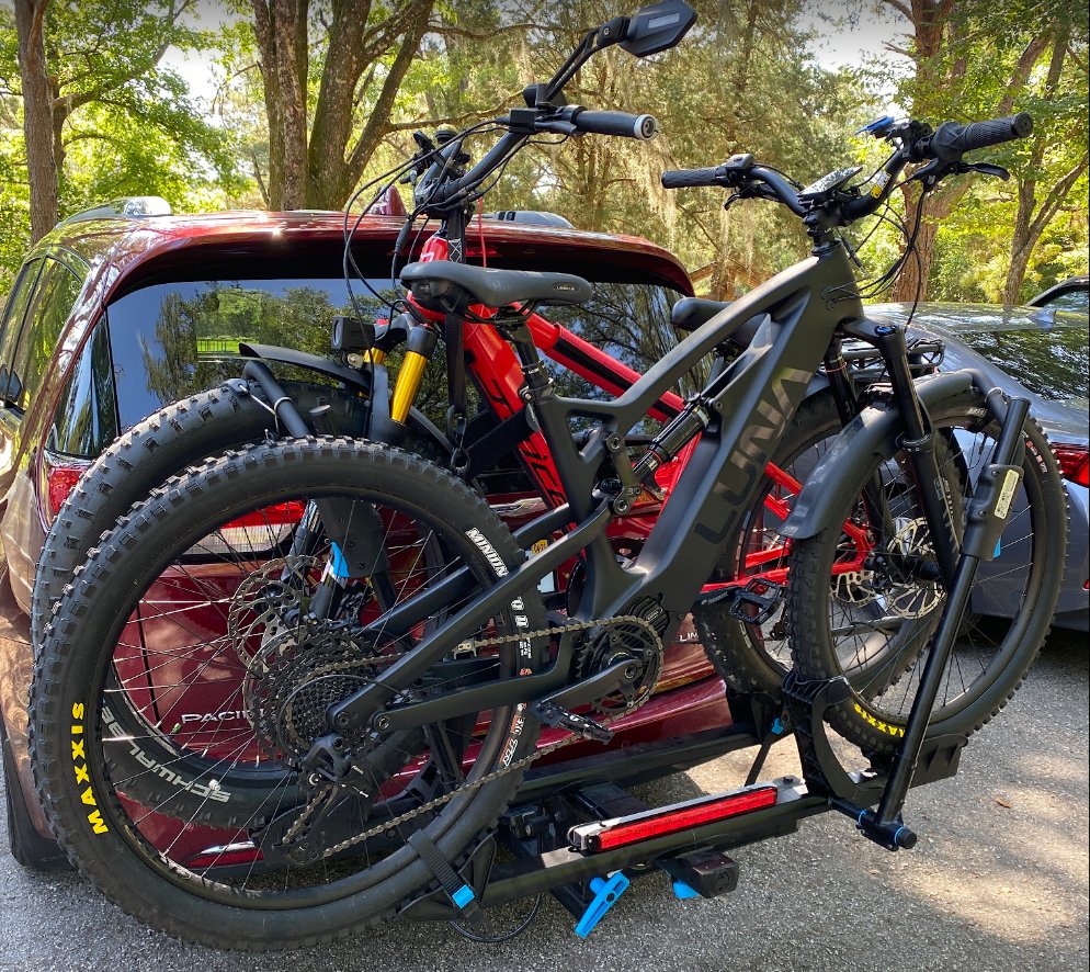

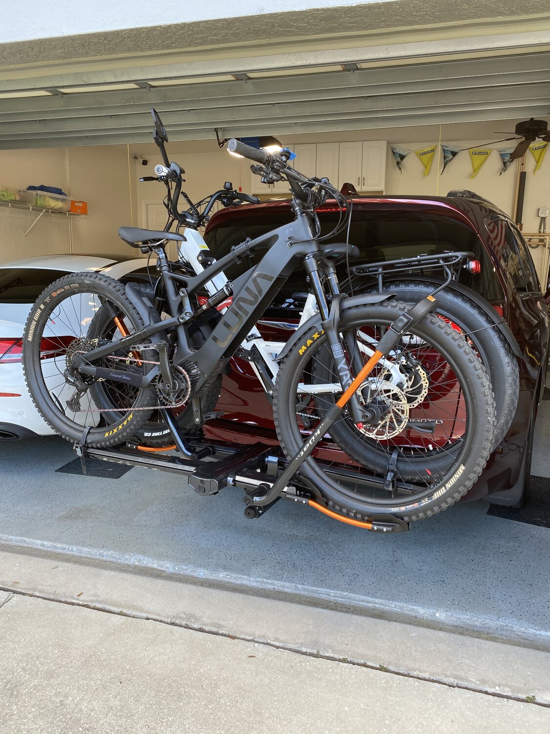

I have a Rocky Mounts Backstage rack. It has the swingarm which I really never take advantage of using. I would save 20lb if I had got the non swingarm version called the MonoRail. I added a third brake light which also has turn signals. I have had it for 2 years and it is really solid rack especially when I load two fat tire ebikes. The Backstage rack does sit the bikes a few inches higher than the Kuat did.

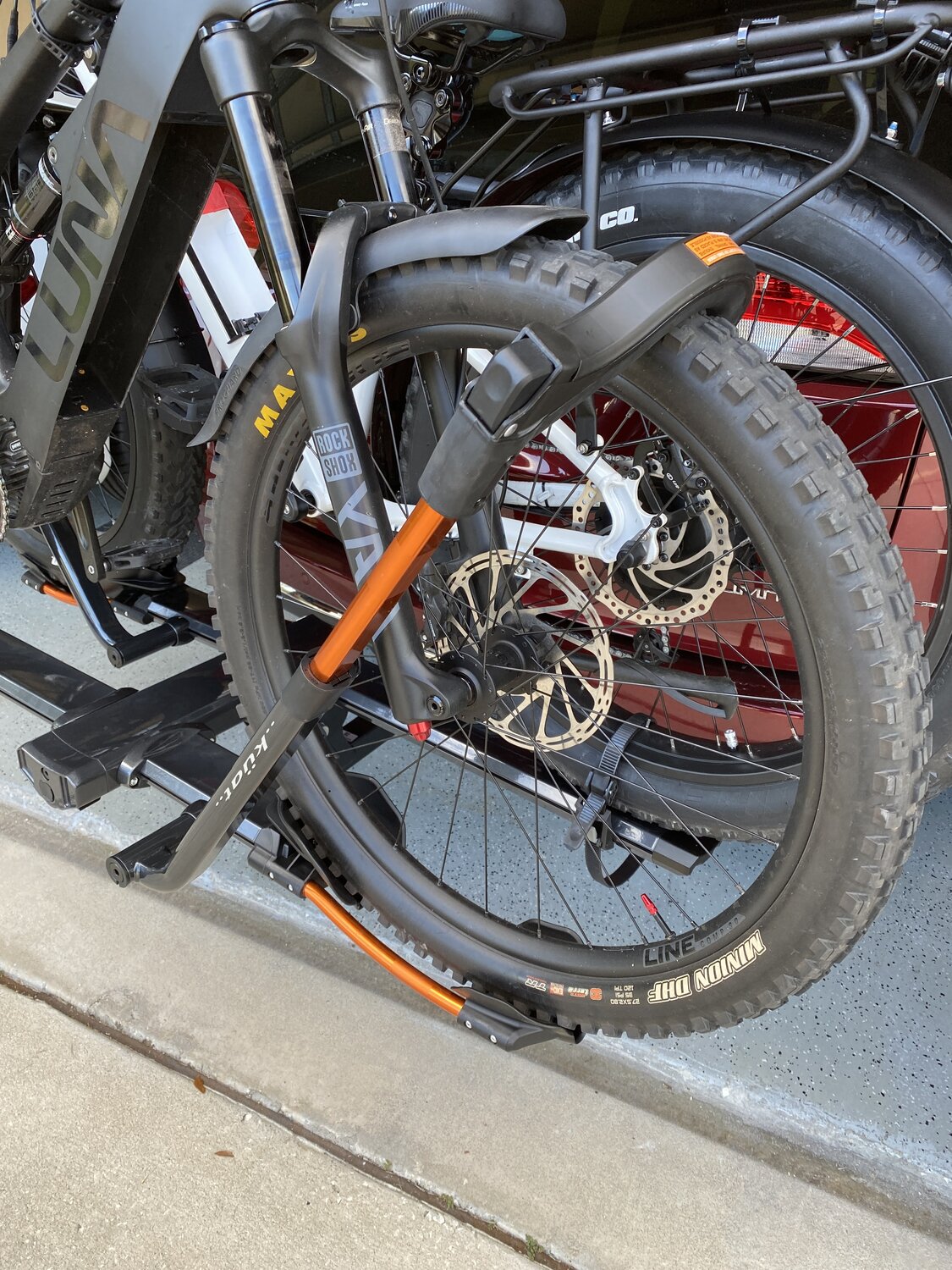

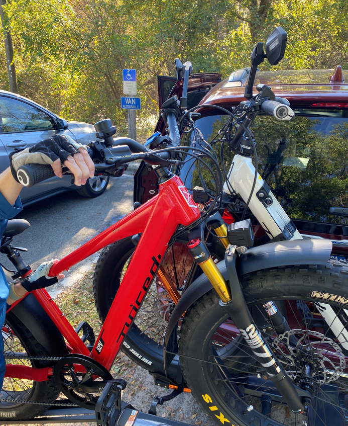

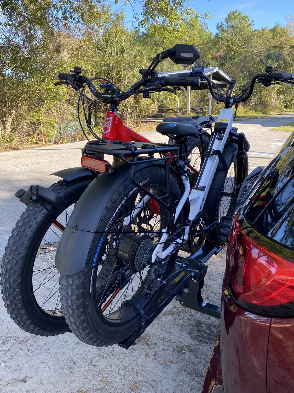

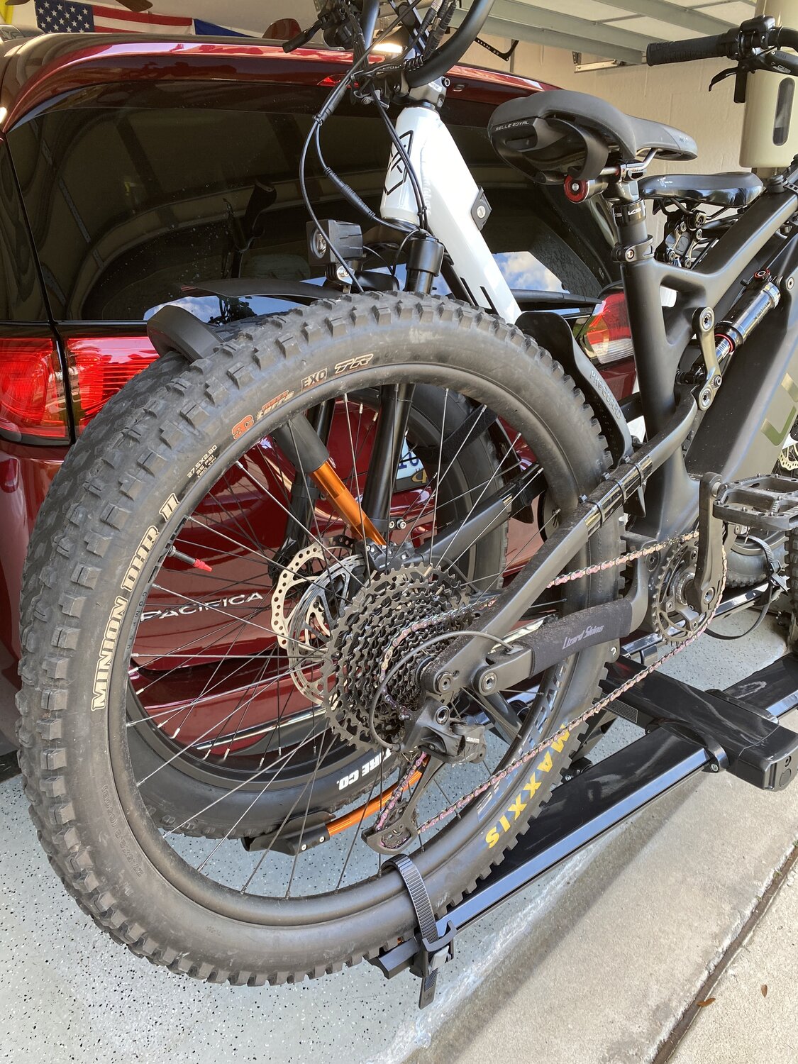

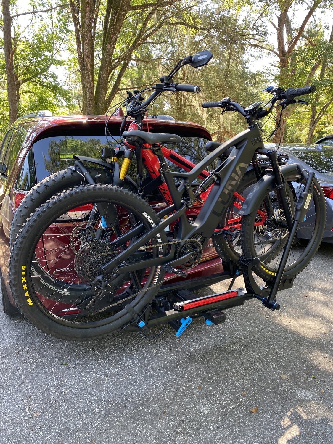

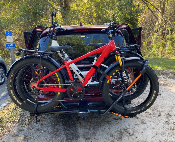

I have been riding the Juiced bikes a little less since getting a new Trek Powerfly FS 4 and a Luna X2 ebikes that arrived for Xmas. All of the bikes work very well with the Rocky Mounts Backstage. Here are a few pictures of the Juiced RCS Step Thru and the Luna ebikes on the Kuat. The Luna has a longer wheelbase and barely fits the beam on the Kuat. Not an issue with the Backstage as it has a saddle or bucket for the rear wheel to sit in. Also the fat tire strap on the Kuat is a little annoying to use. Is seems to be a little long and I had to zip tie them together. The fat tire strap on the Rocky Mounts Backstage is easy to fit together and take apart. I have learned to bungee the front hold down arms to the wheel in case it ever slips on the tire. The Kuat came with velcro straps to hold the tire to the rack. I thought that was a good idea for securing the wheel. I do that on the Backstage rack now to ensure the wheel cannot come off the rack.

FIDLOCK Twist Bottle mount strapped to the top tube as the Luna has no mounts. The Luna does not have a rear rack option but the Powerfly FS 4 does. The rear rack is on backorder. If you want to see more on the Trek see link. Trek Powerfly 4 & 5 A hardtail version of the Powerfly 4 is also available with optional rear rack.
