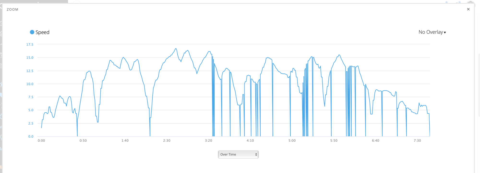

So, it's possibly not fixed. It still drops data constantly on the speed sensor, but isn't creating immediate system errors. The problem is, it is possible it is the watch. The fit files generated from the watch vs wahoo are pretty different. I am not sure the wahoo uses the speed sensor from the bike. If it uses gps, that would account for the difference. They also report speed using different fields in the fit files.
I turned around and went back to the bike shop when it started auto-pausing constantly starting around 3:20.
I plan on pairing my garmin with another vado at the LBS and going for the same seven minute ride. That should answer if it's the watch/combination. If it does it on any other vado, then yet another garmin device isn't worth existing in the world. If it doesn't do it, then they need to keep "fixing" my bike.

Ok, so, my bike is generating a ridiculous amount of sensor drops now. What's interesting is a new bike in the shop also generates *some*. And both do it most with the assist level at zero (motor off). Now, my bike did not generate *any* with the wahoo roam. but I have yet to confirm that the wahoo depends *solely* on the speed sensor. So, at least *some* of this could be garmin not working (maybe all of it at this point).
They have replaced all the cables. I am picking up my bike (again) tomorrow and will try the ride again. I am going to use the watch and the wahoo. But if the bike isn't shutting down, and wahoo will gather the data without issues, I am likely calling this issue closed.

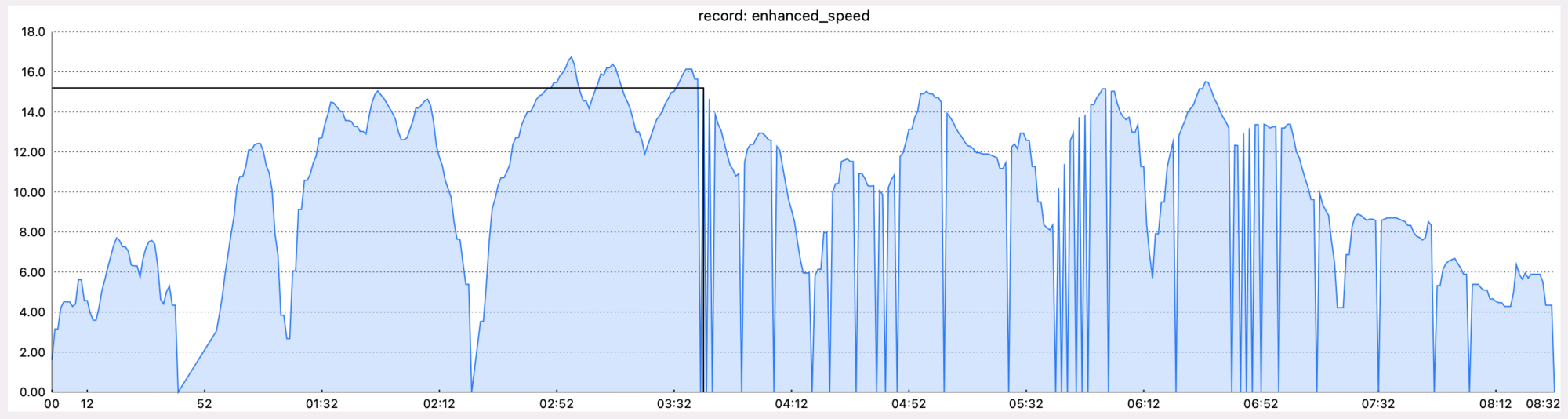

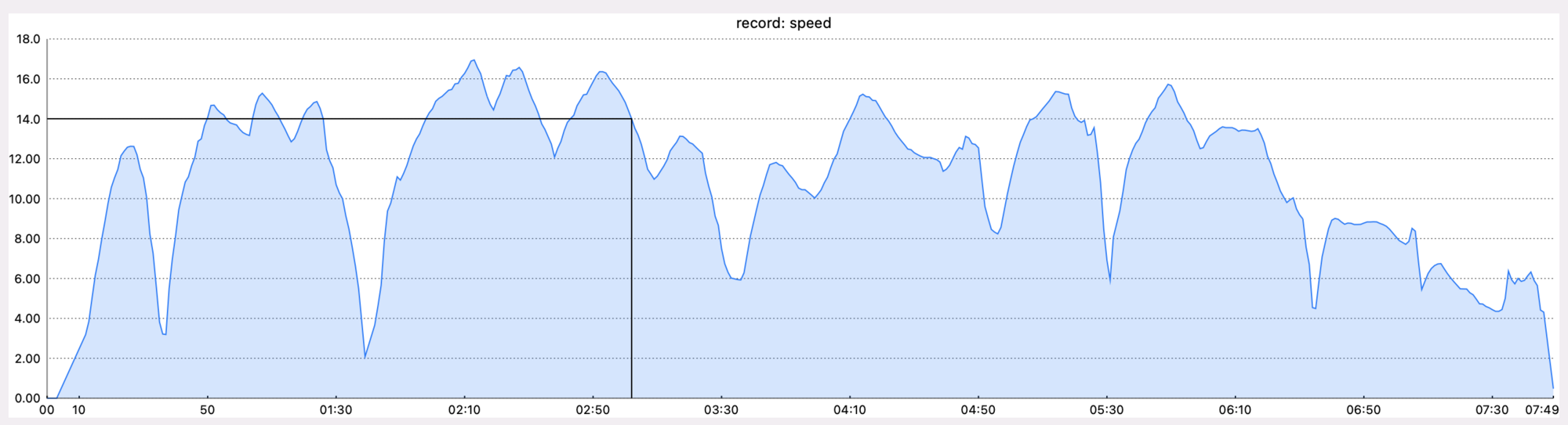

I attached the fit file explorer graph view for the respective speed fields (one is speed, the other is enhanced_speed for bigger numbers ). See if you can figure out which one is garmin and which is wahoo. ;)

I have my bike back. Garmin may be the problem. It is *possible* that the underlying bike issue has been fixed by the original faulty cable replacement. I have confirmed that wahoo auto-pause responds to the speed sensor when connected. (lifted back tire, spun the wheel, stopped it, auto pause kicked in, spun the wheel again, and it resumed).
Anywho, garmin just hit my ignore list. Their devices have all had stupidity associated with them. I can't for the life of me understand how garmin could be dropping speed sensor data *but not the others*. I get interference killing records from reaching garmin. But having it *always* be speed and *only* to the garmin really doesn't make sense to me. (I am speaking as a software engineer with network engineering knowledge, not as an expert with ant+. maybe there is an issue there beyond my knowledge). I know all the sensors broadcast ant+, but I don't know the broadcast point on the bike. Maybe direct line of sight is "through" me for that sensor source and the watch. And it simply can't deal with that.
Whatever it is, I am not convinced it's a symptom of some other bike issue. It *could* be, but it seems less likely as things stand today.
