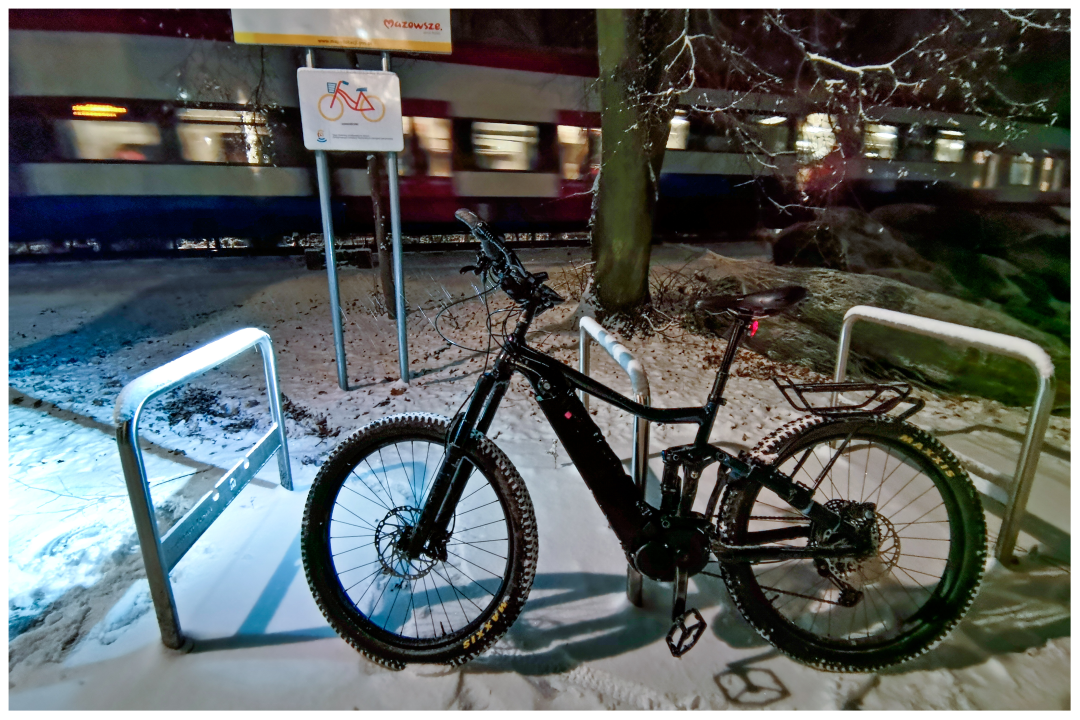

Congratulations on the upgrades... I also installed a mudguard and fenders for winter riding.
The basic kickstand is not really cool looking, but very functional. Good lighting is essential. ;)
I posted this video in the headlight thread that highlights a new EMTB with OEM High/Low beams.
Well...
Proper Winter e-bike :)
