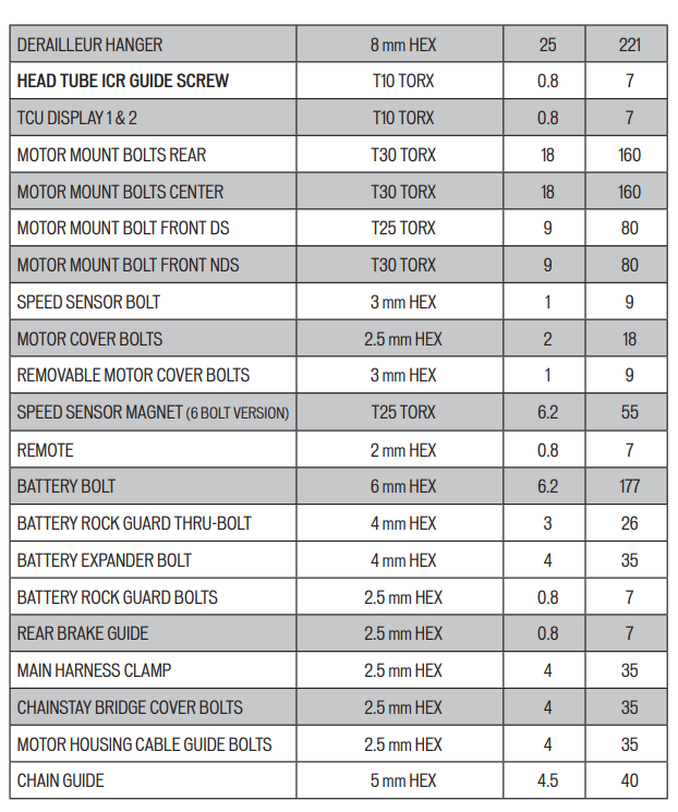

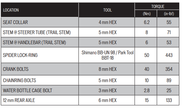

So: what is the recommended tightening torque for pedals?
The reason I'm asking is the 2020 Turbo Levo User Manual does not give any answer to my question :D
