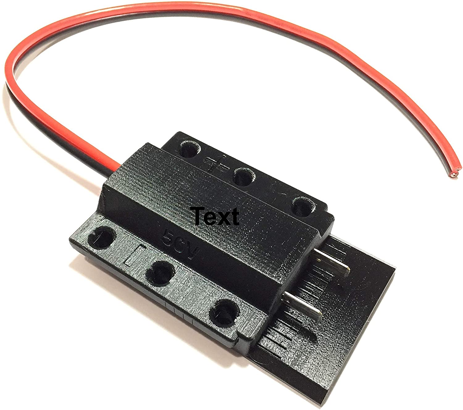

There is an adapter available for the EGO battery:
It might save you some trouble when trying to wire the battery. The adapter uses 10 gauge wire which should be sufficient.
I used a similar adapter for a DeWalt battery on my bike.
Thanks for the lead. Why reinvent the wheel? I ordered one today!
Very interesting! My brother has a nice 3D printer. Can you incorporate wires (conductors) and metal pins into a 3D printed item? Thanks!
I don’t think there will be a problem. Check out the files.
