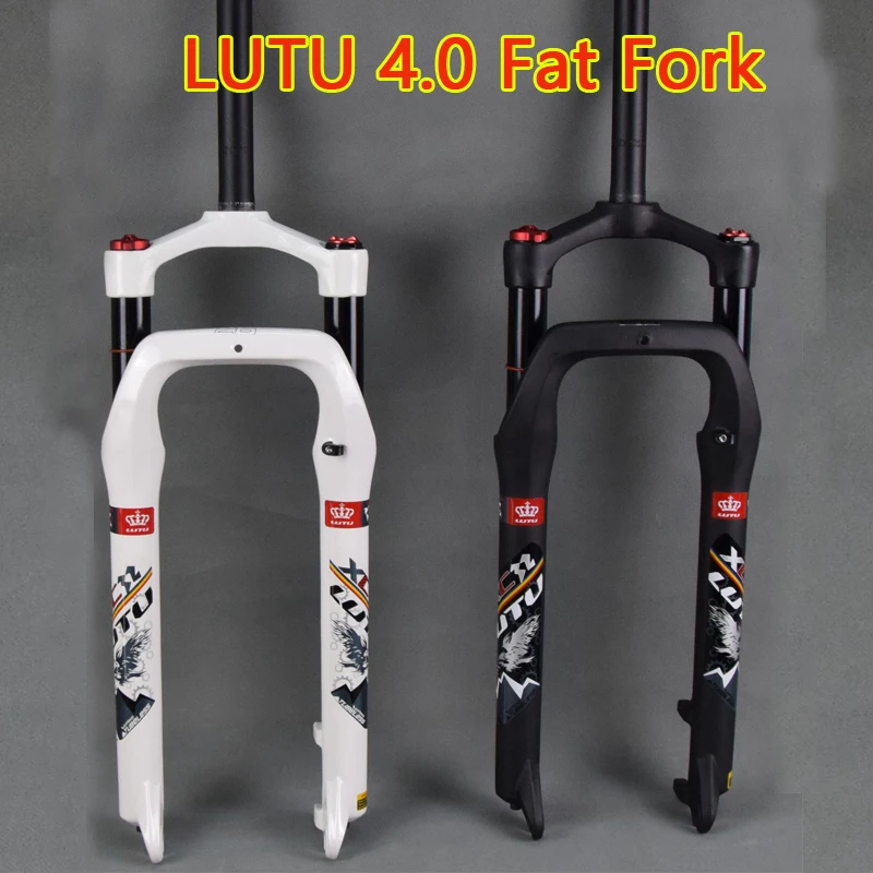

1-front fork

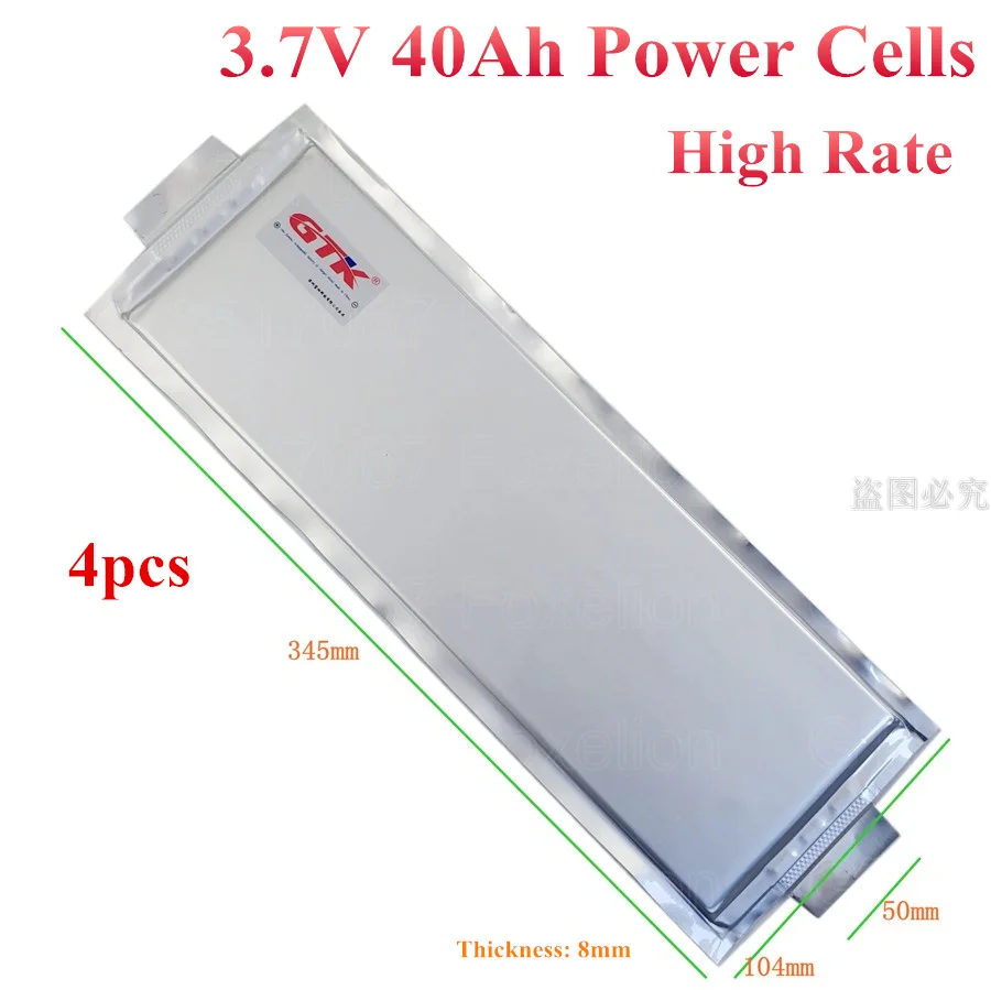

1-baterry
I should be able to fit 10 of these in the battery area and that would give me 36v 40ah will also need a new controller want a 30 to 35amp but will probably hard to find one that will fit

I just saw that. Good price on the Air fork.
Are you an old hand with experience with those pouch packs? I'm not and they scare me.
Did you get a 20" x 4 front fork? The photo shows 26". Please post your thoughts once installed. I am upgrading my 26" Ecotric fattie and if the difference in ride is more than just slight I will do forks on my wife's Ecotric folder/fattie. It's the step thru (new) version of yours. Thanks for posting , love seeing what others come up with to better their purchase. That's the beauty of these sub-$1k eBikes. Great modding platforms for those that know how, great learning experience for those of us who don't.
Gypsytreker here is a link to 1 listed as 20x4
theres not a big difference between the 2 only about 10mm
Hopefully I'll be ordering the 20x4 this week. I'm just waiting for a responce from the seller in the last pic of the listing it shows a white and silver fork all of the other pics show white black so once the seller confirms the color and whether the decals are stickers not paint I'm buying I watching the prices of the forks and this is the lowest I've seen.
This is an air/spring lock out, correct? I ended up paying $148 for mine because the 26" x 4's under $100 were string only, min travel. I'm waiting for a Fat Pig headset so I can install the forks. The ones I got actually state that the decals are removable. Anyway I will be watching your progress if you don't mind :)
Ugly stickers. Good that they come off.
It's good to go with a completely new headset so you know everything fits, but if the crown race on the old fork pops off and fits the new fork, you will have all the same bearings again. The race on my old Ecotric fork came loose with a little nudge. I did buy an FSA pig, about 10 dollars, I used the star nut.

I'm totally ok using the old bearings that are actually only 162 miles old. I have a star nut tool and some extras. I bought the pig because it was cheap and I will now have them if all the sudden I aquire a clicky front end. The decals are really, really ugly but removable, thank God! :)

Harry I would be really interested to hear what you think about my plans for making a custom battery.

I'm also considering the passak fork you have and wanted to know if those stickers are removable. The sellers that have white/blue are charging more but I would go with another color if the decals are stickers and not painted on.

I stay away from RC Lipo batteries in the bags. Too risky. I want this to be a fun hobby, not something that scares me.
Thanks Harry
I didnt know lipo's were a fire risk and I wouldnt want to take that chance. I've got time before i replace the battery hoping to get at least a year hopefully 2 before its time to replace it, it's only a few monthes old and has less than 200 miles on it. I'll just save up and try to find a reliable vendor or who knows maybe tesla will start selling thier cells to the public(even tho would hold ny breathe for that)
