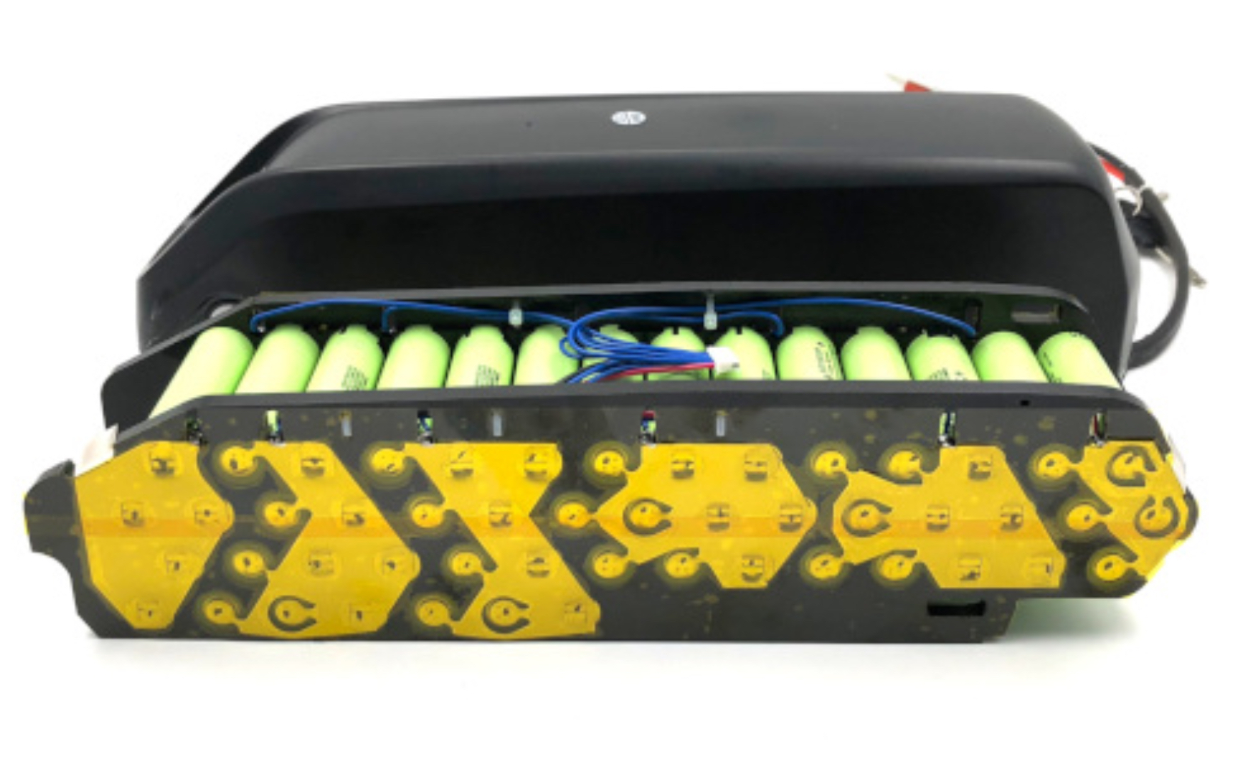

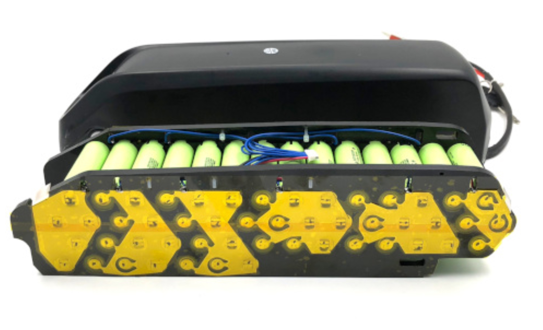

Yes good prices, but once you open the pack you see the difference. I have two UPP packs still in service. 2015 and 2016. The cells were genuine, but anyone familiar with battery builders knows UPP is a coin toss. Someone is going to get the short stick. They now have USA stock. And ship in the USA. But if you’re one of the really unlucky buyers and accidently short out their batteries the ensuing fire is nearly impossible to Put out. Cheap BMS, where a quality BMS will protect the pack sacrificing itself and not overloading the cells.
I’m quite torn writing this. Chances are good that a decent battery from UPP will give years of service. But there are just to many potential issues. FWIW we’ve seen what’s inside the case dozens of times. I forgot but I have one on my bench from 2017. I should take pictures...
These are UPP packs...

UPP is a gamble. While they have a 1 year warranty the hoops we have to jump through are maddening. I sold hundreds of their batteries. There were quite a few failures, NONE of which UPP honored a warranty on. We had a customer writing an eBike travel log and when the batteries failed, new batteries, we exchanged dozens of emails. In the end we refunded the customer. Our reputation suffered and UPP went on to use our customers email addresses to sell direct.

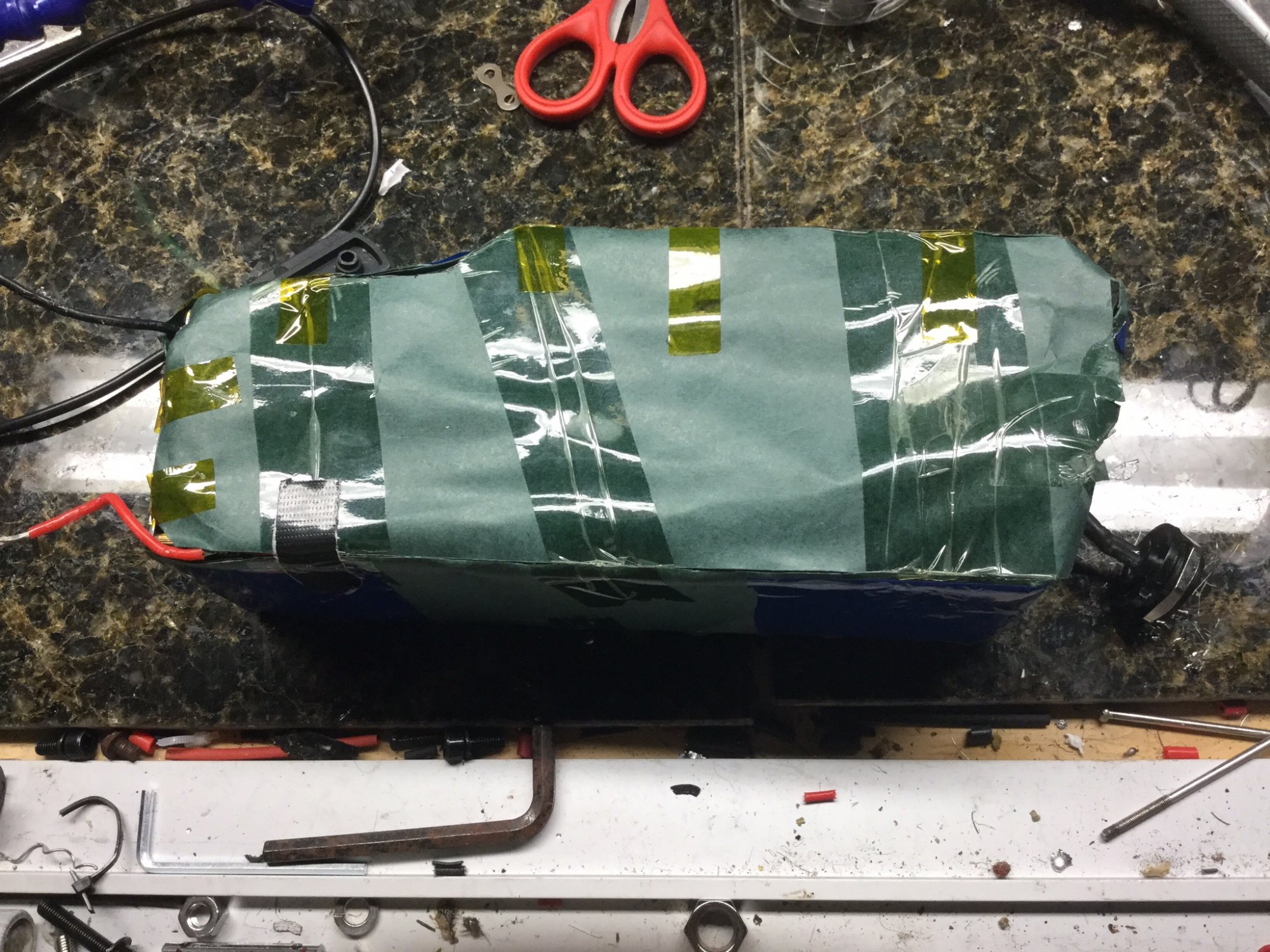

but I have to comment about being mentioned along side Luna. Worst warranty in the USA, claims USA builds when in fact most are China. Here’s a Luna BMS along side a UPP BMS.

So the battery you show is not one you personally recomend or is there issues if you personally suggest a company you work with as an expert in that field?
I probably come off as a split personality... as budget batteries go, UPP now has a USA store. IF you take my advise and have them include a backup BMS, you’ll likely have a decent battery. Your wife’s motor and controller are low amp draw. Now that they sell on Amazon and eBay we’re blessed with some protection and warranty service. It seems that Dolphin packs are losing ground and are not very popular any more. They are one of the toughest cases out there, but now they (Reention) copied Shark ( Hailong) cases with far better quality plastic.
