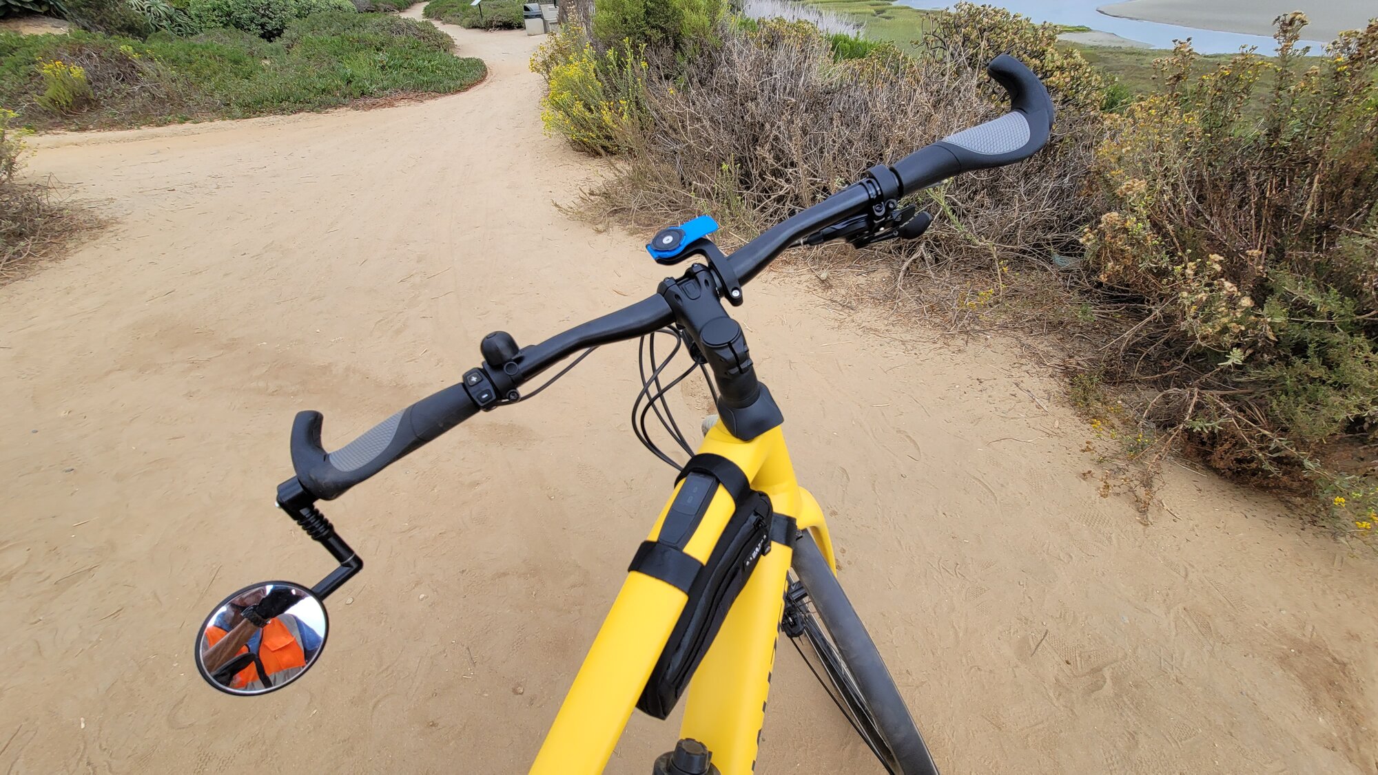

Thanks for the info and photos! You and @Prairie Dog both steered me toward the Ergon GP2 grips.
Installed them before today's 16 mi coast ride. Nice and comfy, appreciated the extra hand positions, and no hand or wrist discomfort afterward.

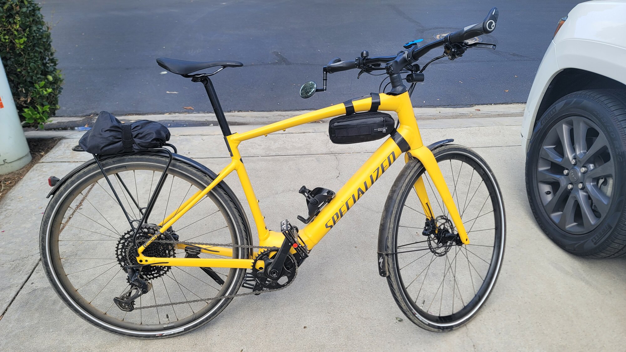

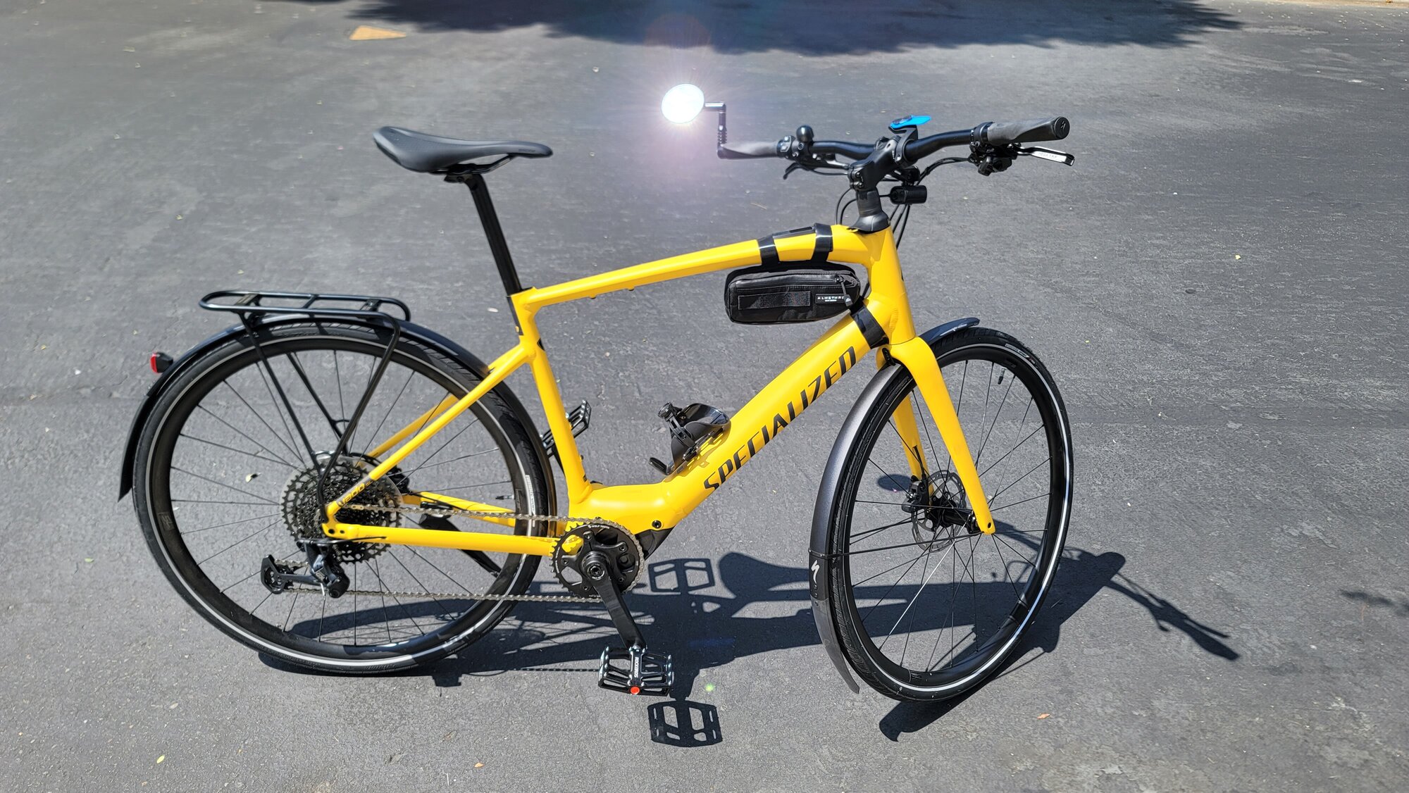

Just removed the long plastic mud flaps at the bottoms of the fenders. Am I likely to regret this when it rains?

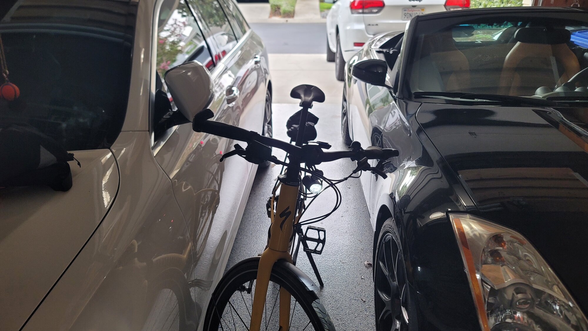

Main motivation: The rear flap keeps me from standing the bike on its rear wheel to roll it between cars in the garage. Vastly easier than any other method, and much less risk to car paint. And they're easy enough to reinstall.
Besides, both flaps look kinda dorky to me. Looks sportier — or at least more normal — without the flaps in this before and after.
The hub-drive's fenders work well enough in the rain. Its front fender goes no lower now, and its rear is only a few inches longer than the SL's sans flap. This will generally be my foul-weather bike.

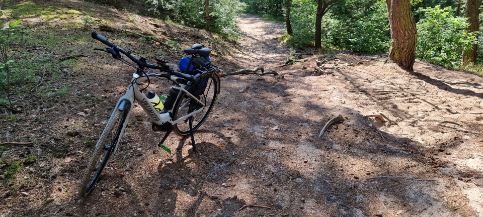

Just expect the down tube getting soiled. Otherwise, these flaps are not necessary at all. Removing the front mud flap could be even beneficial: the flap has the tendency to pick up objects such as little twigs and blocking the front wheel, which could be even dangerous.
I think it was my first forest ride on a Vado SL (July 6th, 2021). I can't even remember whether it was the mud flap or the front fender to block my wheel on the ride twice. As forest riding would be one of the principal activities on that e-bike, I got rid of the front fender early, and went with a temporary AssSaver for the next 3 years... Which probably is not your use case, Jeremy! :)

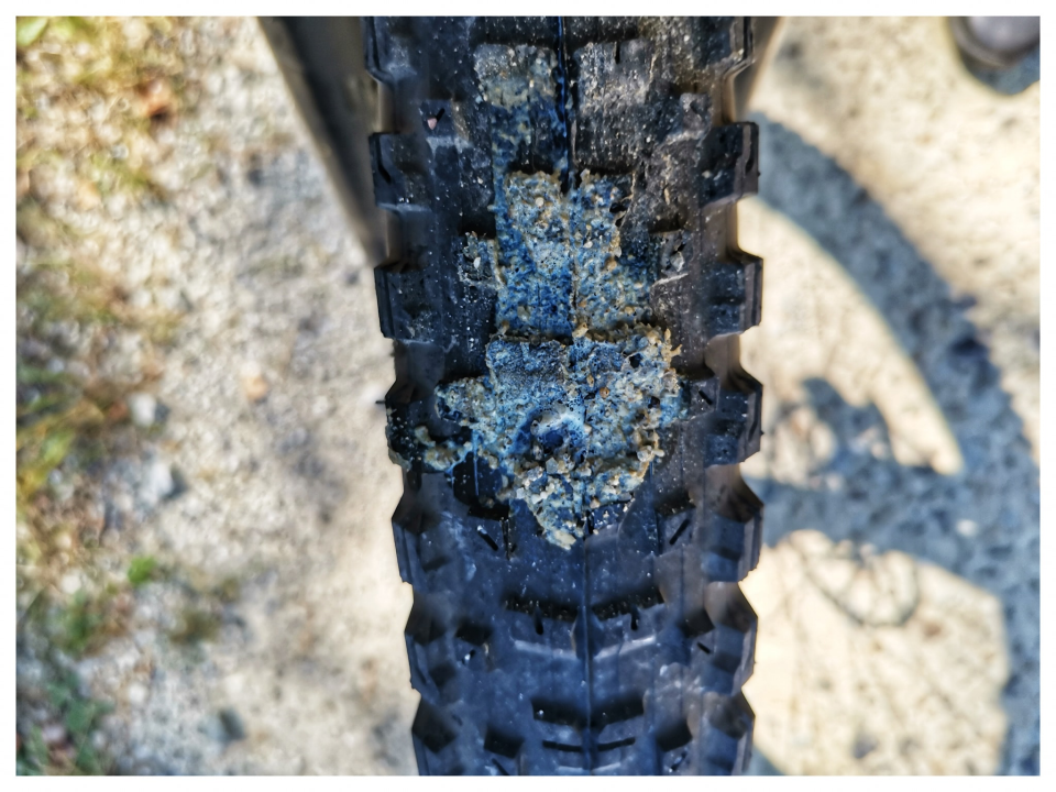

Tubeless tyres require more frequent re-inflating, that's it.
(I hope you can get Chris King valves). The maintenance requires replenishing the sealant every three months. What I do myself is rotating the wheel to have the valve in 6 o'clock position. Then, I relieve the pressure from the wheel by unscrewing and slightly pressing the valve core. The Chris King valve cap has an appropriate tool, with which I remove the valve core. Then, I take a small syringe (no needle!) and inject some 30 ml of sealant through the valve stem. Eventually, I replace the valve core and reinflate the tyre. It is a good idea to rotate the wheel many times to distribute the sealant or just going for a ride.
Regarding the punctures: In case of small punctures, it is enough to remove the foreign object from the tyre, and it will re-seal soon (carry a pump with you). In case of a BIG puncture, you will need a repair kit, possibly involving a CO2 cartridge. The procedure is easy. Only I have never had to use the repair kit, so let me spare some words here :)
A big puncture on my e-MTB, August 2020. I didn't have the tubeless repair set with me at that time, yet the tyre resealed itself!

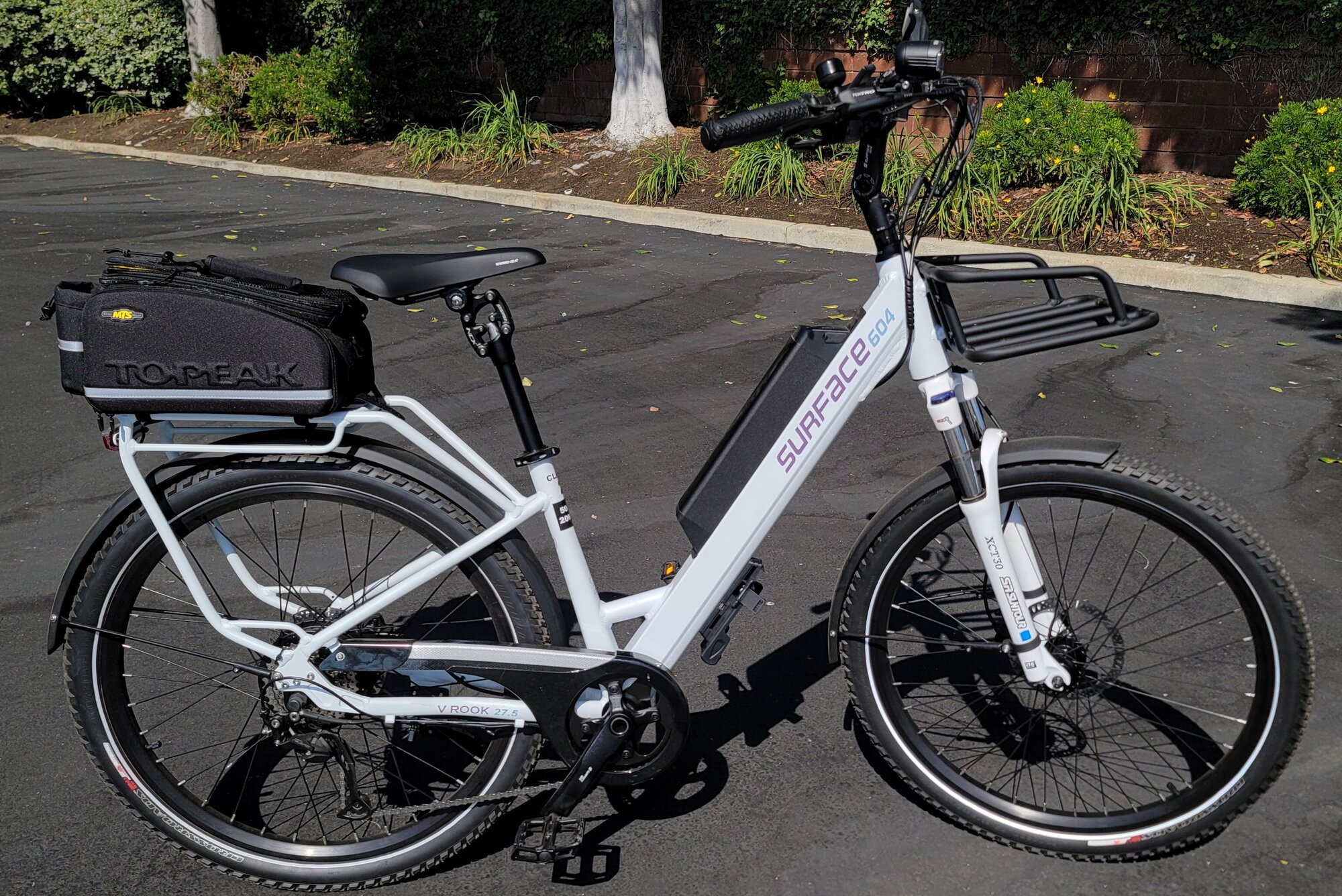

Storage is very personal. I do love my Topeak bag, and it expands to a position of carrying a weeks' worth of groceries, but that is of course not what everyone wants/needs. Hope you find the right fit!
