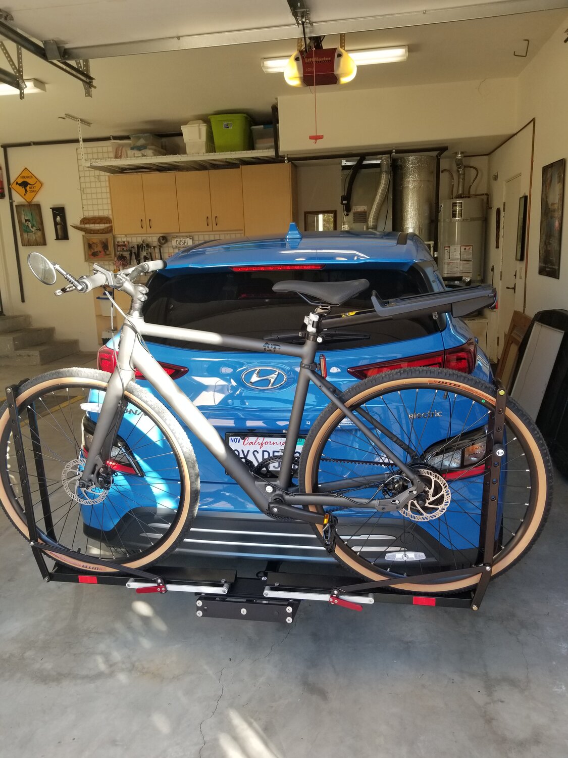

1 UP Quick Rack Single 1.25 has been great. Will carry my Gravelster at 35 lbs or my ESPN Sport at 60lbs. Very easy to set up and remove. I think I paid around 450.
