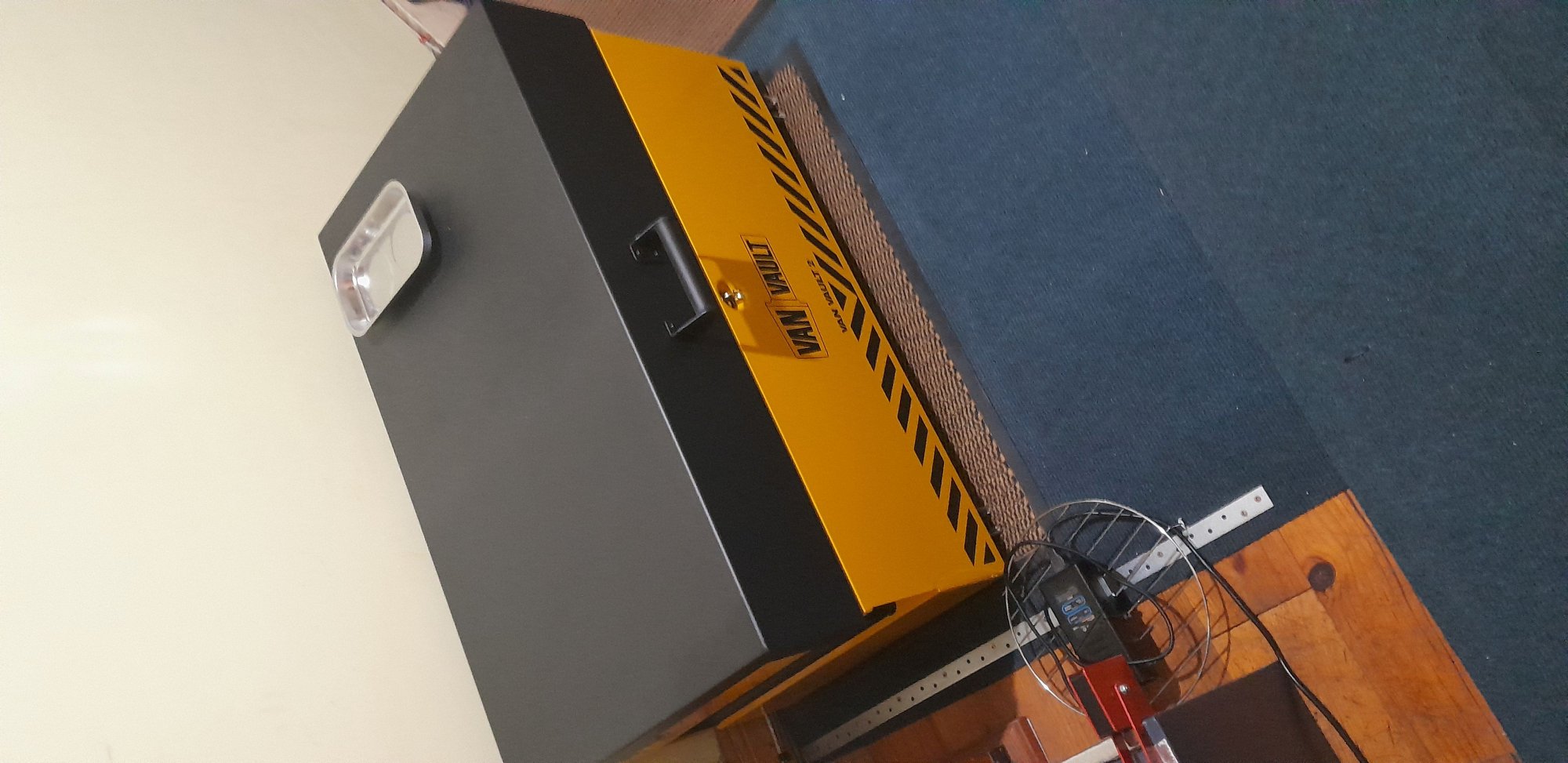

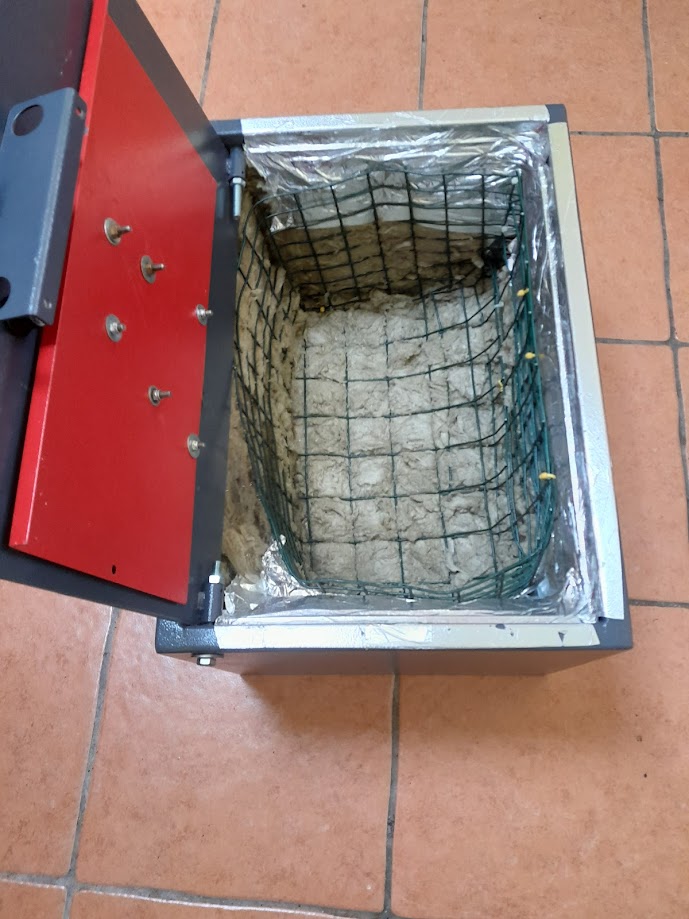

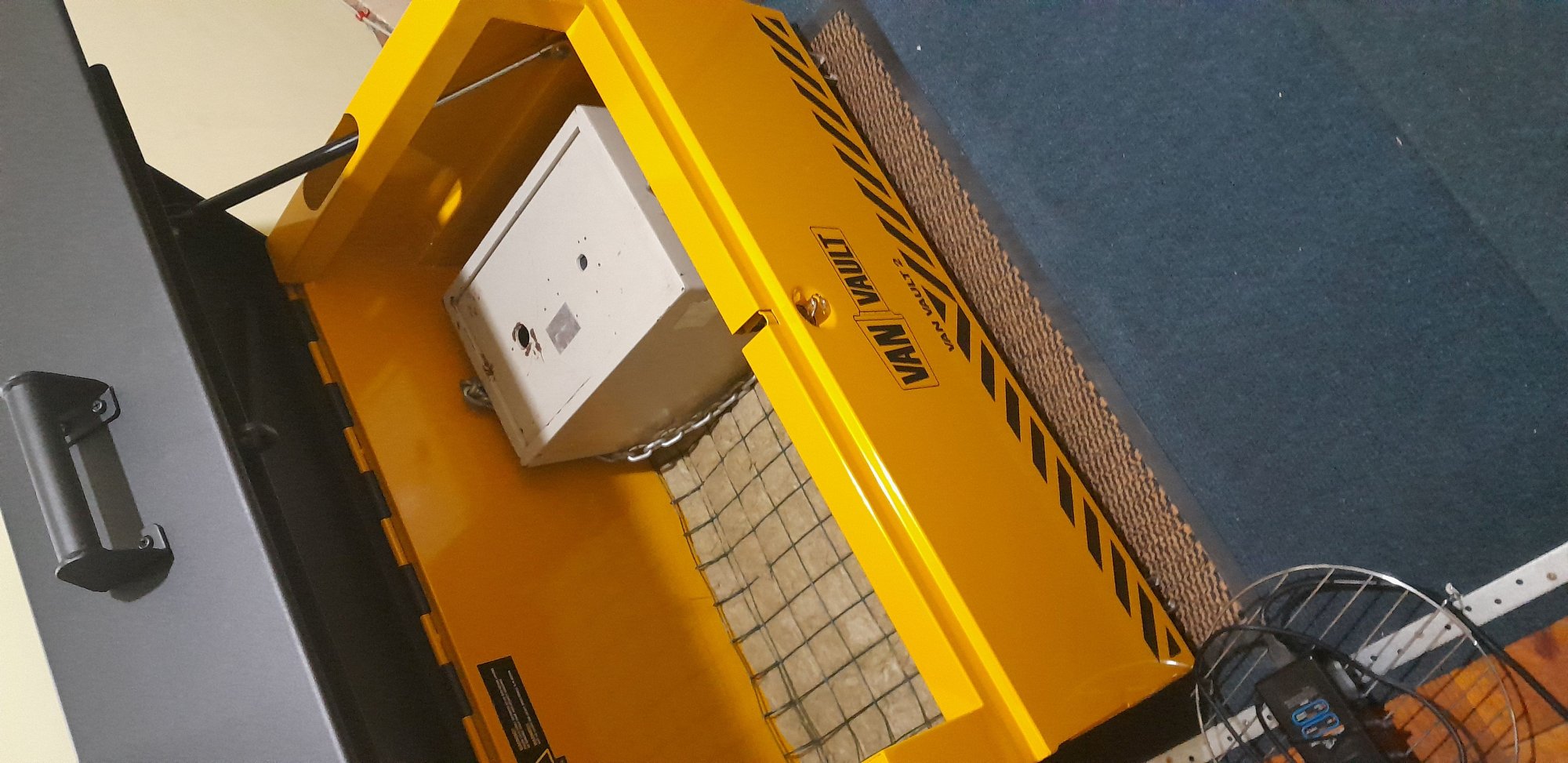

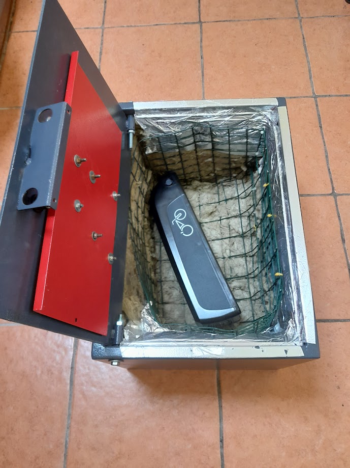

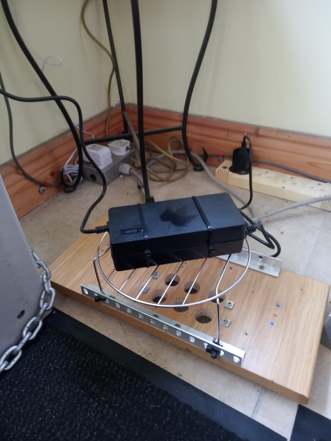

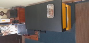

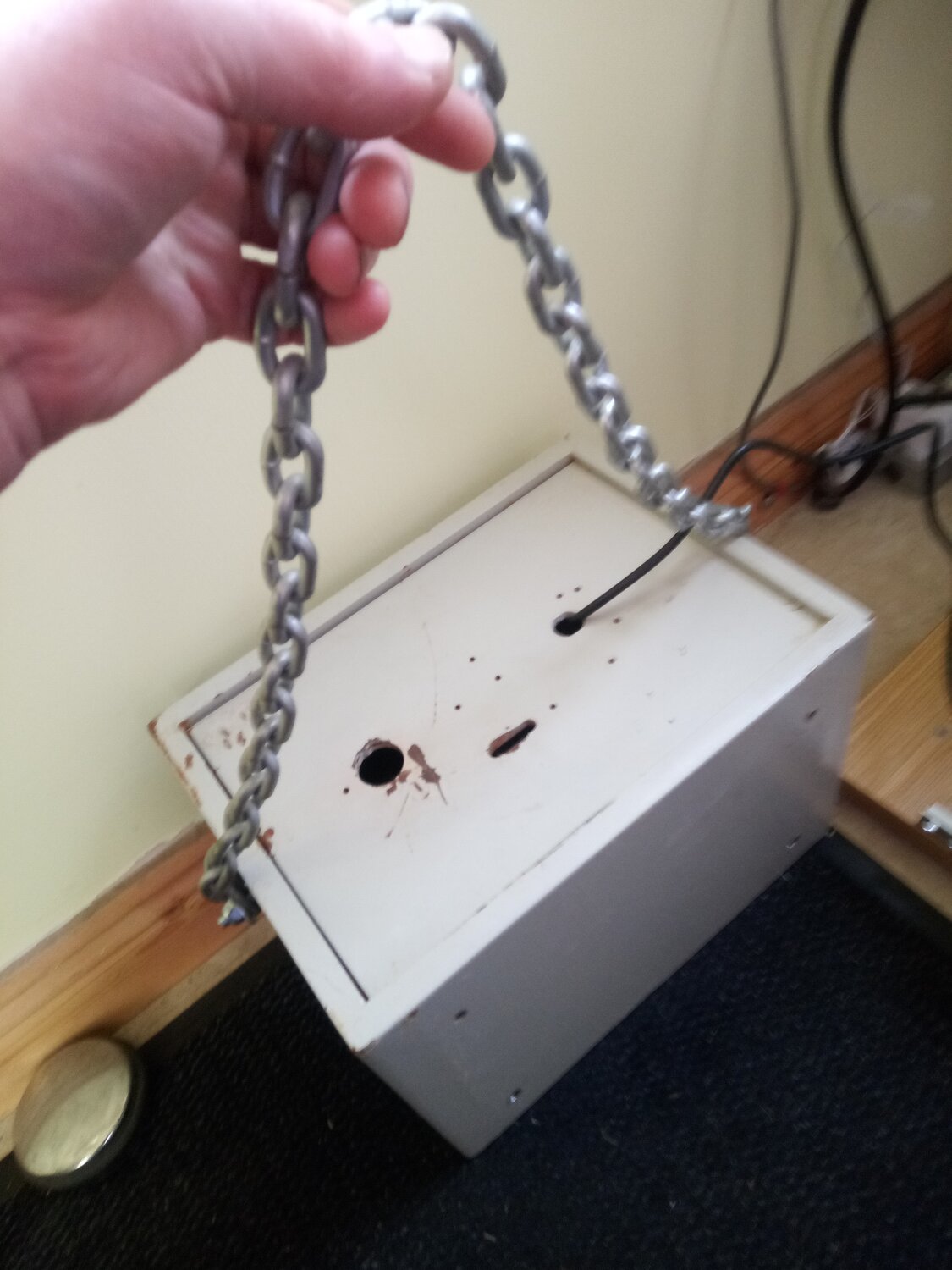

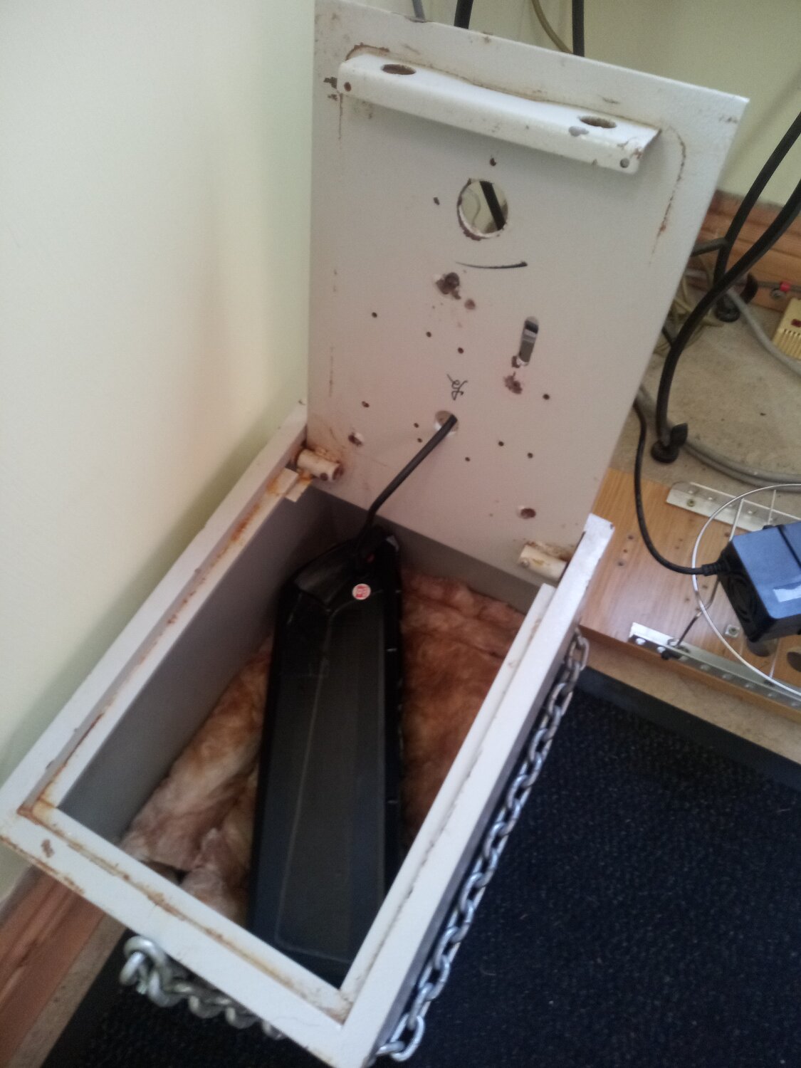

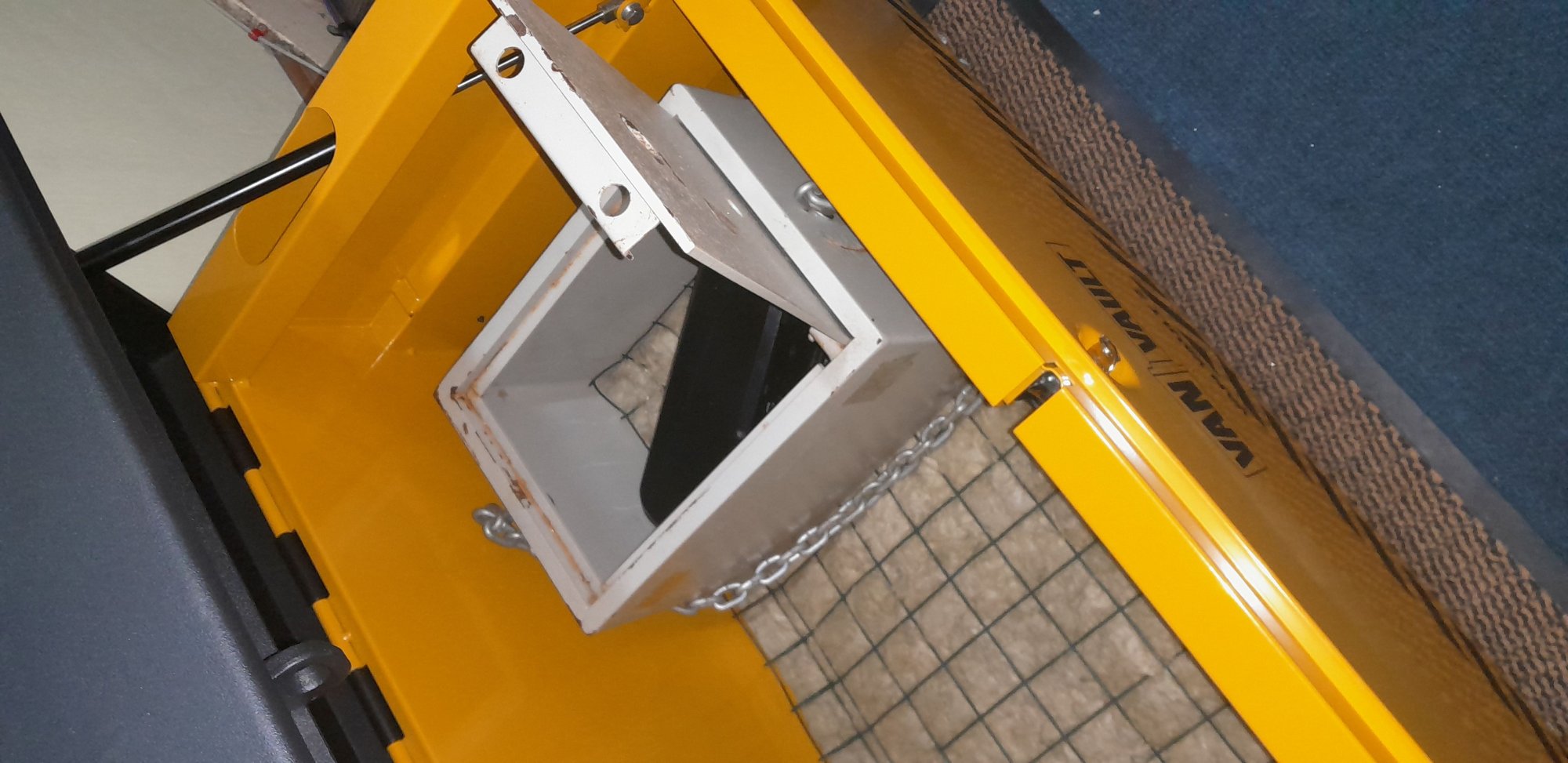

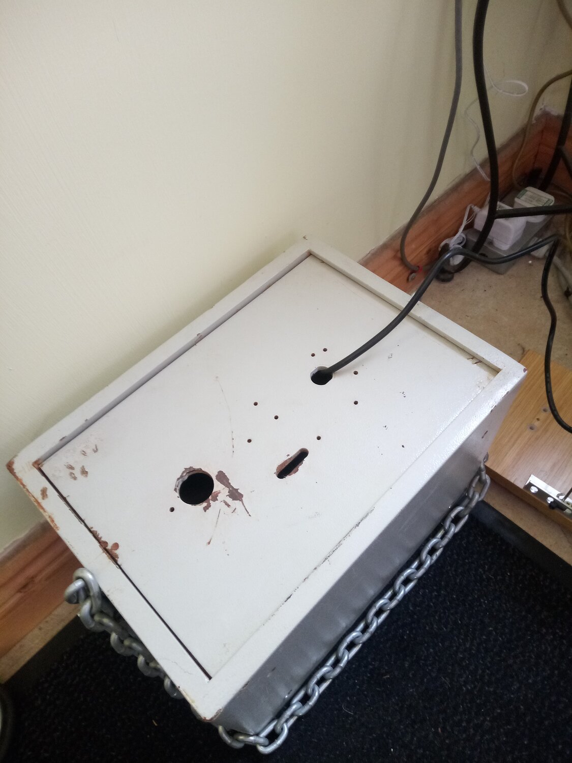

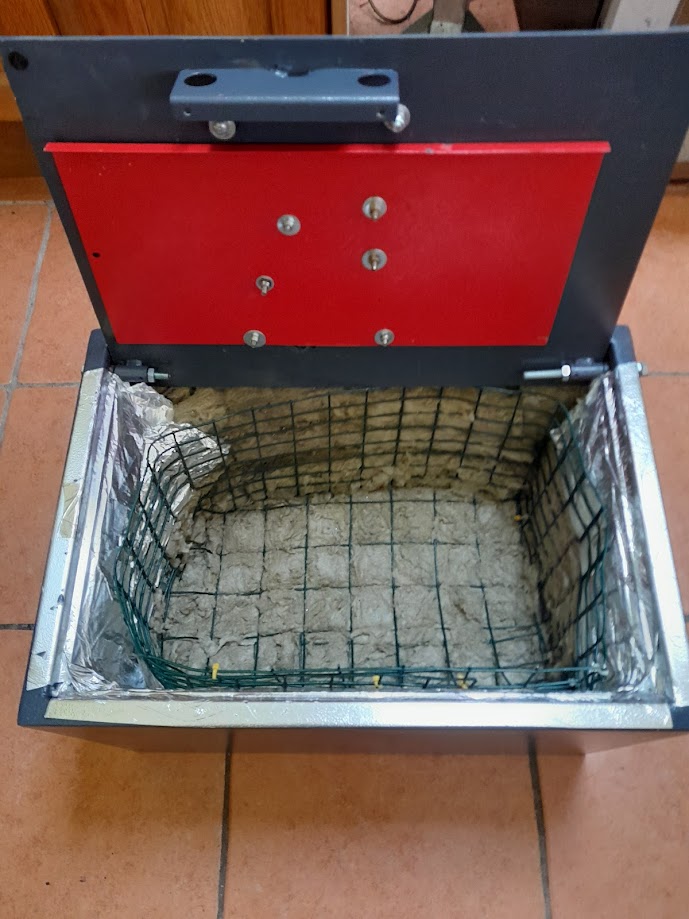

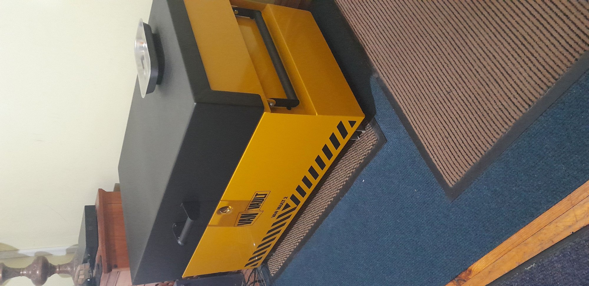

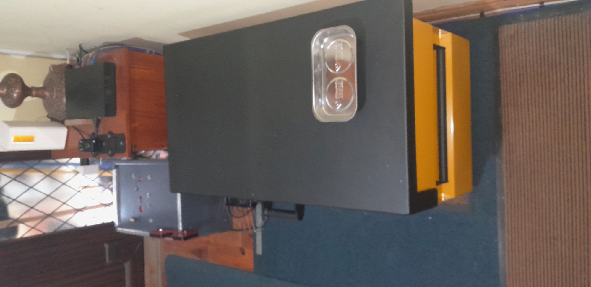

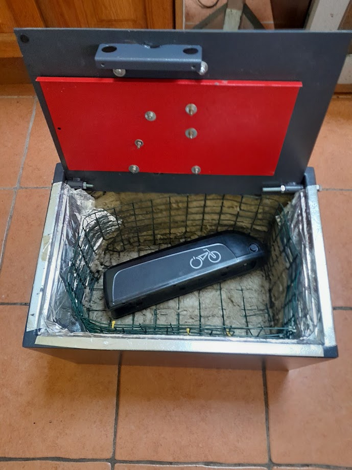

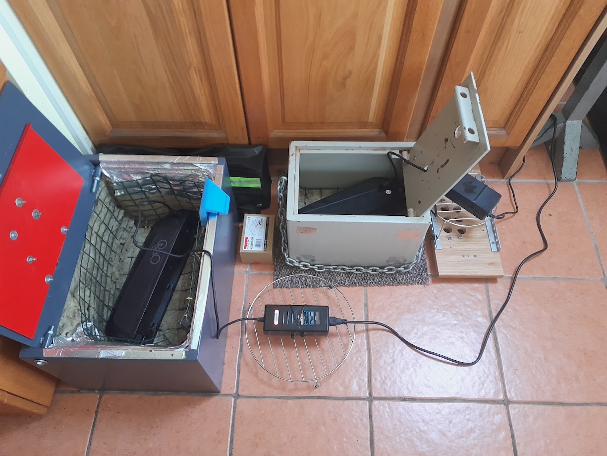

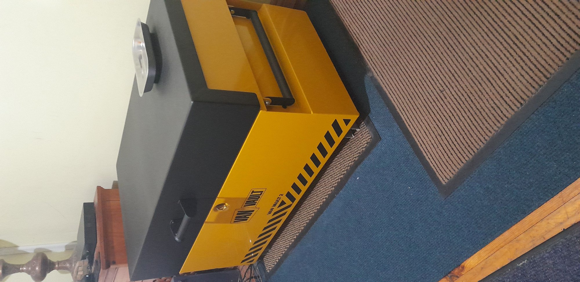

I use my bike to commute to and from work, But charge it at home. I charge my battery in an old safe which I have some Rock wool insulation in the floor of the safe, Also I have put a chain as a handle on the safe if something were to happen , I can pick it up and put it outside. , I have a smoke detector & powder filled fire extinguisher near to where I charge my battery. I mount my battery charger on an old metal rack/oven grill to let plenty of air circulated and keep the charger cool while charging. The battery normally takes 4 hours to fully charge, so once the charger goes green, I switch it off.
