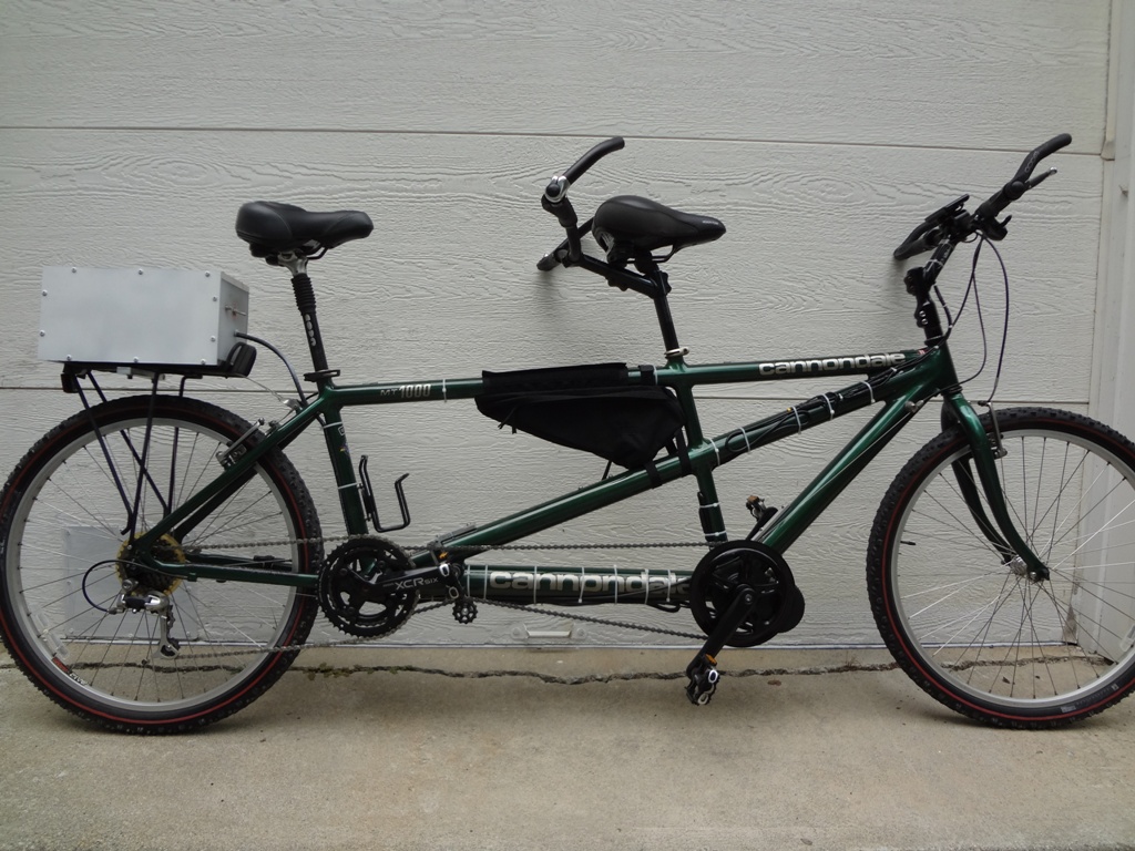

Not to bad on the weight side. The battery and motor add about 40 lbs. My wife weighs 125 and I weigh 170 so the total weight is reasonable. Yeah the lack of suspension makes the ride a little bumpy on occasion but we don't trail ride, we ride on pavement and on gravel roads. The only real downside so far is the battery brings the CG up quite a bit. It's most annoying when we aren't on the bike and I have to walk it, has a tendency to be top heavy. On the plus side, the 750W 48V system makes the tandem easy to ride. Hill climbing is a breeze.....the only change I had to make was to beef up the chain tensioner. The first tensioner pictured above would flex when we were pushing hard and we threw the chain off a couple of time. With the new tensioner the problem was solved. Court J.

My wife and I combined weigh about 290 lbs. so it's really not much different then an average weight pair on the bike. The bike does really well on grades taking a lot of grunting out of the ride. I limit the speed assist on the controller to 20MPH; no need to go flying along. So far the brakes haven't been a problem. If you like riding a tandem adding the Bafang kit is worth considering, makes longer distance touring a pleasure.

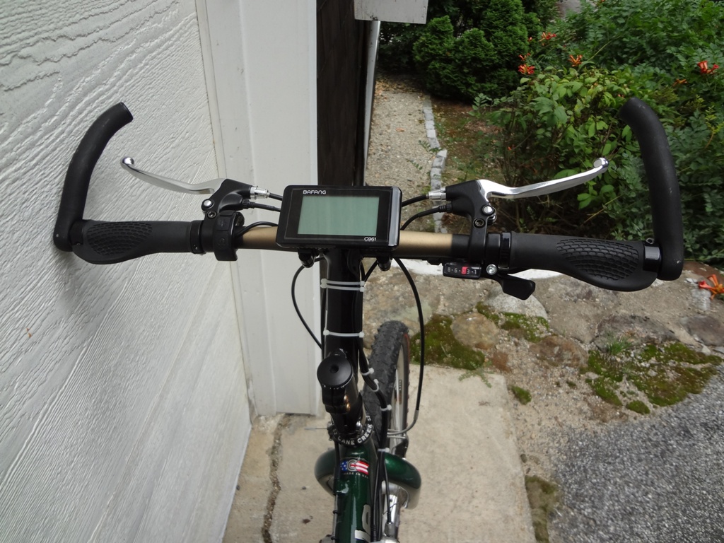

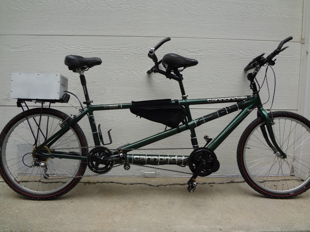

MT1000 IS DONE!!!!!!!....rode it home from my company and WOW, it climbs all the hills with very little peddling effort!!!! Frankly, it almost doesn't feel like a bicycle because you don't have to do any real hard peddling to top almost any hill. Here are some Pics:
View attachment 1545 View attachment 1546 View attachment 1547 View attachment 1548 View attachment 1549 View attachment 1550 s.

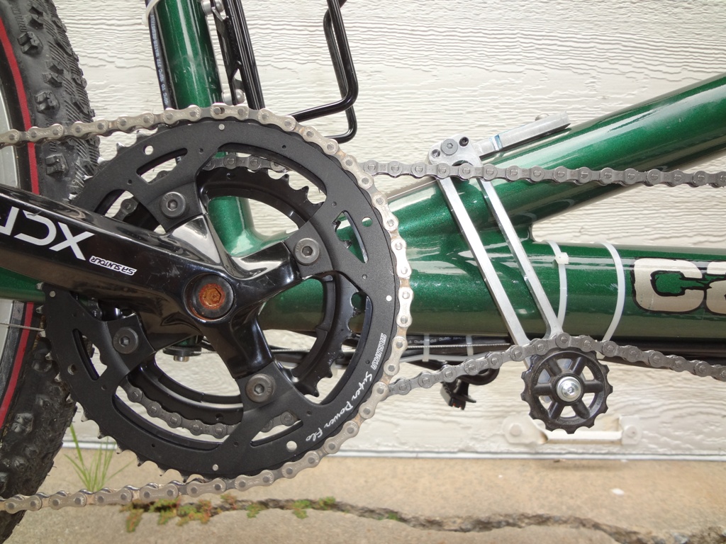

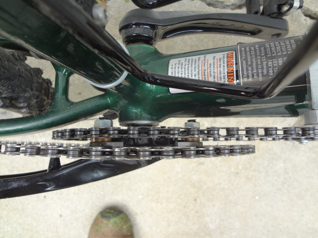

Couple of observations. Because the 8Fun chain ring is on the right side I had to modify the stokers chain ring holder. I made stand-offs to increase the space between the 48T ring and the 36T ring. If I were to build another Tandem I'd approach the problem with a different solution. Works, but not particularly elegant.

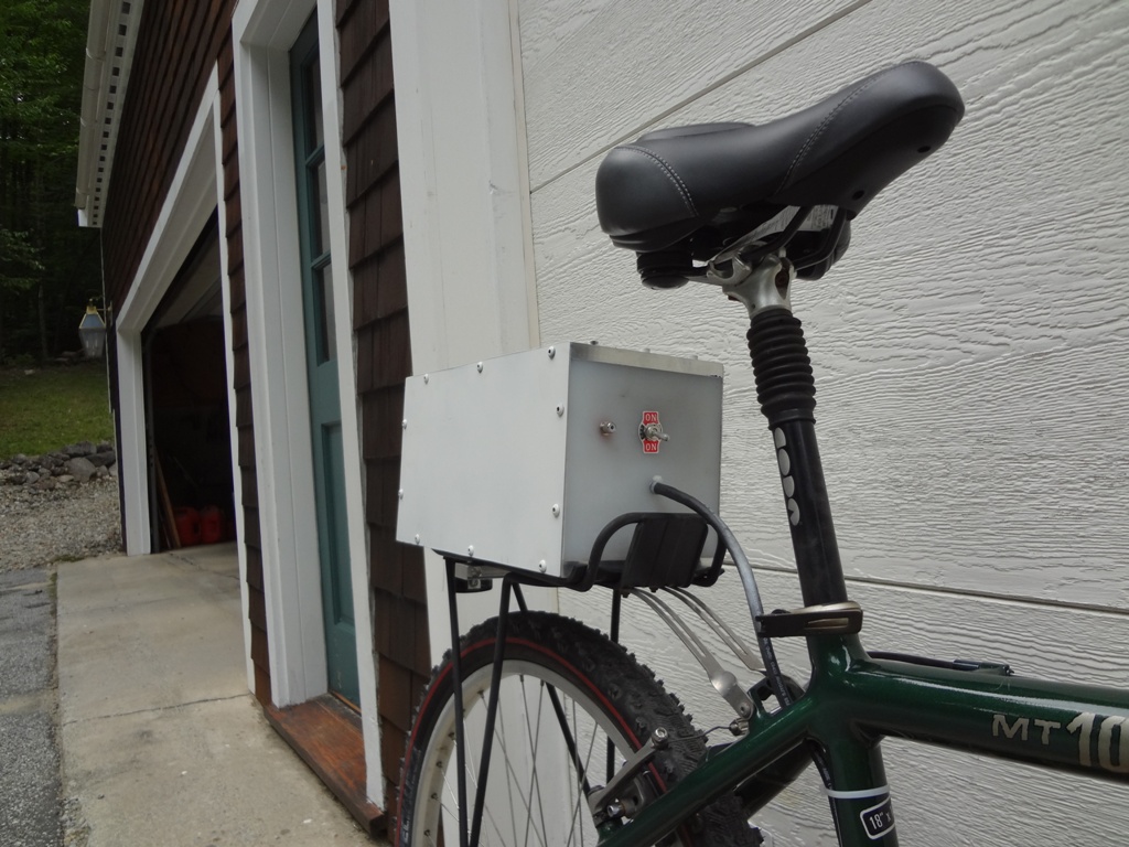

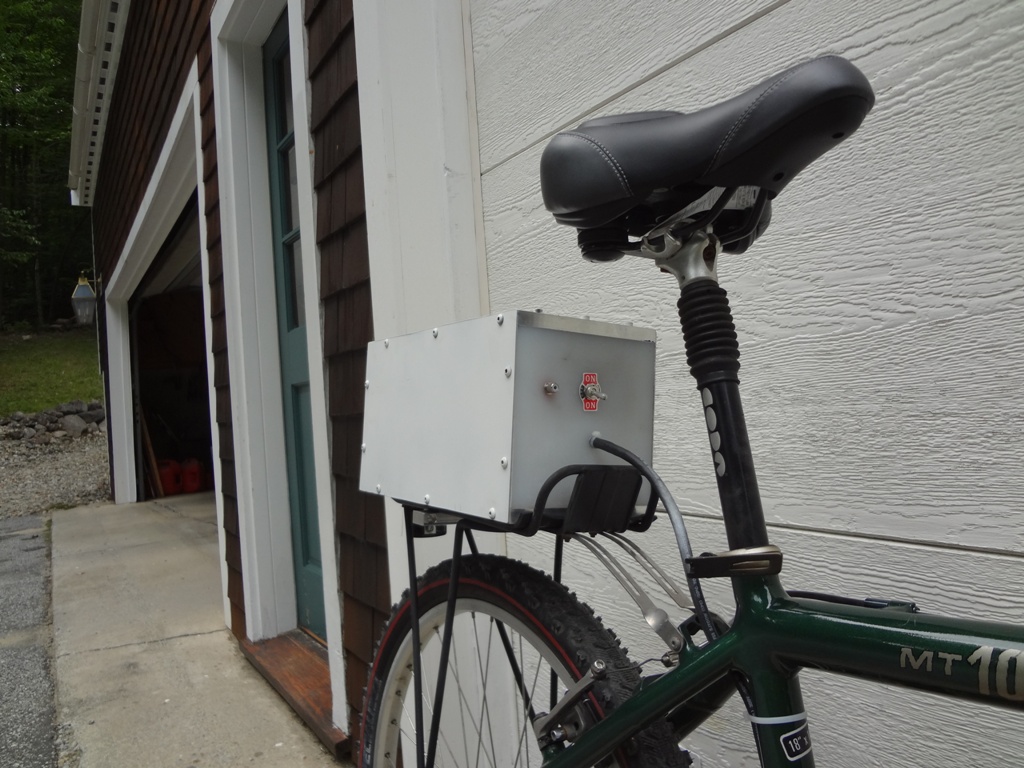

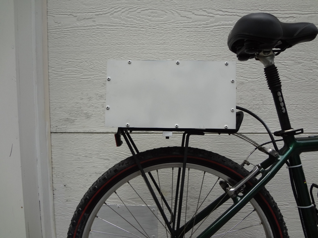

The battery box is big, bulky and heavy......don't really know what else could have been done. I'm glad I put the battery box on the E-Motobecane on the down tube. I'm afraid putting it on the rack would alter the handling significantly.

Laughing :D It really goes quite nicely with the BBS02 48V 750W. My only regret is placing the battery over the rear wheel. If I ever make another I'd locate the battery somewhere else. I'd also entertain thoughts (if I was 30-40 years younger) of doing a tandem for cross country. Buy or build a trailer to tow and put the battery there. You could easily end up with a very capable 150+ mile E-Tandem. Heck...I might just do it for the challenge!
View attachment 1545View attachment 1546View attachment 1547View attachment 1548View attachment 1549View attachment 1550 s.

I have a gear sensor to the setup - so the motor cuts off during shifts. There's a lot of torque on a tandem so probably a good option to have to protect the drivetrain. On the 2005 Cannondale Mountain Tandem, there was a standoff on the bottom of the stoker position that was used to anchor the front derailleur. To make the fit easier, I ground down the standoff (it was about 1/4"). That was it. The BB, installation for the mid-drive was the same as for a single bike. I did change the chainrings for the timing chain and the front chainring to 34T. The total weight of riders / bike / setup is around 300 lbs. We can do either full assist or partial assist on over 20 degree climbs without straining the drivetrain. One of the deciding factors in going this way for me was the control over how power was applied to bias for torque (for hill-climbing) or speed with this type of approach. There's some good online bike calculators like the one I used at http://www.kreuzotter.de/english/espeed.htm to help you plan for your setup. It would probably be worth a few mins to plan your setup for your 6 gear ratios.
