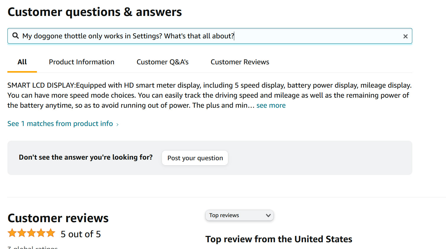

If there's nothing in the settings, than start by posting a question on the vendor's question area. Also send him an email.
You can play hardball and post a 1 star review if you contact the seller via amazon's menu, and get no answer. I'm kind of expecting Mr. Pex-Mor to ignore you, but persist.
