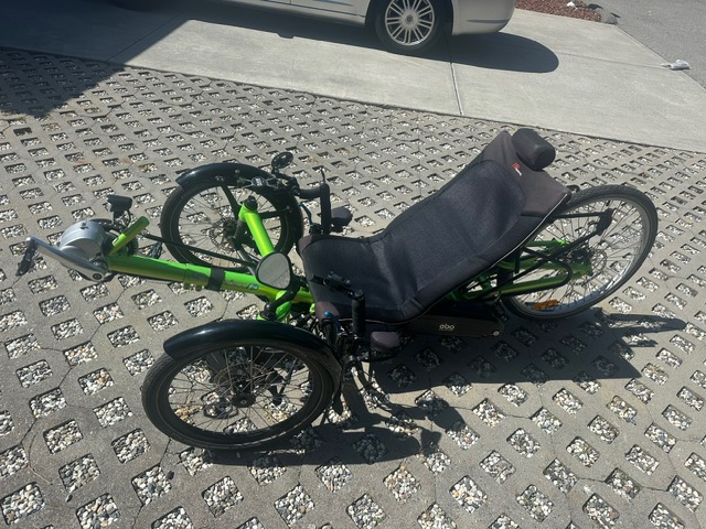

I just made this one with a DM02 mid-drive. It had an unsupported botched job of a hub-drive. The owner is super happy and impressed with the weight loss and with how quiet it is.

looks great,is it quiet? The trail I wont to use( several miles RR bed is restricted to non motorized rolling stock and believe it or not Horses( talk about something that tears up a trail) I figure I can get by with a quiet stealthy unassuming ebike.

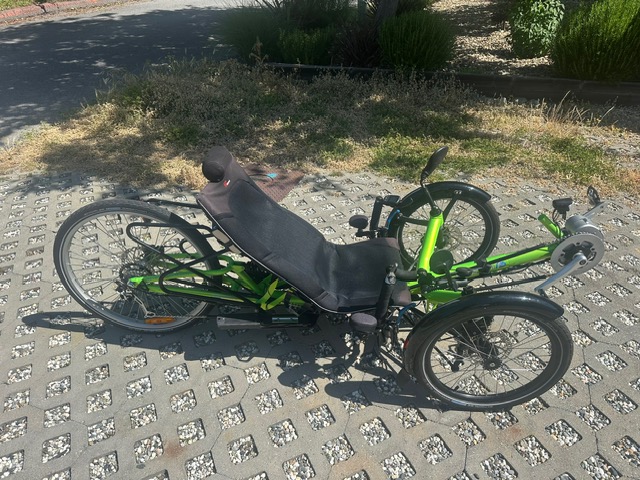

If there is any traffic or wind you cannot hear that motor on that bike at all. I mounted it levered against a custom solid rubber bushing that does not transmit vibrations or sounds. So, it is not just the motor, it is also the way it is installed. The bushing is between the upper back of the motor and that vertical front part of the frame where the headlight is mounted. I painted the motor with automotive engine paint to match the polished crank arms. I had to allow for the telescopic boom and for folding.

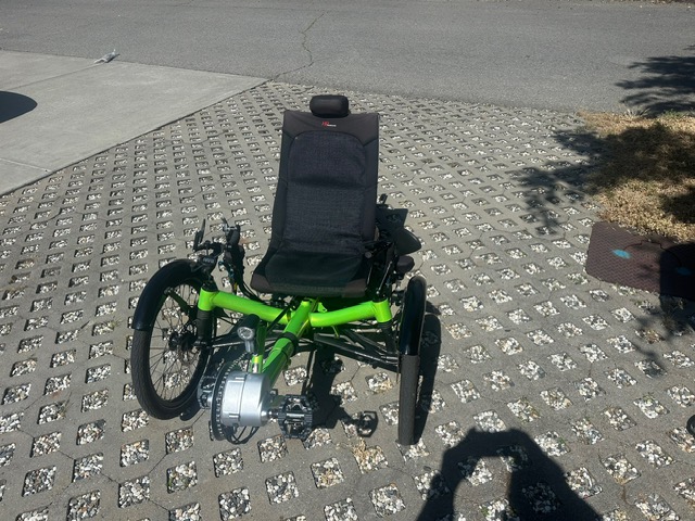

Here is the other side of that one. I worked on another eTrike today and put two eTrike riders together who live close. Ditching the hub-drive lost so much weight, and handling is much better. As well as efficiency and feel. I topped the speed to 26, could have made it much more. But, 26 is really all a person needs on one of these low bikes.
