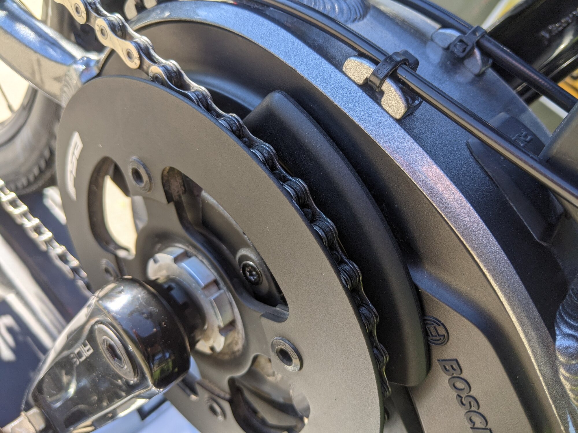

Trek published a fix for the chain suck problem. I had been carrying a spring hook tool that worked great for re-installing the chain until the fix came out. Trek will order and install the fix for free. Also, my dealer told me that 10 out of 10 bikes they have installed the fix on the nut holding the crank was loose. They felt the problem could also be resolved with some thread lock and tightening the nut.
Picked up the bike from the LBS this morning, and this is the part from Trek that they installed (no charge):
Look like it should do the trick.
More info here:
I have a Verve+3 and lost my chain off the front a week ago. I was playing around with the range numbers and had just kicked up on turbo and did a hard up shift. It took a couple minutes but got it back on. One problem with a chain guard it’s a little hard to get in there and get the chain in.
