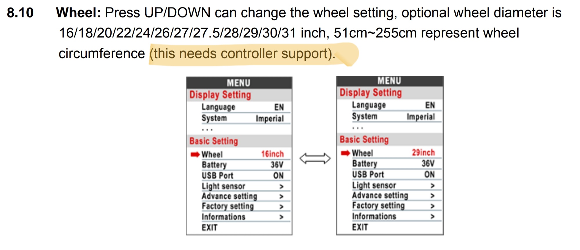

I'm wondering if it is an Ultra only situation... Or newer hardware?.. but I don't have the option to set As per Display for Wheel Size in the controller and I don't know why you can't access it.... Maybe unless it needs to be correct in the controller first.
I stand corrected on the 860c settings... It's been so long since my initial setup and there is a wheel setting. But the instructions still lead me to believe that it needs to be set correctly in the controller primarily.

This is why I think you need to see what the controller is set to... and start there.
Again coming from a different setup... I can't use the cm setting which is circumference (and more accurate) because the controller doesn't support it as the only choices are for diameter and in inches. I'm assuming that the two settings should be matched.
From what I've seen in other posts... The Ultra is the same. Let us know when you get the cable
