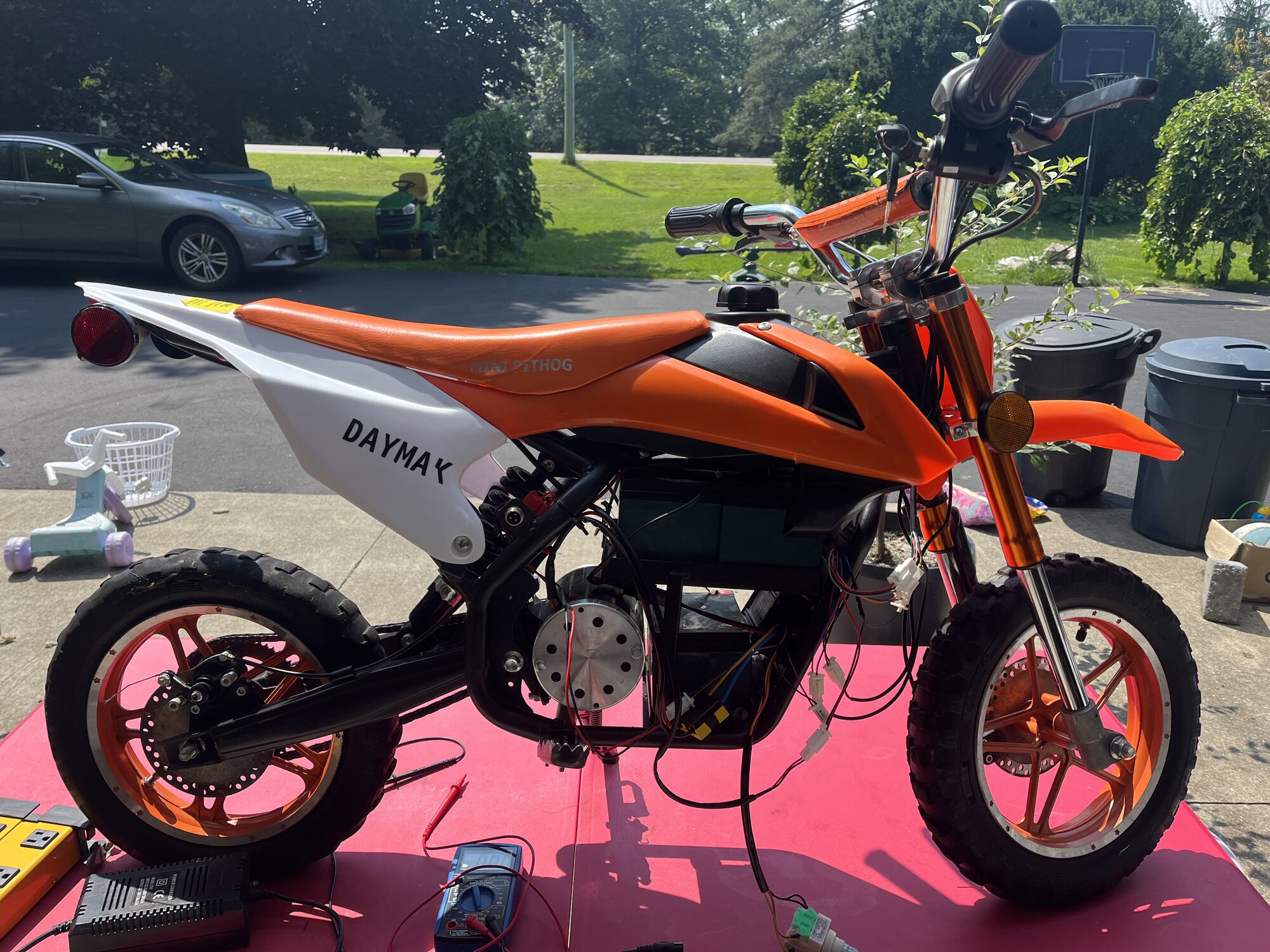

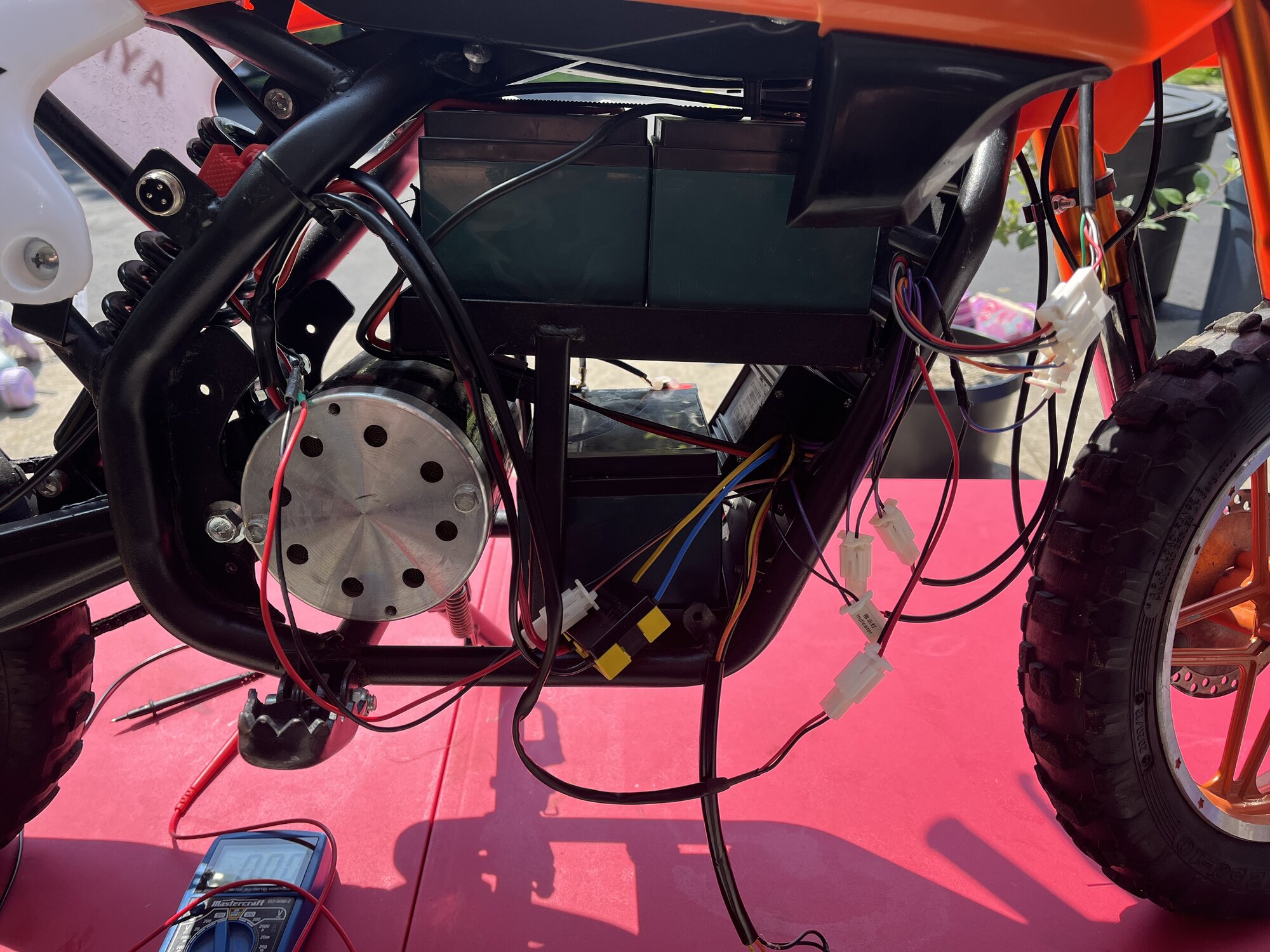

Hello I recently bought a daymak mini Pithog for my daughter, the throttle was broken back tire was slashed and the side panels missing.
I was told it worked perfectly before the throttle broke, I replaced the throttle and have new tires on the way the problem now is that even with the new throttle I am getting no power to the wheel (I tested the motor on its own and it works) I am hoping one of you fine humans owns one of these and can go threw the wiring from the controller and help me be sure it’s wired properly. Of the wires are ran properly then I can narrow it down to a bad controller. Picture for attention!!!

If it were me and I had that little electric dirt bike, I'd do a KT conversion.
You've got a working motor, and a working battery.
That's all you need to install a KT conversion kit.
You don't need to have pedals or a PAS sensor installed. (I have no PAS sensor connected)
Ditch EVERYTHING on the dirt bike and do a clean install starting with the motor and battery and build it up from there.
A couple hundred bucks will Get Er Dun.
No need to try and troubleshoot a troublesome system with little documentation.

That’s some good advice. I did however manage to figure it out. It was the batteries all along I have ordered some new ones so I should be up and running in a week. I do like the idea of building my own tho I think I might do a small dune buggy. I have a great body from an old power wheels dune racer. I will just need to weld up a frame and add some suspension and proper steering.

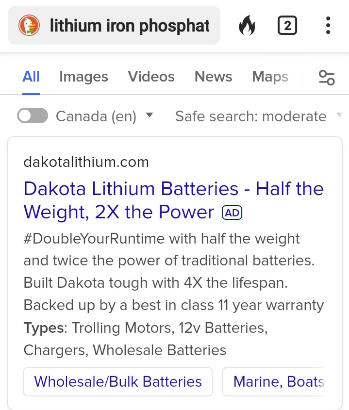

I don't know if your dirt bike has lithium or SLA batteries, but you might want to consider lithium batteries for your build.
Lithium iron phosphate batteries are a good choice too, but Don't plug an iron battery into a regular li-ion battery charger. They has different voltages.
