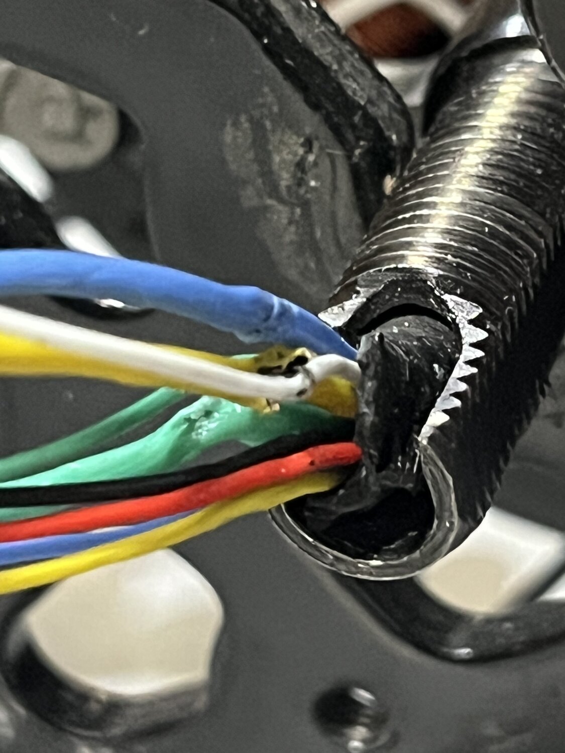

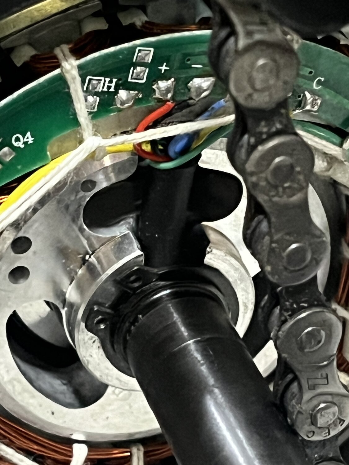

Question for the group if someone can help me. I had a chain jump off and damaged wires coming out through the hub/axle. I’ve separated to ensure no shorts I think but it’s strange the motor only engages with throttle when I free spin the tire backwards and then it engages in proper forward direction. It doesn’t work when I pedal or spin tire in forward direction. Assume I am missing a short or something? I tried disconnecting brake wires but no luck.

@harryS is correct. Do you have any error codes on the display? Either the short messed up the inside of the motor or the controller. What is the bike and can you show some photos? It is a hub-drive and those cores can be swapped.

It doesn’t appear to be anything mechanical. I can pedal fine and it freewheels fine but there is no propulsion from the electric motor with the throttle depressed until I spin the tire backwards
Oh for sure wires are damaged I just didn’t understand why it actually works when I spin the tire backwards but not forwards?
