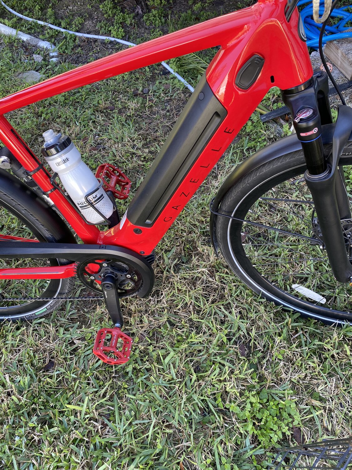

The fastest I have had my Bosch is 44mph going downhill on Route 250 atop Afton Mountain heading downhill eastbound. My eyes were watering for sure.

Didn't you dream of having a warm jacket on you, too? :)
Not that day! I rode from our RV park up the mountain to the Blue Ridge Tunnel and through it back and forth. Then the fast trip down the mountain.
