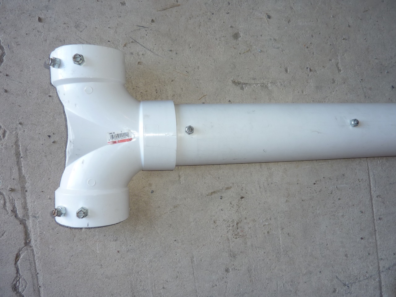

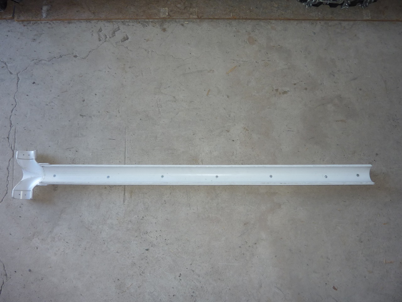

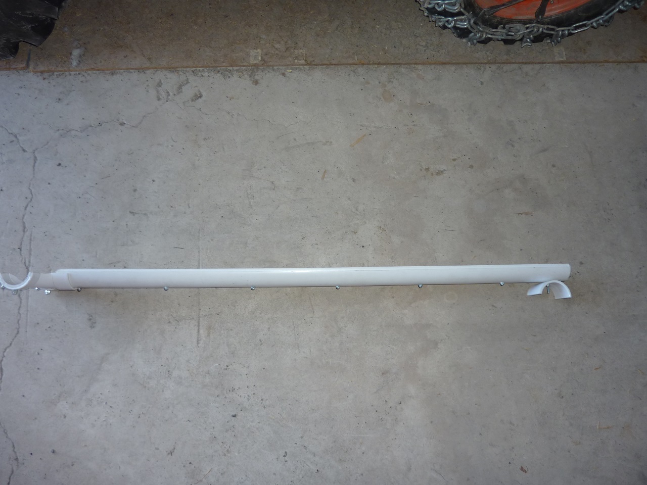

I made this one from a 6' piece of 4" PVC pipe. I use it to roll my bike up into the bed of my pickup:
I split the pipe in half and bolted the pieces together. I cut a 4" tee in half and bolted it to the end for stability. The lag screws keep it from sliding around. The short half pipe on the other end hooks to the bumper. It's weatherproof, lightweight and plenty strong for my 70# bike.
I needed a 6' ramp for the high bed of my pickup but you may be able to use something shorter for your SUV.
