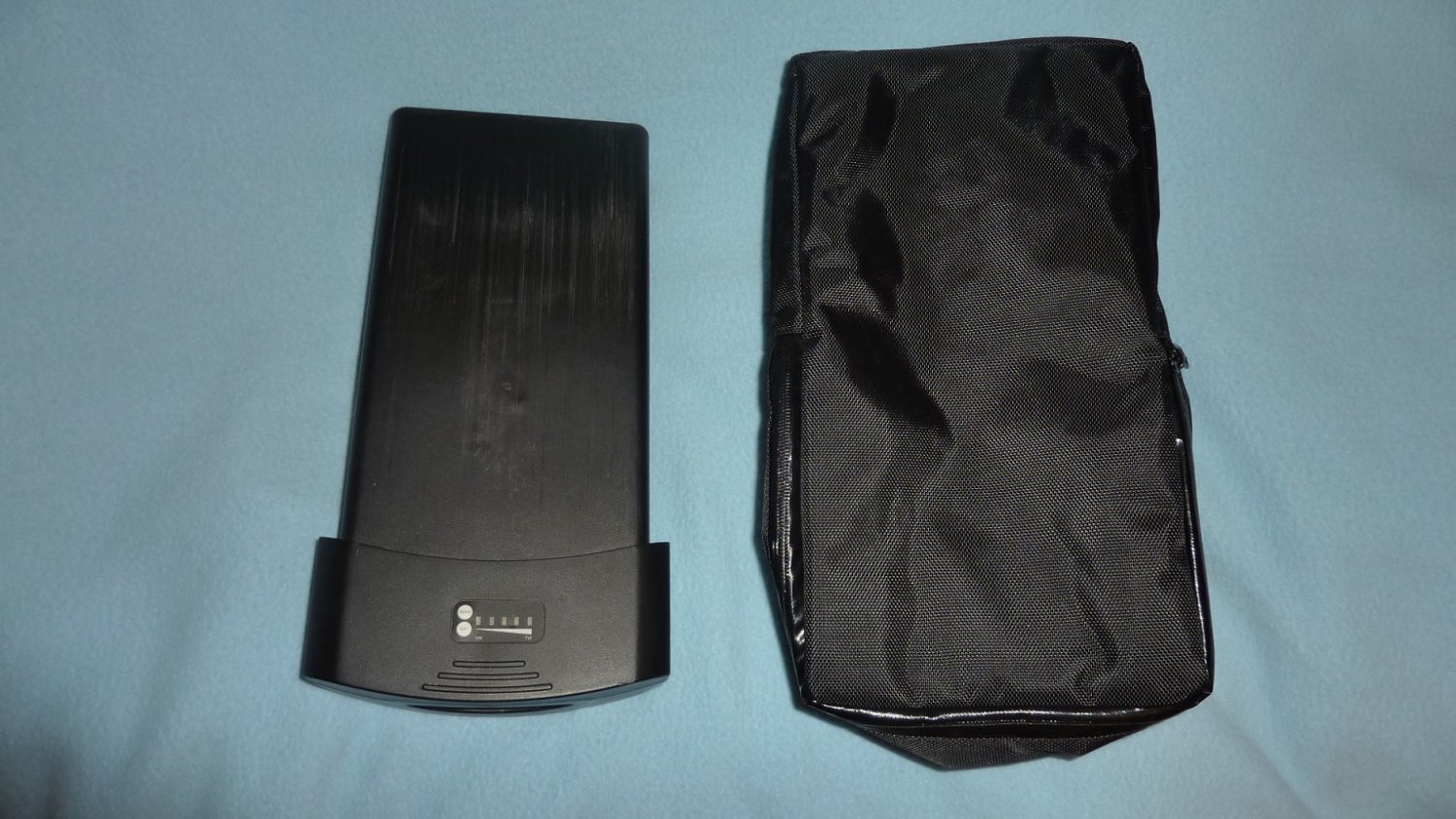

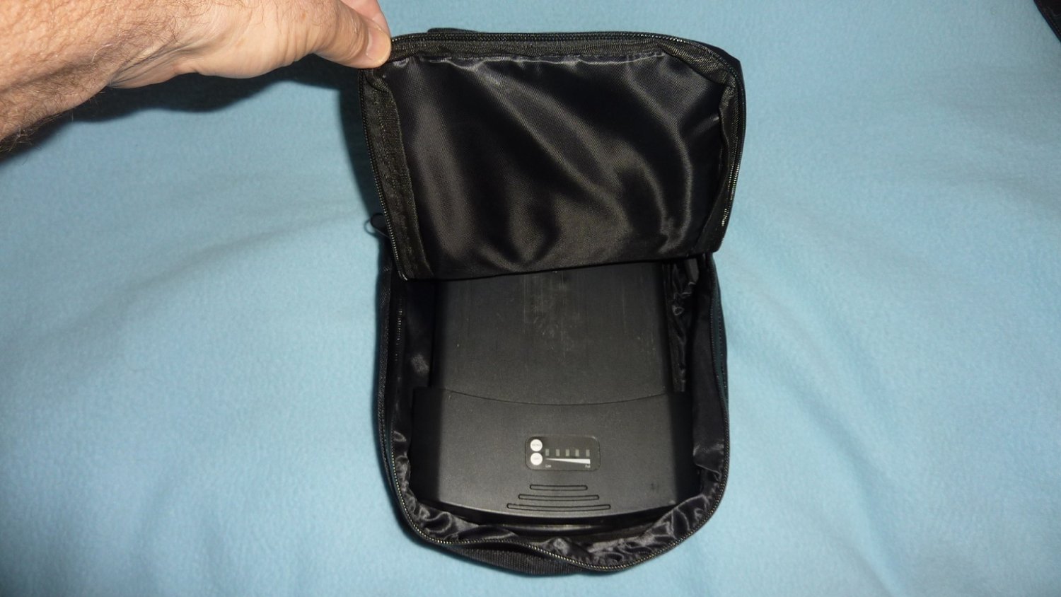

I also use these padded battery bags for added protection:

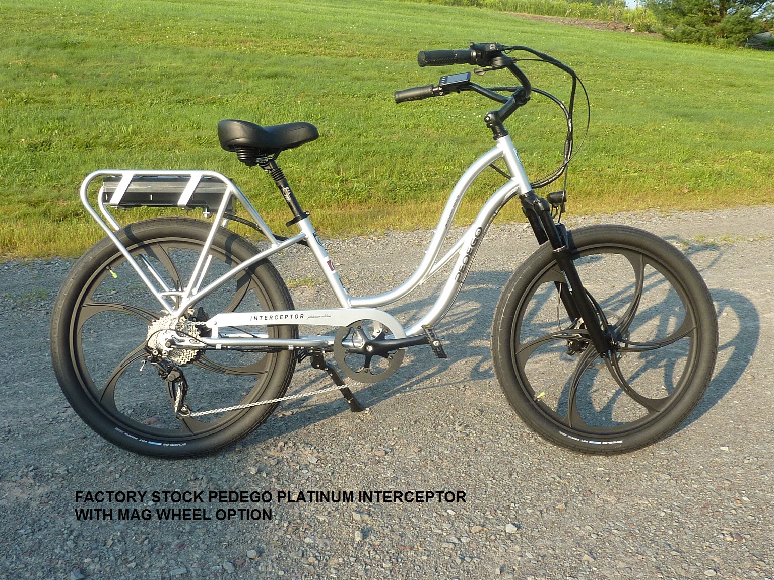

I have this rack on the back of my bike:
The problem is that there are several holes that the panniers can get into the rear spokes, and that won't be good.

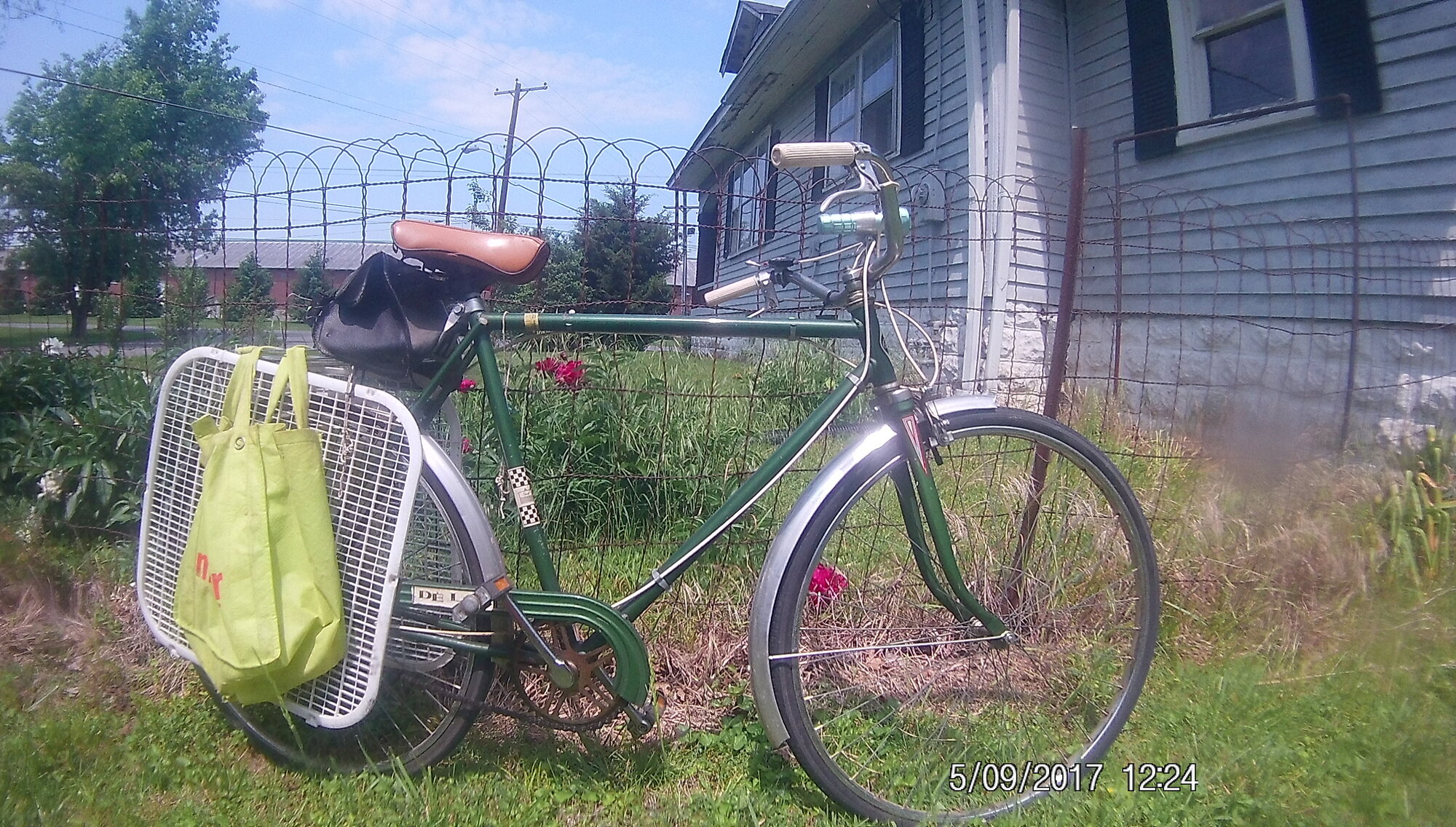

On my Austrian 3 speed where I shop with reuseable grocery bags, I hang box fan covers from the rack. There are dozens of box fans out for the garbage in the spring. Throw everything away but the plastic covers.
I love how diyaudio chops the useful part off of pictures.

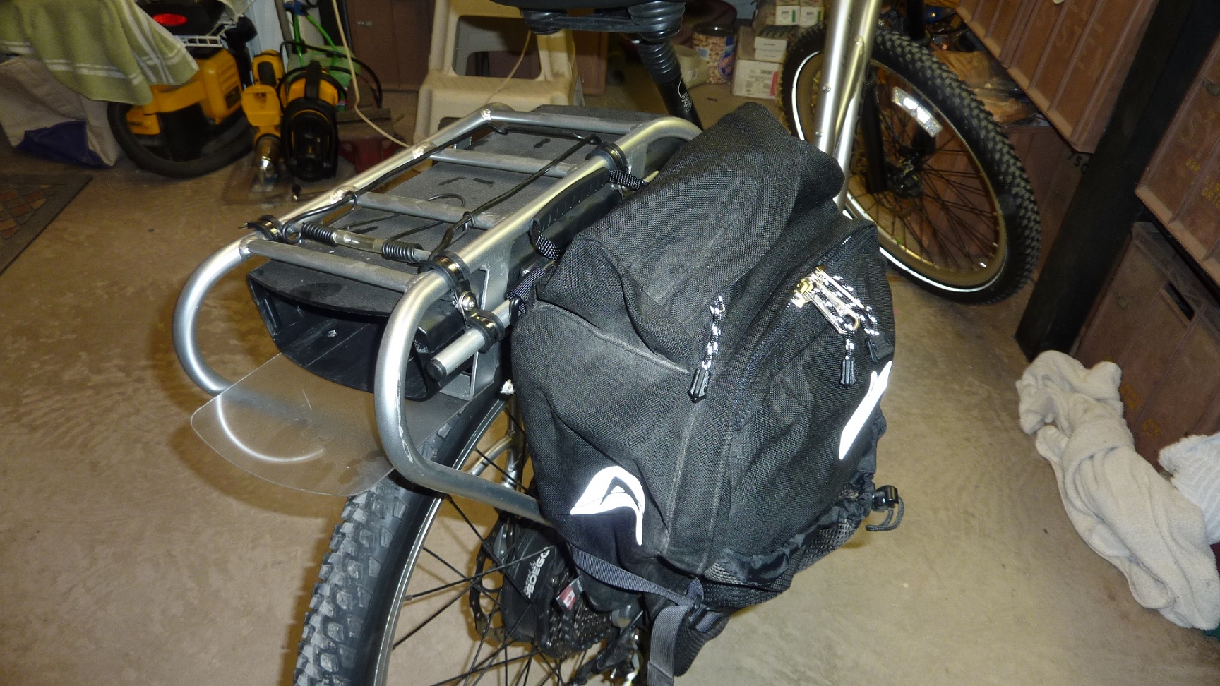

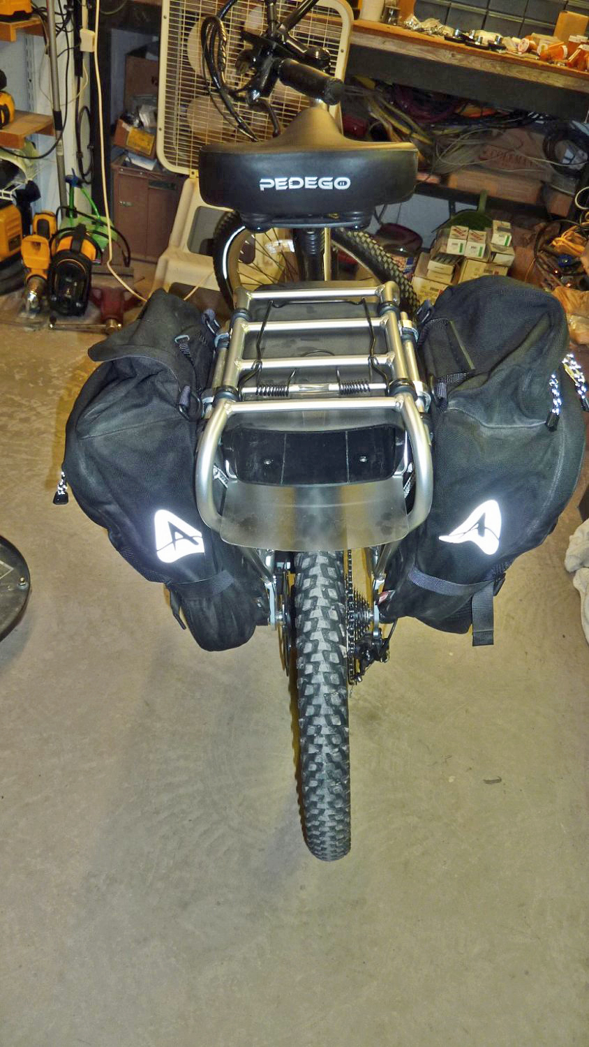

I have several Arkel's, including the T-28 and T- 42 models. My favorite is the GT-18 but it may be too short for an 18" battery. All have rigid backboards and use the same rail mount hardware. They also have oversize rail mounts for bikes with rack tubing greater than .5" diameter.
The rear rack on one of my bikes is more "open" than yours and these panniers work fine:
The pics show the T - 42's which I recommend for an 18" long battery. It can be placed diagonally for a better fit. There will still be a lot of space to pack other gear to act as a cushion for battery protection.
