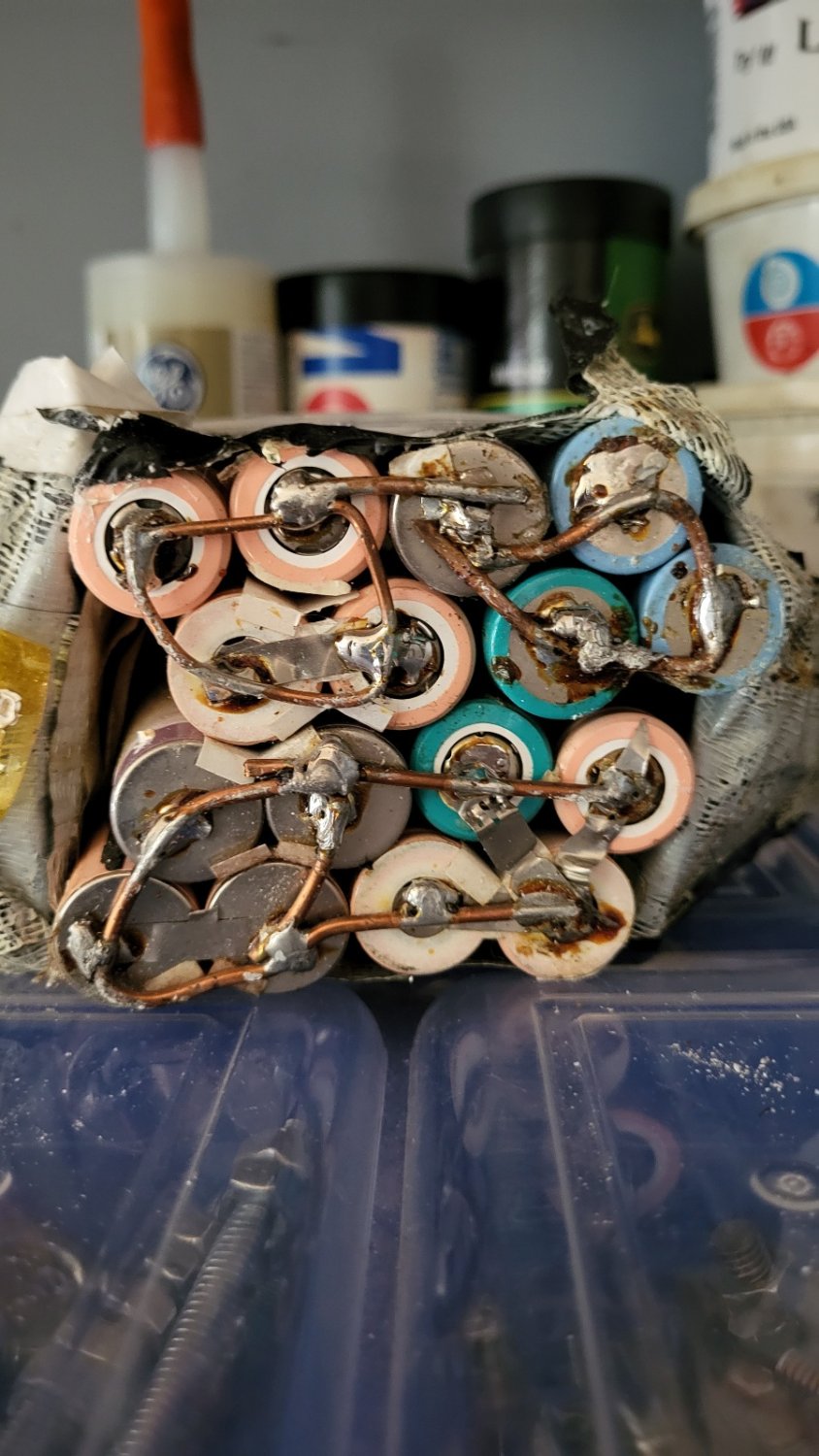

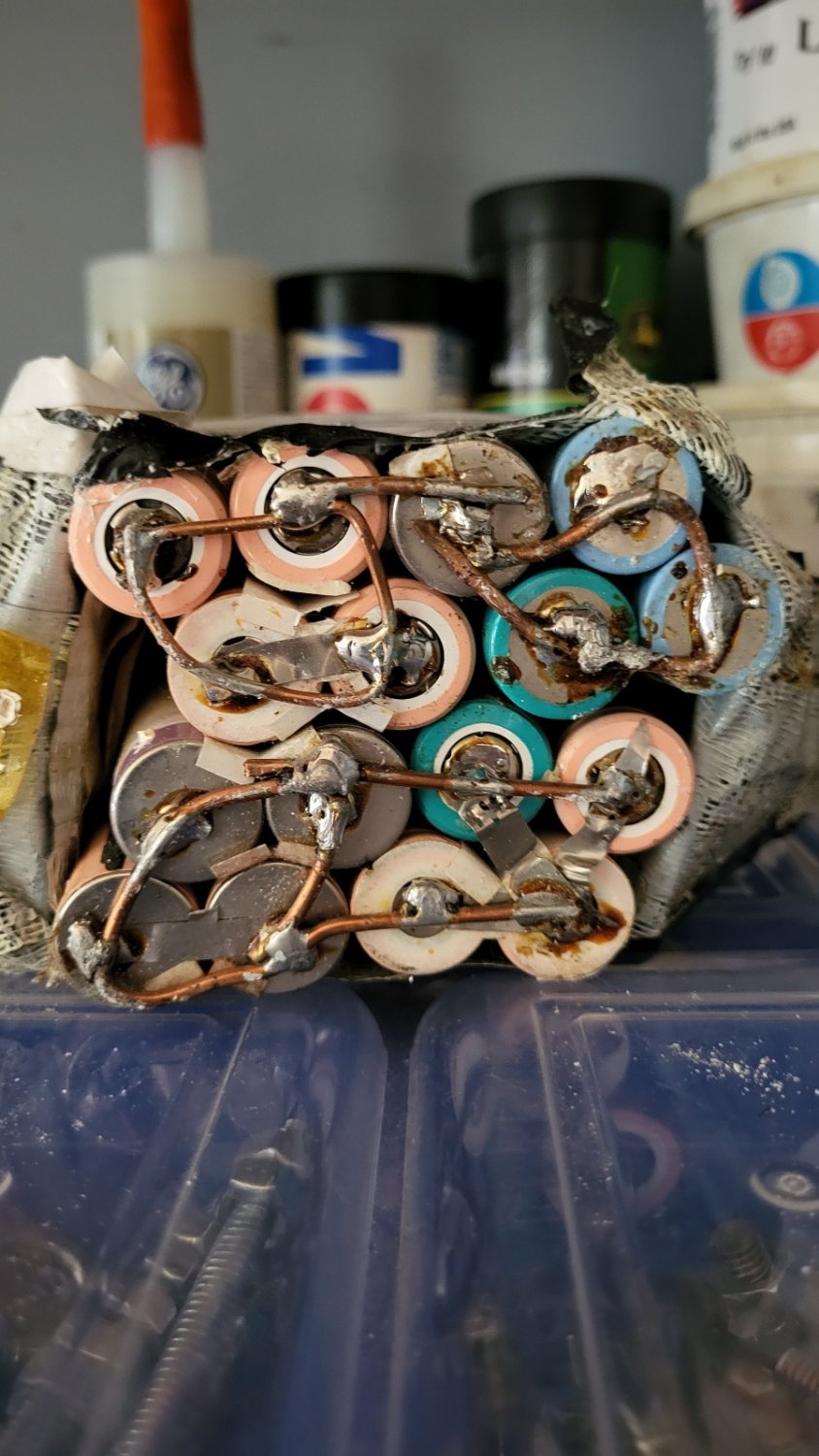

4P4S soldered solid core house wire 12 Volt battery FTW,..
Hasn't blowed up yet.
It's been 10-15 years on the shelf.
Hahahah - oh my, its like a drug addict had just enough spares found a few vape pens in the street - and sold it for $20.

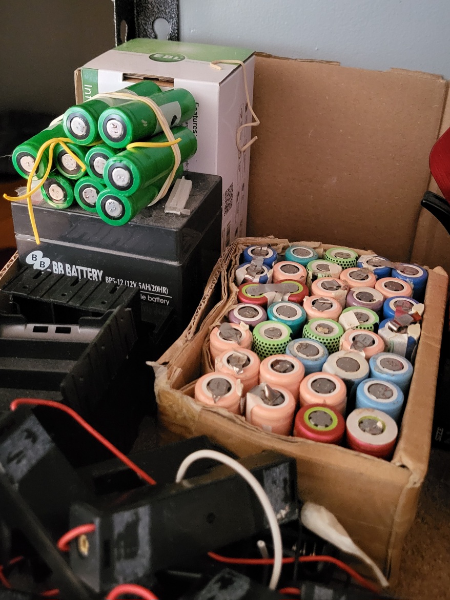

I bought a used ebike about 10 years ago that was already 10-15 years old.
It came with new SLA batteries but the guy was experimenting with making a lithium battery for it using lithium cells from old laptop computers.
He gave me all the lithium cells including the ones he soldered together.
I never did get around to making a battery, but I bought a 36 V BMS to help make it a little bit safer.
He would charge the pack with a 12V battery charger for a car.
Another neighbor at the time set his garage on fire charging his homemade battery that way.
