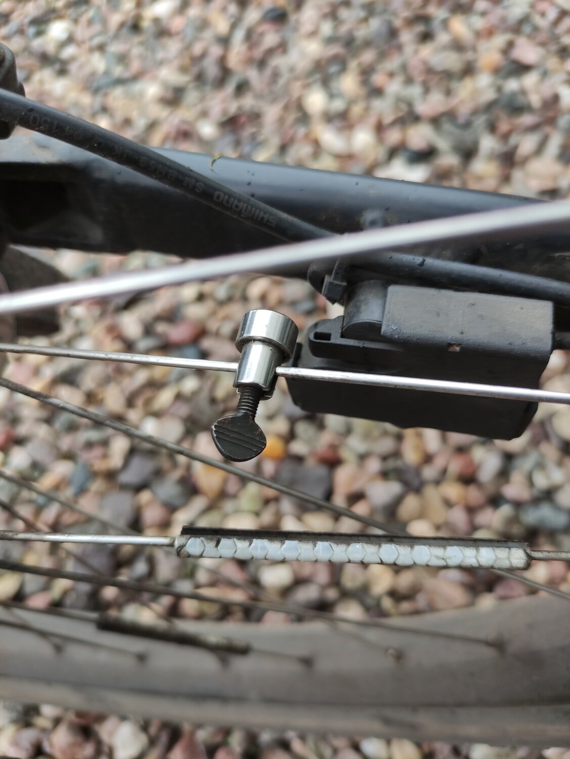

hello . so far 2 10 mile rides to work and back without issue. heres a pic of my magnet and box. im 95% sure that is the original magnet as when i bought the box 3/4 years ago they supplied the butterfly screw. not to get into the restriction speed debate but the 25kph limit is a joke. road drivers are in more of a rush to get past when your cycling slowly. im not looking to speed about an extra 5mph would be fine.

The magnet needs to be 1cm closer to the box. The photo really helps.
