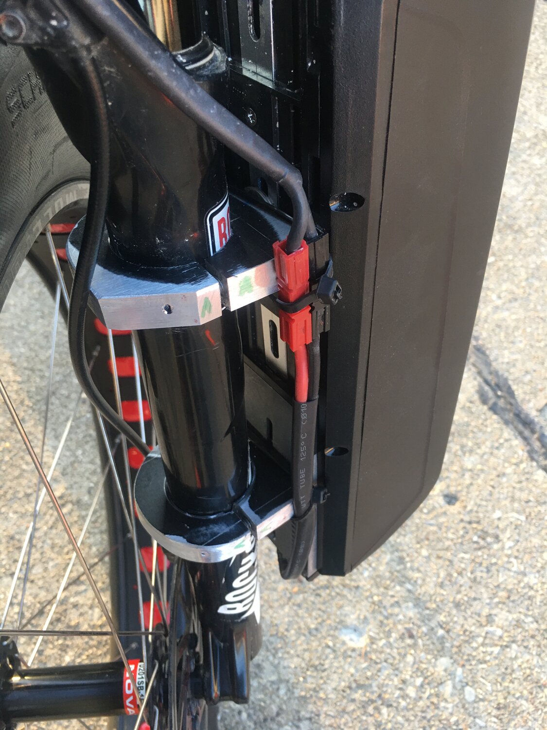

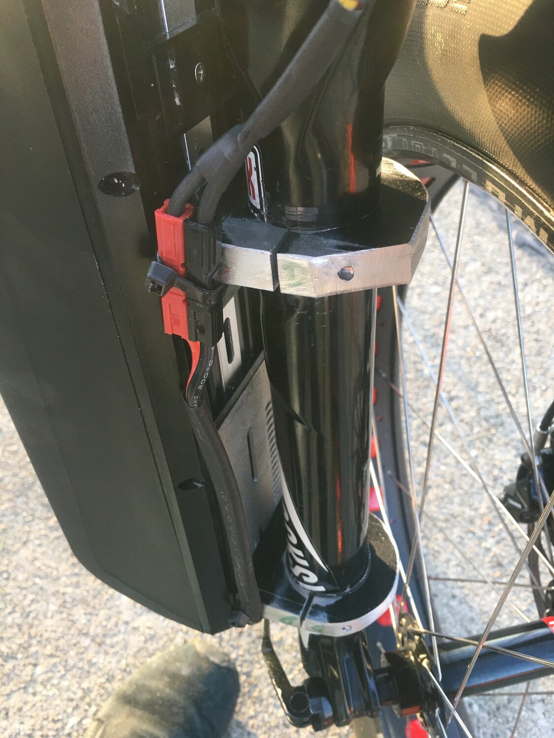

I like your battery setup on the front forks and have been thinking about that setup for my FS bike. My question is this . Is the terrain you are planning on traveling such that you really need 2 sets of tires? Why not simply use a single set that is somewhere in between those dimensions? Also could you show how have you secured the batteries to the fork? Here is a link to Marcparis' exploits for inspiration. You may have already found it but others watching this thread may not have. https://electricbikereview.com/forums/members/marcparis.26738/#recent-content

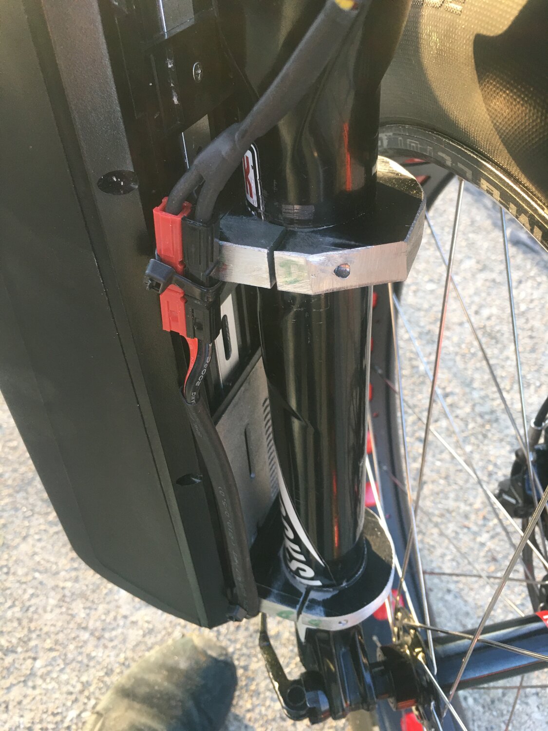

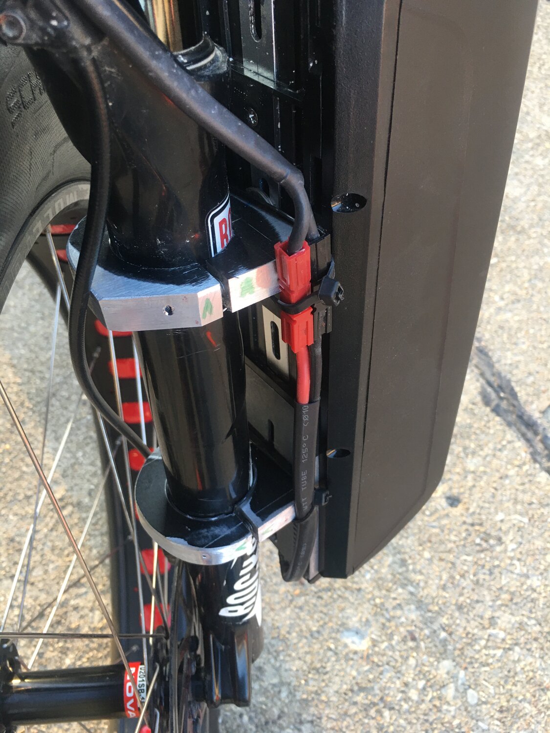

I just swapped things around on the battery mounts. I made a better set and rotated the batteries aft. The aft rotation made a world of difference in the bike handling. Aft rotation is shown here.

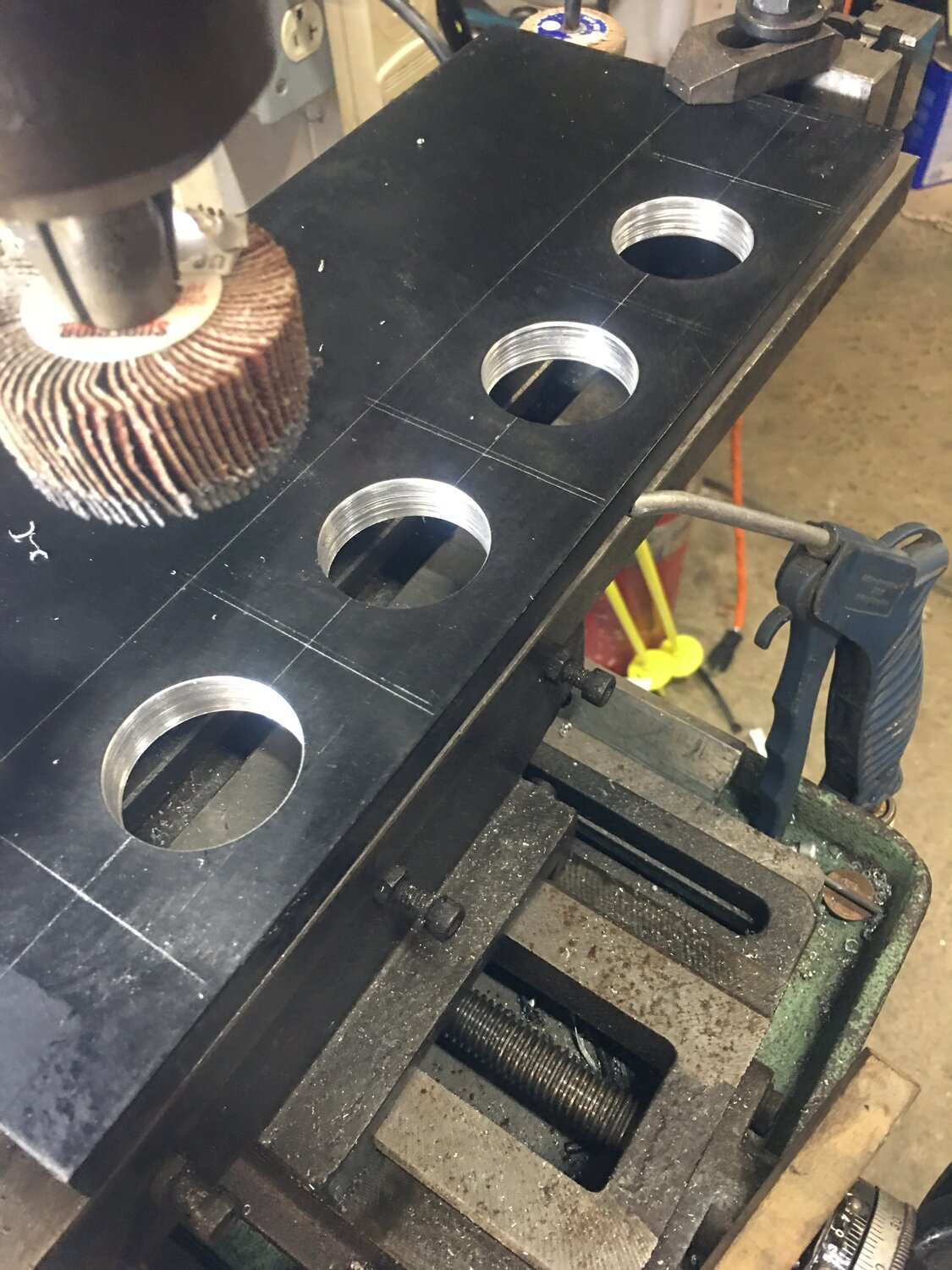

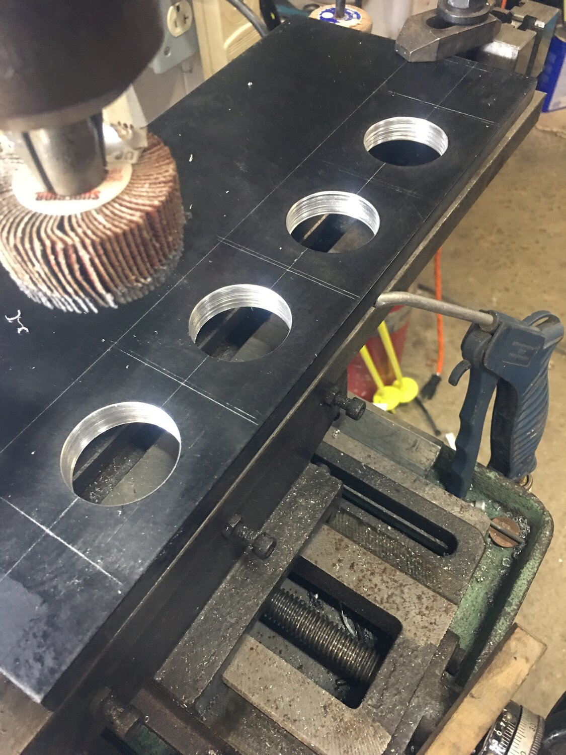

Now that I know that the changes work very well, I will take these off and put a professional look to them as well as cable mounts and cable wrapping. They are hand made out of 1/2" aluminum plate.
I just swapped things around on the battery mounts. I made a better set and rotated the batteries aft. The aft rotation made a world of difference in the bike handling. Aft rotation is shown here. View attachment 83015Now that I know that the changes work very well, I will take these off and put a professional look to them as well as cable mounts and cable wrapping. They are hand made out of 1/2" aluminum plate. View attachment 83017View attachment 83018View attachment 83019

Here is the pro touch on those battery fork mounts. The need another day or so to harden up the coating. In the mean time I will service the fork so I don't have to try to do it once the mounts are on there. IMG_1885.JPG
