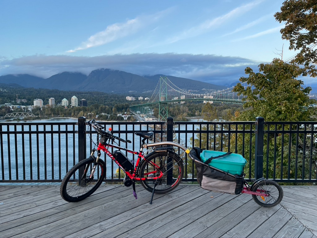

I have gone with a lighter setup that holds promise. Run a 750watt battery which can last me most of the day and carry a spare 750 for the second day if
no charging available.
With the Satiator charger from Grin Tech both batteries can be charged back up to 90 % at 8 amps fairly quickly if not doing an overnight charge.
E bike touring has many limitations but has lots of potential. I now carry very little load on my bike since getting the trailer.
I do single track with this trailer as it has a shock and barely feel the difference with the handling of my bike.

I guess they don't have any logs on your single track area? It would really tough to bunny hop that trailer! No sharp switchbacks or steep valleys to a stream at the bottom either I assume.
It has a quick connect coupling so it,s not really an issue for the odd logs I have encountered. Lifting loaded trailer much easier than lifting the unloaded bike but its
easy to unsnap battery and water to reduce the weight by another 10 lbs. or so.
I am not doing downhill and jumps with this rig if thats what you were thinking , mainly exploring
fire roads and trails and staying away from vehicles wherever I can for a quite peaceful adventure.
