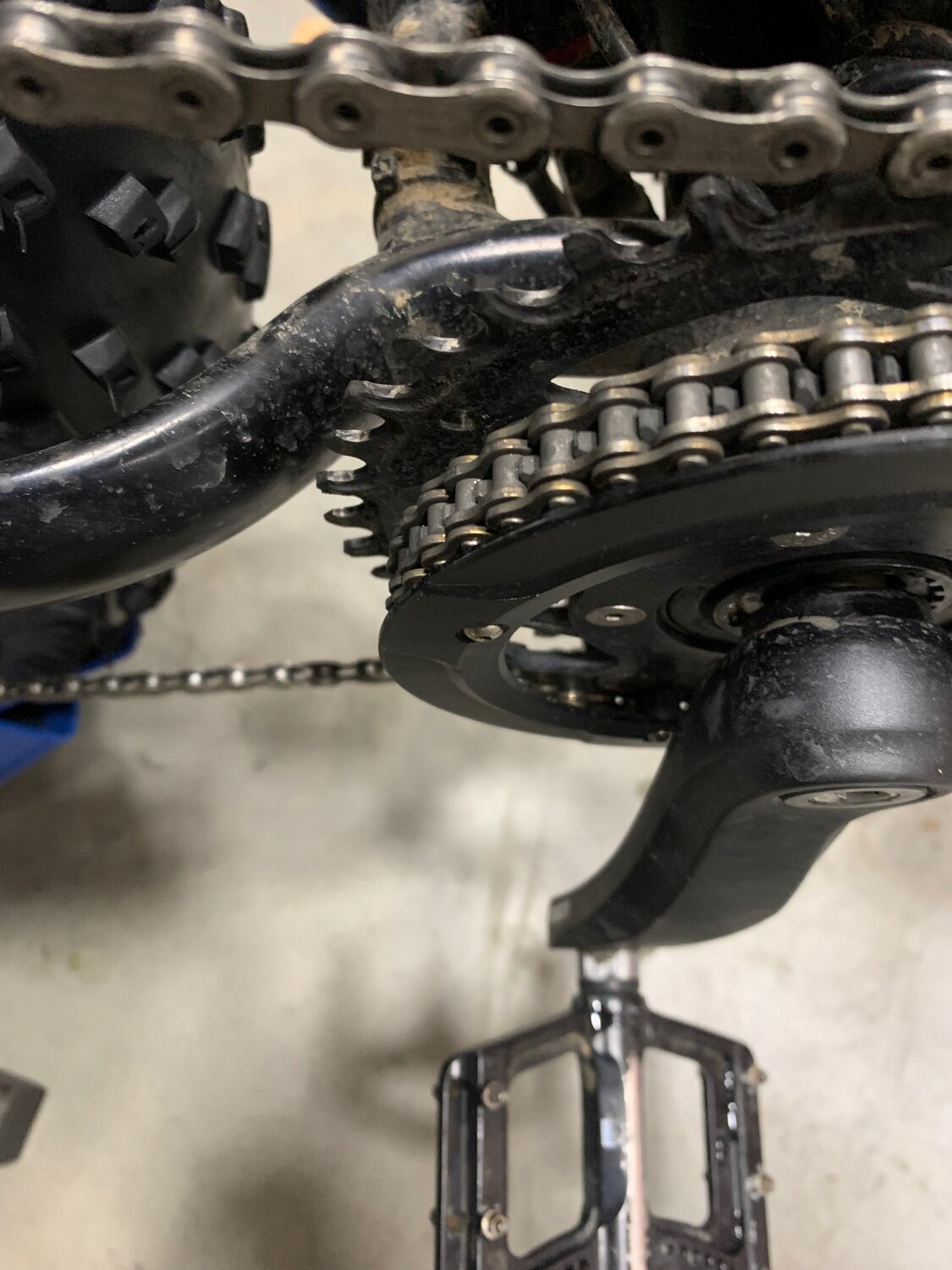

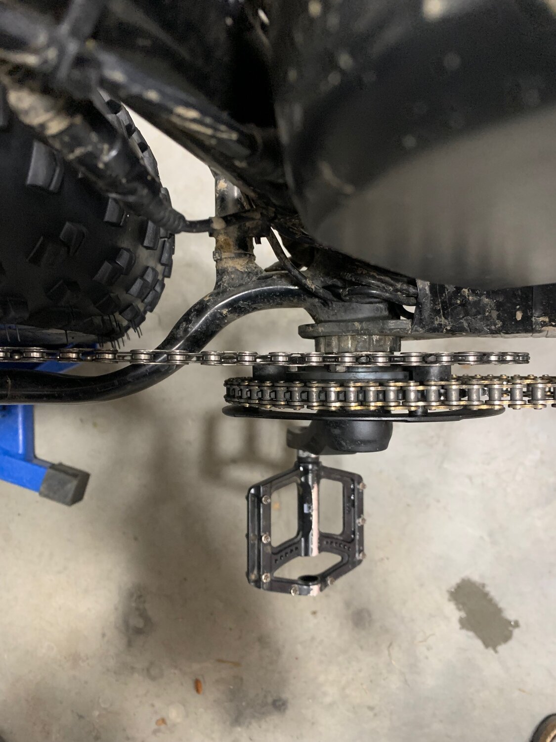

11/53 - 38 tooth
CYC has never officially offered this as an option, but after some thinking, I ended up swapping out parts to give it a try. And luckily for me it fit, but just barely. When you are considering a drivetrain, you have to figure out how much clearance you have between the chainrings and the chainstay of your frame. (The chainstay is the lower part of the frame that goes around the tire). I’ve attached a couple pics to show what the gearing combo looks like and how it interacts with the chainstay.
CYC offers a scaled printout on their website so you can mock it up on your bike to check for clearance.
https://www.cycmotor.com/x1-pro-gen-2
For me, this combination is perfect. I get the quick response of the 11/53 motor gearing, but with the 38 tooth bike chainring, I am still able to get to get up to ~50kph when I’m trying to commute and get somewhere quick. I’ll be sticking with this combination going forward as it offers the best of both worlds for me. I’m moving to a studded 5” rear tire (Terrene Johnny 5) and my chain with a 100mm BB is going to hit the tire. Next upgrade is to install a 120mm BB (with spacers for my 100mm frame) with CYC’s upgraded freewheel to give me some more clearance to the tire.
