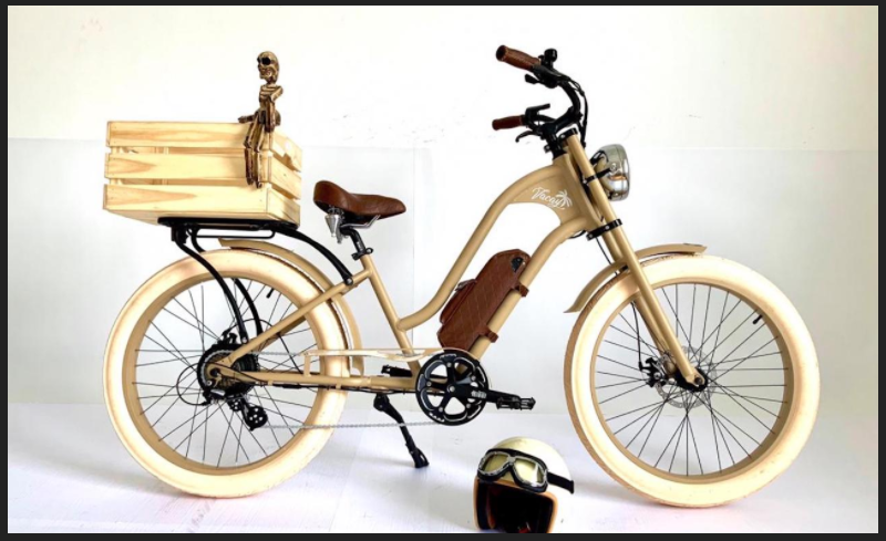

Thank you again for the suggestions for commuter bikes for my wife. She saw an advertisement for a local custom bike builder and likes what they are making. I am pretty sure that these are assembled from off the shelf parts and not custom frames.
What should I think about when considering a "custom" bike? Any questions I should ask?
Here are the specs they list for the bike, if it is useful.
  • Fat Cruiser femme 26'' Electric Assistance EN15194 Approved
  • Aluminium frame
  • 250w fatbike rear engine, weatherproof controller
  • 360 Wh Samsung cells Li-ion battery, LCD/USB screen
  • 5 levels of assistance. Front battery back lighting
  • 7 speeds Shimano Altus. Rapid Fire Commands
  • Tektro disc brakes. Fat tires 4.0. Aluminum rims
  • Sludge guards and luggage rack included
Thank you for the help.

Is it this model? Seems expensive for what you get. I'd recommend she take a test ride over the route as fat tire bikes are heavier and the tires are loud on paved surfaces. Those tiny fenders/mudguards won't keep rain off her. The moped headlight probably isn't StVZO compliant. IMO a better choice if she must have fat tires is the RadRhino Step Thru 1 which is 1200 Euro's less but uses the same Bafang 250w fat tire motor, and is available to import to Switzerland from their distributor in Utrecht, Netherlands.

It's likely this is a Chinese white label ebike meaning a generic frame that can be rebranded by anyone. At least the Bafang fat tire hub motor is a standard part that can use any battery of the same voltage. Bon Chance
A quality battery is important. Samsung cells are good. Sounds like a 36V 10AH battery, which is considered tiny by today's standards. Probably only has 40 cells. For that kind of money, it ought to be 12AH, and they can easily put that into the same package.
The fenders are useless. Ride thru a puddle on a glorious summer day and the lady will have a muddy skunk trail down her back.

4" tires with a pavement tread are as quiet as any of the smaller tires. Noise is created by the knobby style tires, and then, the faster you go the more noise they make. If there's an issue with the pavement tread, it's self steering. Or at least that was my experience. It's like over steer, only more unpredictable. Happens on irregular surfaces or when the bike is leaned into a corner. I don't think it's anything that might lead to a crash. It's more of an uncertain feeling. I was able to dial most of it out playing with tire pressure, ending up in the high teens (making the tires pretty stiff). I ended up switching to 26x3" Kenda Flame tires and that eliminated the issue. They've been great for my on/off road "hybrid" use.

Still a nice looking bike. If they are custom they can find bigger battery and longer fenders.

Oh yeah, that always works well. LOL When the fender radius doesn't match the tire, it's hard to call it a custom build. If it's found on another site, it's a stock Chinese bike with maybe the custom leather cover on the battery.
I find it very attractive. Maybe a new seat, add on rack, and a custom paint job on a mainstream bike? One with full fenders? Take a picture of another bike to an automotive paint shop and see what they would want to match these colors.
I think you can get 350 W hub motors in Switzerland, if there is any chance of climbing a hill.

In line with the happy wife, happy life theme, I do understand the aesthetics issue but at its heart the bike is a machine that can delight or disappoint long after the initial 'new and shiney' attraction has worn off. Aside from odd fenders and a low battery capacity there are a few other considerations where this bike might disappoint.
The brakes appear to be mechanical disc brakes, rather than hydraulic. These will work about as well as a good set of rim brakes but the higher weight of the ebike will, IMO, make the brakes seem inadequate. They also require more periodic adjustment to keep them performing. I'd strongly recommend brand name hydraulic brakes for their self-adjusting feature and better stopping power.
Lighting is an issue everyone on abike should seriously consider, even if you don't plan on riding at night. Daylight running lights should be the minimum esp if commuting is being considered. Cars have a difficult time seeing bikes, esp when there are shadows or dim winter lighting. This puts the cyclist at risk. Lighting is one of the most effective ways to get a motorist's attention. I can't say if the included retro style headlight is useful for this, but it really should be. A headlight with a flashing mode is particularly good for daylight use. As a minimum there should also be a bright tail light.
The rack seems generic, perhaps even dedicated to the cargo box? A more flexible rack will in time be the best choice. Racktime and Topeak both make racks that accept their wide selections of bags and accessories that are easily removable. My wife particularly likes the Racktime Agnetha Bag for trips to the market esp since it can be carried as a shopping bag.
As a final point I'd be concerned with the long term serviceability of an ebike from a small builder, unless you're interested in doing this work or have a LBS that will take this on. Everything from flat tire repair to chain maintenance and brake pad replacement will be needed on a routine basis. Eventually battery, controller, and motor issues will arise. A brand name bike can keep these issues at the dealer.
So what to do? Perhaps with these issues in mind, and others posted earlier, your wife might be convinced to look at alternative ebikes. There are quite a few quality options available but one my wife liked is the Specialized Como 3 step through. I get that it costs more, but it hit all the buttons for my wife. I liked it for the effective running lights, hydraulic brakes, functional fenders, larger battery, flexible rack system, and the support avaialble from the local dealer.
